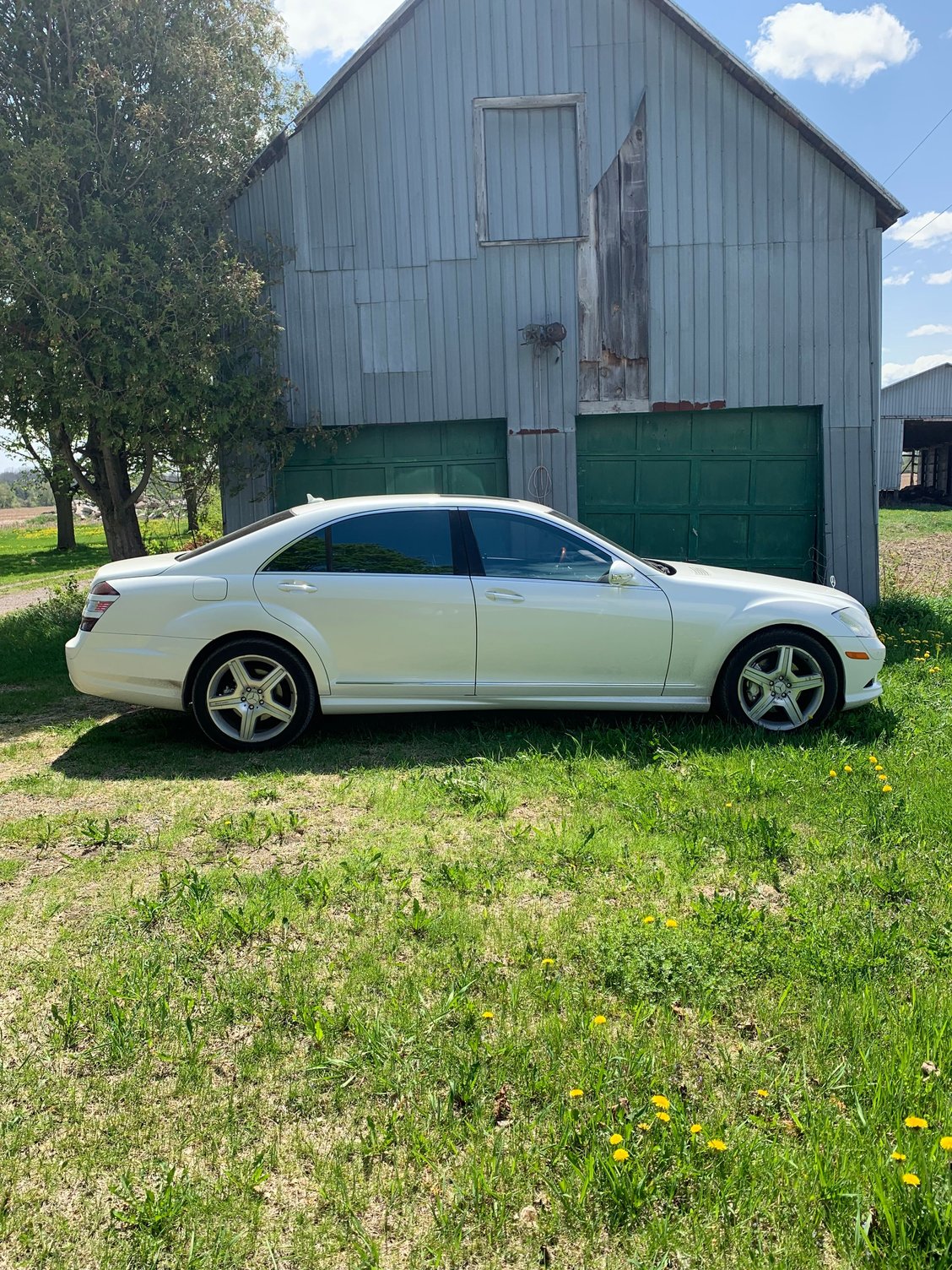

I finally pulled the trigger on a 2009 S550 4Matic with 155K KMS (<100K miles) I bought it sight unseen although I did have it independently inspected. I gotta say, so far so good. The only corrosion so far is the brake dust shields. Came with a fresh synthetic oil change so I'll let that go for now. I just did the transmission service and the old oil had no smell and there was very little on the magnets. I used a Chapin garden sprayer and an adapter and it worked great!
While under the car I had a look around and was happy to fine one new Arnott strut(front right). I ordered the other side and will install once received. There is a clunk coming from the front end but I found no loose ball joints. The bushing on the lower forward control arm (RH) is shot. Think I'll just replace the arm as i do not have a press. I am hoping the clunk is coming from the dampening bits in the LH strut...we'll see.
Driveshaft donuts look fine. And I LOVE good stainless exhausts. Brake pads are newish. Tires are newish but not the greatest quality. I'll keep them for now.
Stereo does not work. I have the amp out and will send it for repair or exchange. Looking forward to having that sound system working. Must be awesome.
I am not pushing the car yet but I do like that acceleration. Comes with a cost no doubt. I am not expecting great fuel economy!
Will check engine mounts shortly.
I am going the BenzNinja route for tech support.
Will continue looking around and doing some preventative maintenance!

"There is a clunk coming from the front end but I found no loose ball joints."
While you change the forward lower control arm you will be able to inspect the rearward arm ball joint, which most likely is the source for your "clunk". These joints cannot be inspected by hand force without taking one of the three ball joints loose. The one that basically needs to be loosened first is the upper wish bone control arm joint and when you take it lose you will see how the whole hub rotates when you slowly lower it down with a jack. After it stops rotation the forces in the joints are relieved and you can inspect them.

Thanks for that. The boots are torn on both bottom joints so I may just go ahead and replace those control arms as well.
