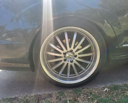

have an 08 s550 (obviously)
hose snapped during fog light repair ,im assuming age of line.
after it was fixed im still getting the car up arrow , car raises and lowers.
i notced roght side looks lower, tested with fingers and def 1 less finger height on passenger rear tire not as bad at passenger front.
what are the chances of either a shock or level sensor going out at same time?
also is there a definite way to tell if a shock is bad or leaking?
parts arent bad for either but i wont want to just throw parts at it.
would a true mb star diag be the only way to know for sure??
\thanks in advance

ok sounds good so once the front is up it should get even lower?
pass rear
side
after raising car

there's at least another 2" to do down before this is bottomed...

so is this most likely the level sensor between the dropping and the sound?
