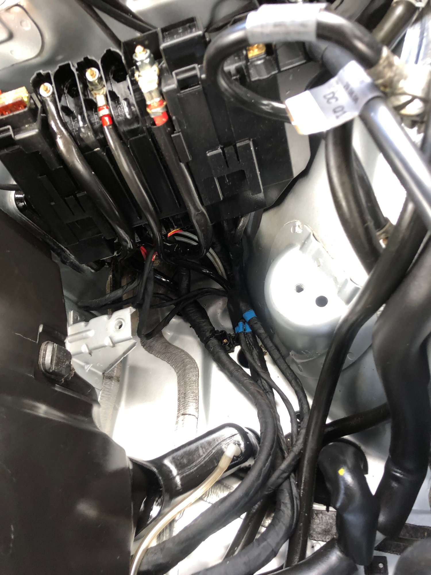

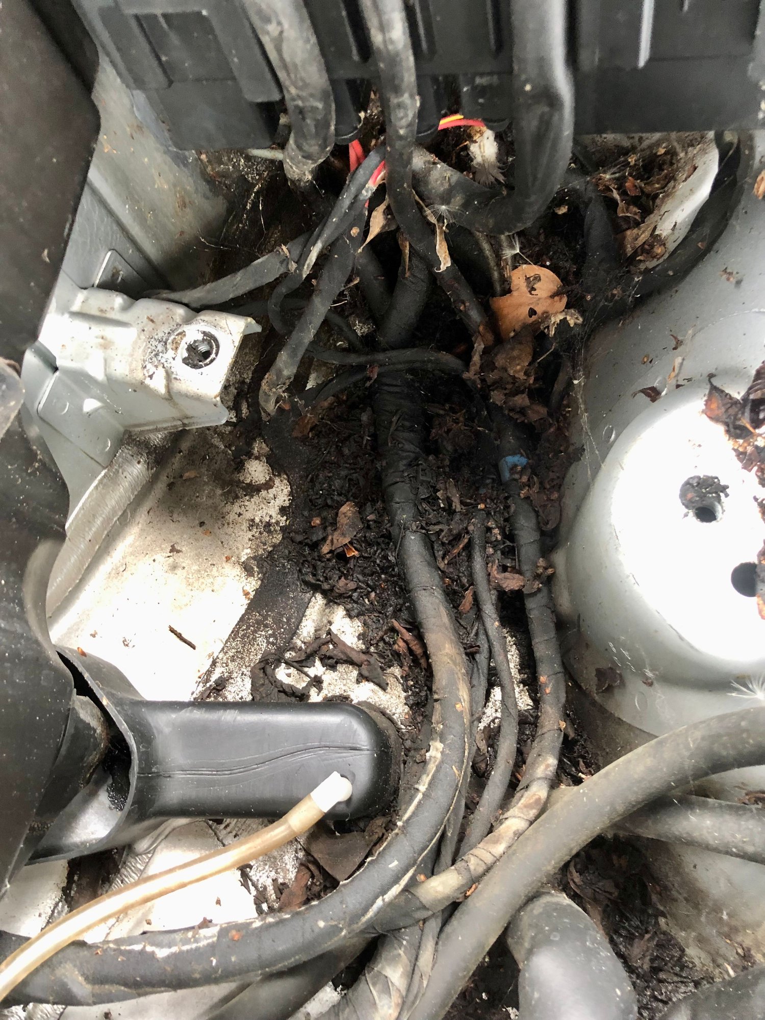

when I swapped the starter battery the big black mounting plate stops you reaching and clearing out leaf litter, and then as it was winter it was all frozen anyway. I finally got off my **** and pulled it out and had a clean up yesterday - here all the leaf litter and crud on the left side that should not be able to get to this location but does coz the screen drains don't builds up unseen.... (my pictures are the left - battery side on UK cars - note this is what eventually makes the interior heater fan die as the water eventually rots through stuff and water seeping in destroys things)...
battery out, mounting plate out and you can see what's going on (now I know you have to wriggle that black bit of electrical detritus off the battery holder and move behind to reach all the filth - disconnect the rear battery for good measure)
late summer spring clean

Oh my gosh...I guess I know what I'll be doing this weekend.

I cleaned mine out yesterday. What a rat's nest! I continue to wonder how my car was not a fish tank, before I cleaned out all the various ports. @BOTUS , do you have any more ideas for easily neglected things to address w/ a 15 year old car?
