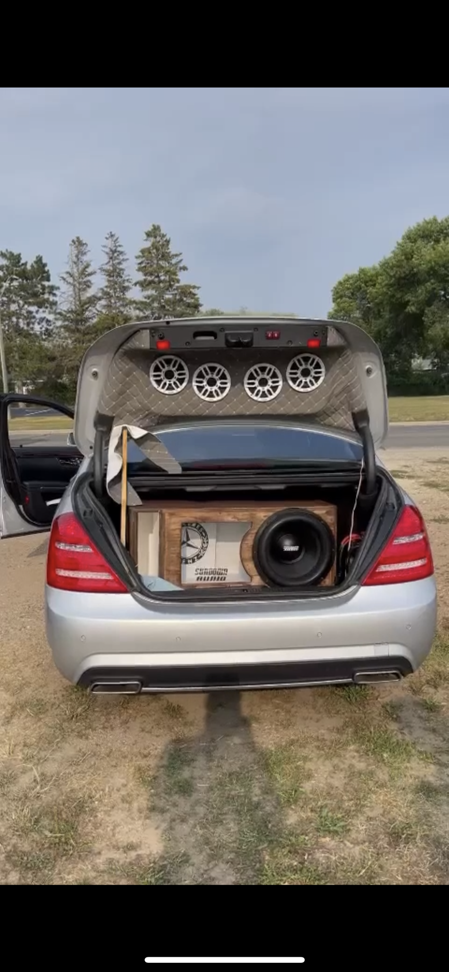

So far I have everything inside the trunk for over a year but I wanna go bigger, so far I got a 12” sub 2000watts rms hooked up to a 2300 watts amp and i installed a second battery in the trunk and it’s doing good so far but i need more power bc I wanna go bigger. A friend told me about a company called
mechman he said they make good stuff but I don’t wanna install a high output alternator and then I burn everything up bc I didn’t program it or something.

I will, but I also know that from the dashboard if u click and hold the ok and answer phone button with the dash being in the trip odometer reset I believe u call it, if u hold both for like 5sec it’ll take u to the vehicle data and from there I saw it shows the voltage on there and while running, it shows a constant 14volts but I still wanna know what amp alternator I got so that’s first thing. either 180amp or 220amp alternator if it’s the 180 then I can go 220 but if not then I gotta go night then 220
Currently have this in my trunk
