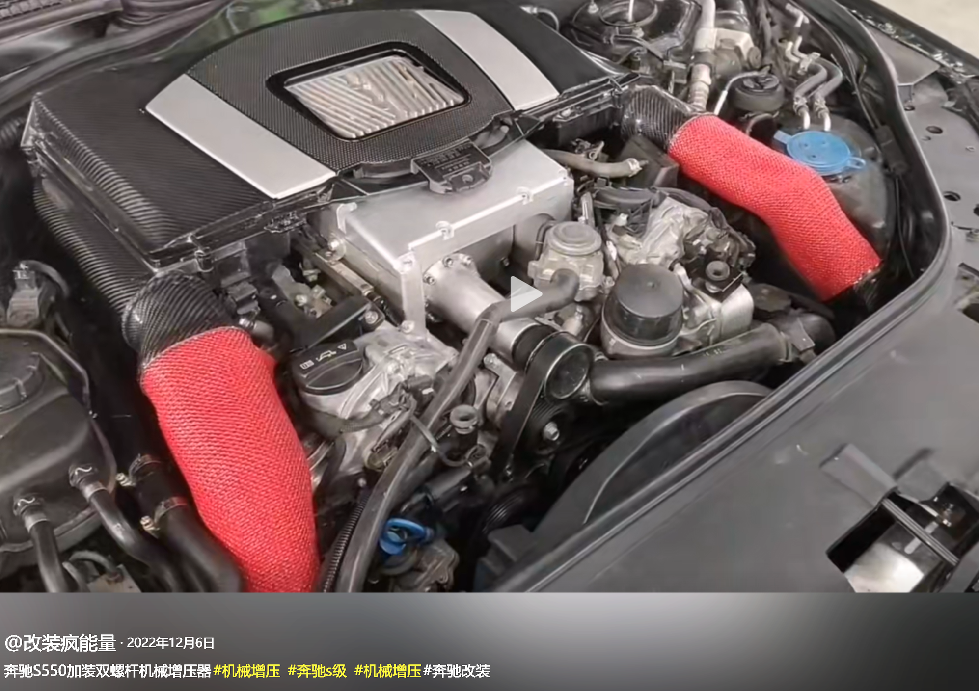

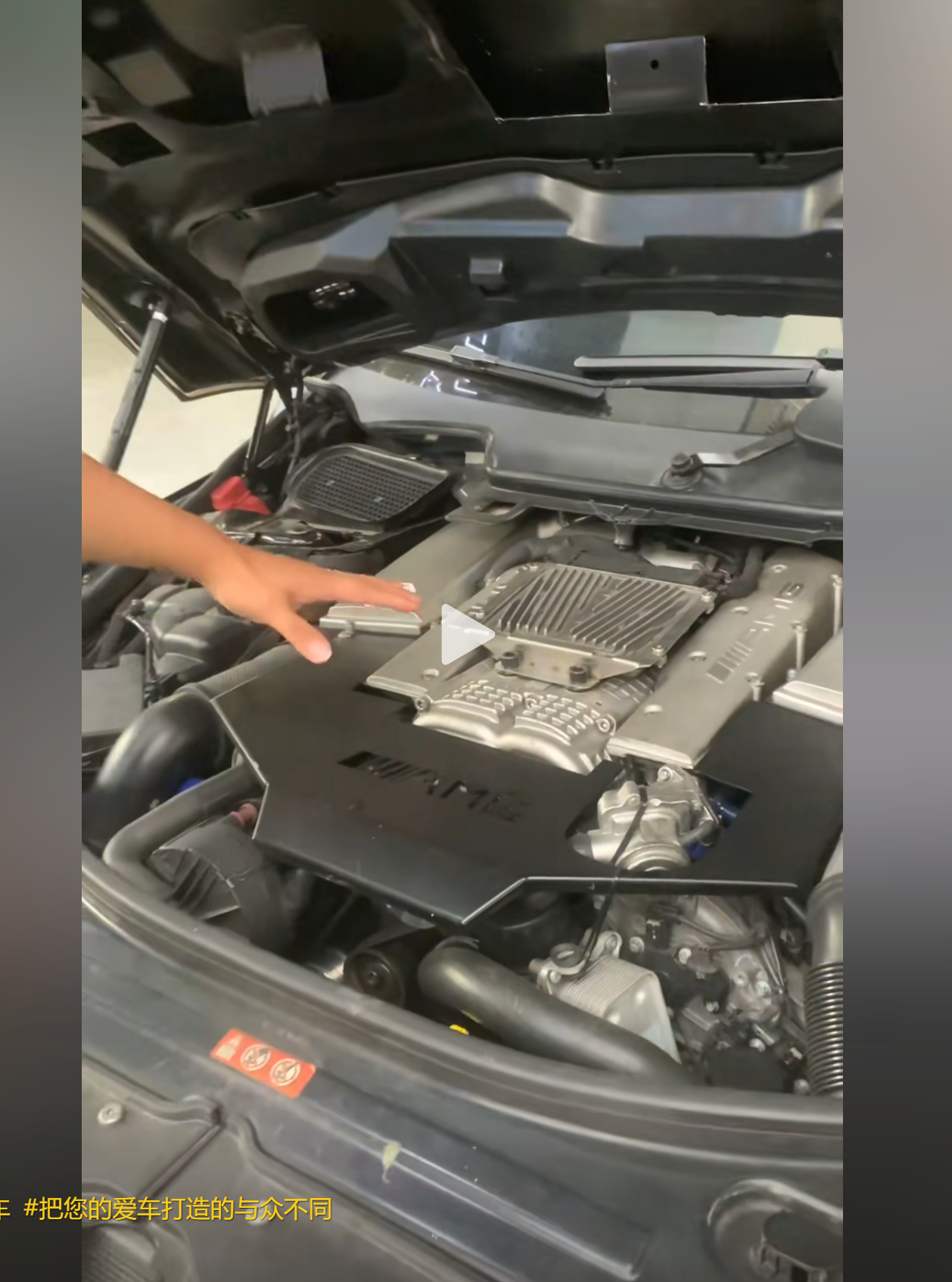

Hi, I'm a W221 S500L owner from China and I'm also planning to supercharge my car. I read about the Kleemann supercharger but I don't think it has ever been put into production. Then one day when I was going through a shopping website, I found that there are performance shops here that have successfully built superchargers for the M273 V8, and even the M272 V6, which is reverse engineered from the Kleemann supercharger that was originally made for the M113 engine. And I found a post of a V6 variant of these getting installed on a pre-facelift GLK300 with 3.0L M272 V6, the power gain is quite significant, from 126HP and 170nm to the wheels when stock, to 203HP and 269nm to the wheels when this supercharger kit is installed. Considering it's only a 3L V6 and the car it's AWD, I'd say that a pretty good power gain. I can imagine the numbers to be a lot higher on a RWD 5.5L V8. Anyway, here's a photo of my car and some photos of the supercharger installed on a M272 3L V6.

Very nice @Michael_Lin . Do you have any more details or a link?

I'm afraid not. I'm also trying to find more details about it. I will do more researches on Chinese MB forums and ask if anyone installed the V8 version of it. If this kit is proven to be reliable, I may consider trying it on my car and help export it to the US.

Yes I found more info online
Originally Posted by wilkyyyy
Any update on this? Have you found the company that produces this kit?
I have found more info on Chinese video platform, there's a shop that has put the supercharger on a W221 S550L, and the shop claims that the car now makes 500+hp and 700nm at the crank, and they showed videos of the car be tested on dyno, they said the car is not running on high boost because the stock transmission can only handle 700nm. I have also found videos of the same shop putting superchargers on many S300L and S350L, so I think the superchargers that they are using should be well developed and safe for the engines. And I found video from another shop putting the supercharger from M113K to a R500 with M273, they didn't give any number but they said the boost is 0.5bar and it's safe to boost it higher. I would definitely consider installing one on my S500L, but both shops are over 1000kms away, so that would be a plan for the future.
