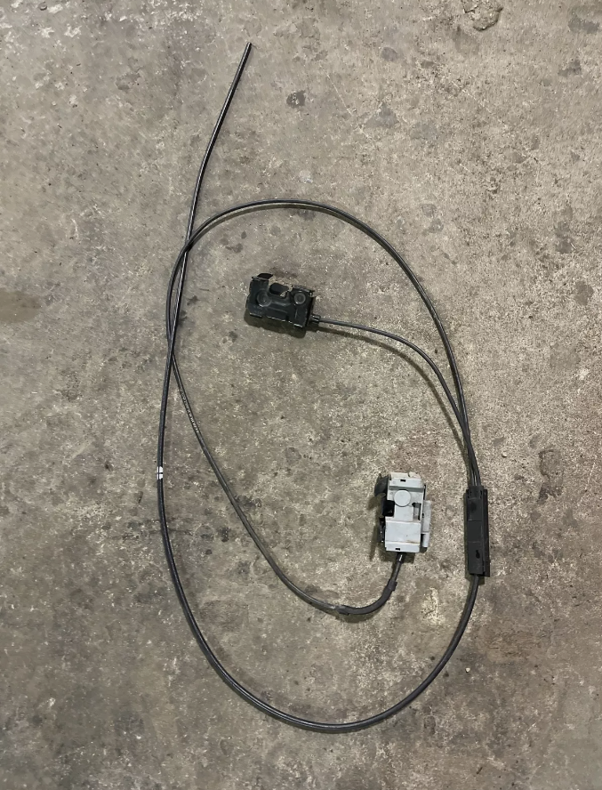

I did some searching for photos of the latches. On my car and what im finding online the passenger side lock has an additional cover that houses the sensor to check if the hood is down, that lock looks harder to pop open. The drivers side looks like its easier, try and use a long screwdriver and push the latch from the bottom or side.
the passenger side looks like there is a small opening in the bottom front corner, may be able to stick something in there and try and push the latch.
Photo shows the drivers lock on the shorter cable, longer cable is the passenger side with cover on it.
Heres just the lock on the drivers side. Push the latch in the direction of the arrow. Blue represents the cable.
Passenger side with cover. Maybe fish something thru the small opening to push the latch.
