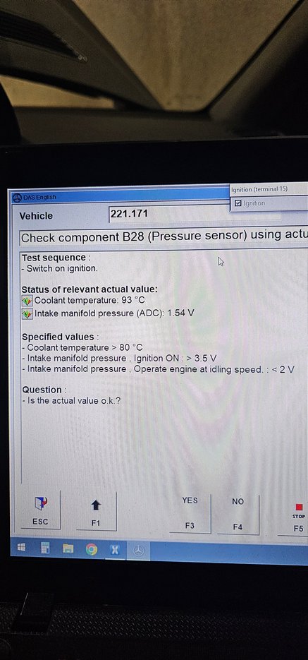

My fault! Ignition needs to be ON and then the temps are ok! Sorry about that...What about these values

is this a wind up ?
the ignition switch pop up is the simulation (practice) version ?

Old Dec 1, 2024 | 03:37 PM
BOTUS's Avatar
Joined: Aug 2014
Posts: 5,322
Likes: 1,678
S500
in your pictures at the top middle - it shows how to turn on and off the ignition key with a tick box - that how you play when in the learning version of the toy
open Xentry not Xentry simulation and you have a chance to diagnose the car not play games
