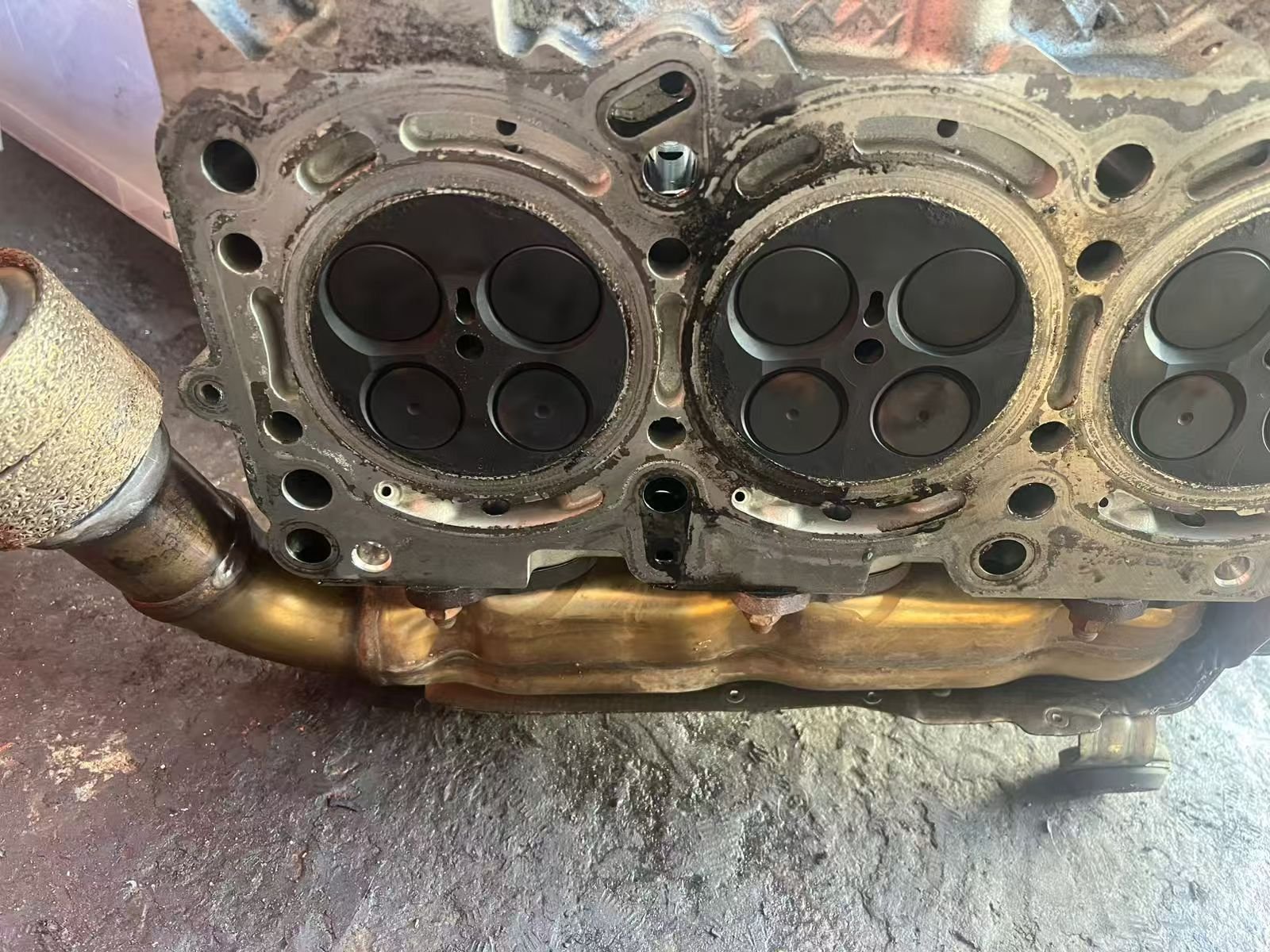

Engine Seized. Please help
This is what the garage has sent me claiming the engine has failed completely on its own and has had nothing to do with them.
This is an OM642 engine with 120K miles on the clock. The car itself is a 2010 plate Mercedes s class W221 facelift
Here is a timeline of what’s happened.
1. We sent the car off for an oil cooler replacement due to a major oil leak. (Garage confirmed it was safe to drive and the level of oil at the time of inspection was good)
2. Garage replaced the cooler, and took the car out for an extended test drive during which the engine came to a complete halt on the motorway with no prior warnings and no signs on the dash.
Garage claims that the car had run for 40 minutes before the engine became seized. Total distance of the test drive should be around 8 miles at best.
Garage is blaming on the soot and sludge buildup and the ‘lack of maintenance’.
The last oil change was done slightly over 1 year ago but the car was practically never driven in between apart from someone starting it up from time to time.
Can anyone please shed some light on whose fault it is and what’s happened with the engine in the photos?
Thanks!

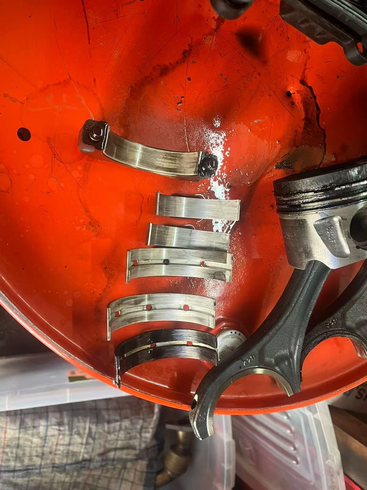

you can see the piston in one of your photos has smeared down the bore - as that seized slowly, it puts massive stress into the big end bearings you show that are also trashed

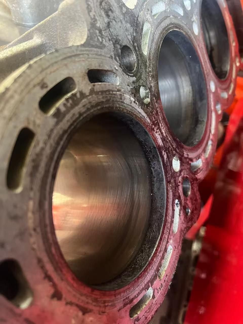

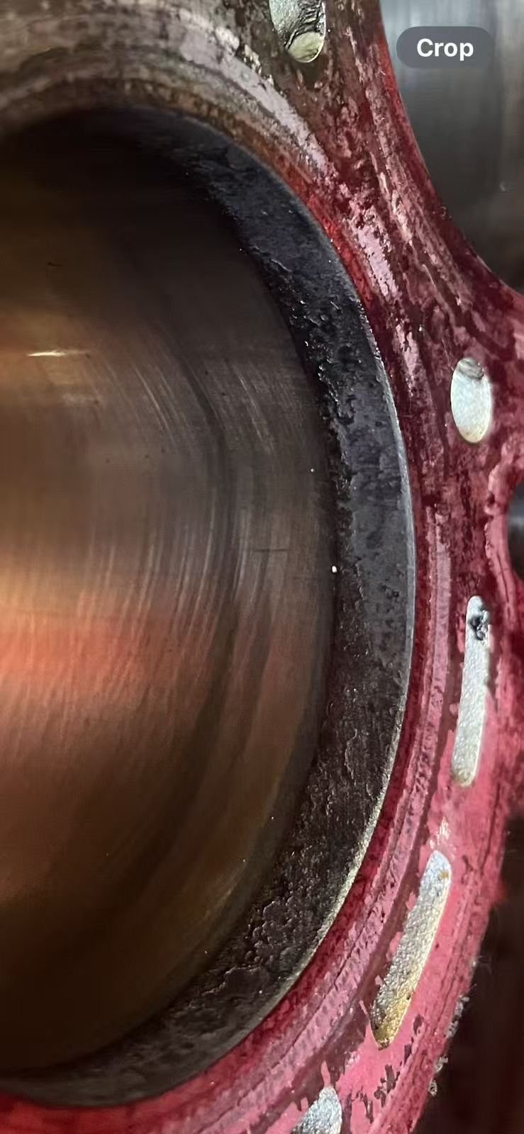

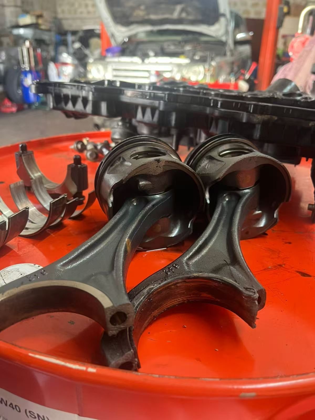

check this out - it shows alongside the pic we have of the cylinder bores - that the bore and most of the piston is in great shape (although it needs a pic with it turned 90 degrees to see the area of the piston that actually matters) - it suggest the wear one would expect with time and normal use is not there at all
what I see is massive localised heating of the top of the piston around its rings - this is the piston crown getting too hot because the rings haven't thrown the heat away - that is why my first post says nasty fuel - it make the rings stick and causes the problem in this photo
or they threw petrol in it and had some fun

OP it looks as though a connecting rod bearing spun and seized. Pistons look very angry.
This speaks of insufficient lubrication. Low quality oil, perhaps someone added snake oil to the lubricant at regular intervals?
The deposits on pistons and rings don’t just happen. They are the result of years of poor fuel quality and lack of basic maintenance.
Too often an oil leak isn’t discovered until the oil level dropped low enough for damage to bearings.

the top of the piston doesn't really get lube - the rings leave the merest hint of lube above them - and that will be there no matter what unless the sump is empty - and on a tractor the fuel is oil giving another source of lube - gummed rings can drive the lack of heat transfer - which I think drove exceptional piston temps - maybe the security boys took it for joy rides and mistakenly topped it up with petrol
my guess is the bottom end gave up when the seizure of the pistons broke down the tiny oil film keeping the big ends safe and it all ends in tears
