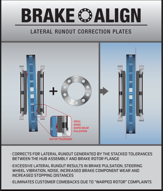

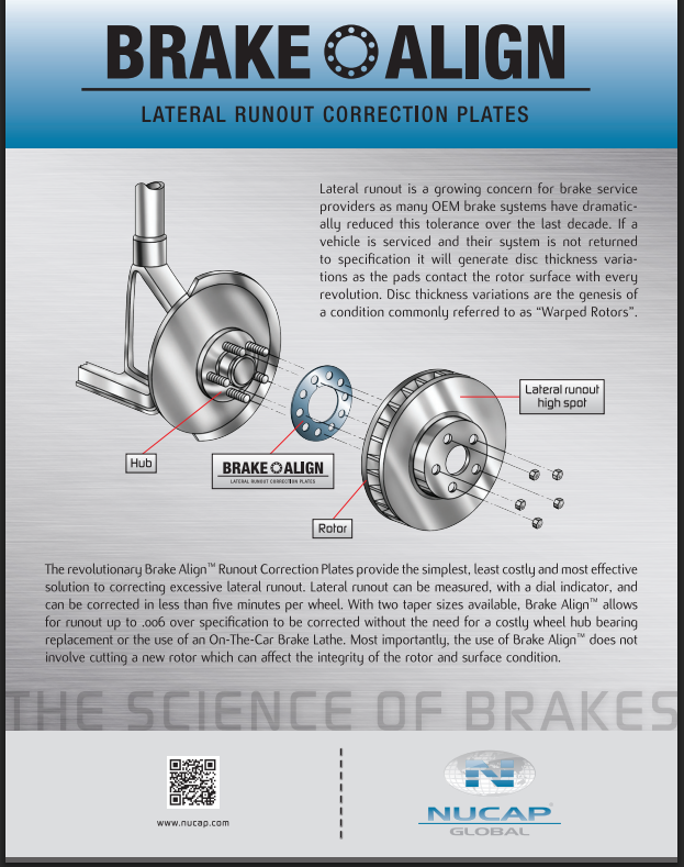

Here's more information that explains the concept:
https://nucap.com/wp-content/uploads...ke_align_s.pdf
It seems these correction shims never got popular and that they are now impossible to find?
