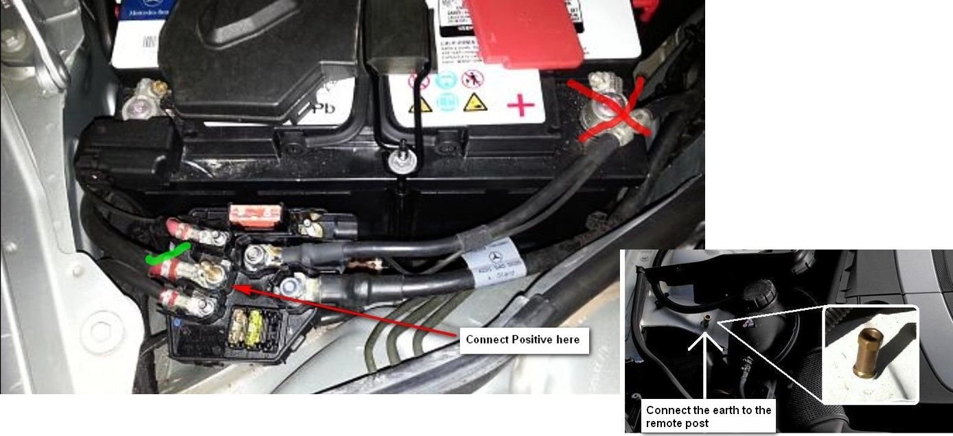

don't forget the positive also goes on a post ina terminal box and not direct on the battery.... most modern cars work this way - it gives a better clue as to the load the cars is taking

I didn't know that positive (RED) terminal was also supposed to be connected somewhere else (i.e. not directly to the battery). Can you please point out where the red positive on my car (W221) should be plugged to when charging?

re battery - it should look like the picture above, the cover pops off ?
part 030 Genuine MERCEDES C216 W221 S-CLASS W221 Regulator Switch 0041540706 £141.19 from a main dealer - struggling to find Bosch direct part
