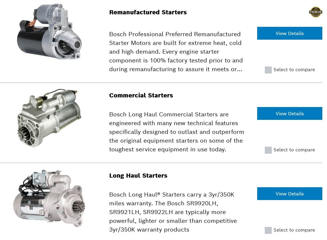

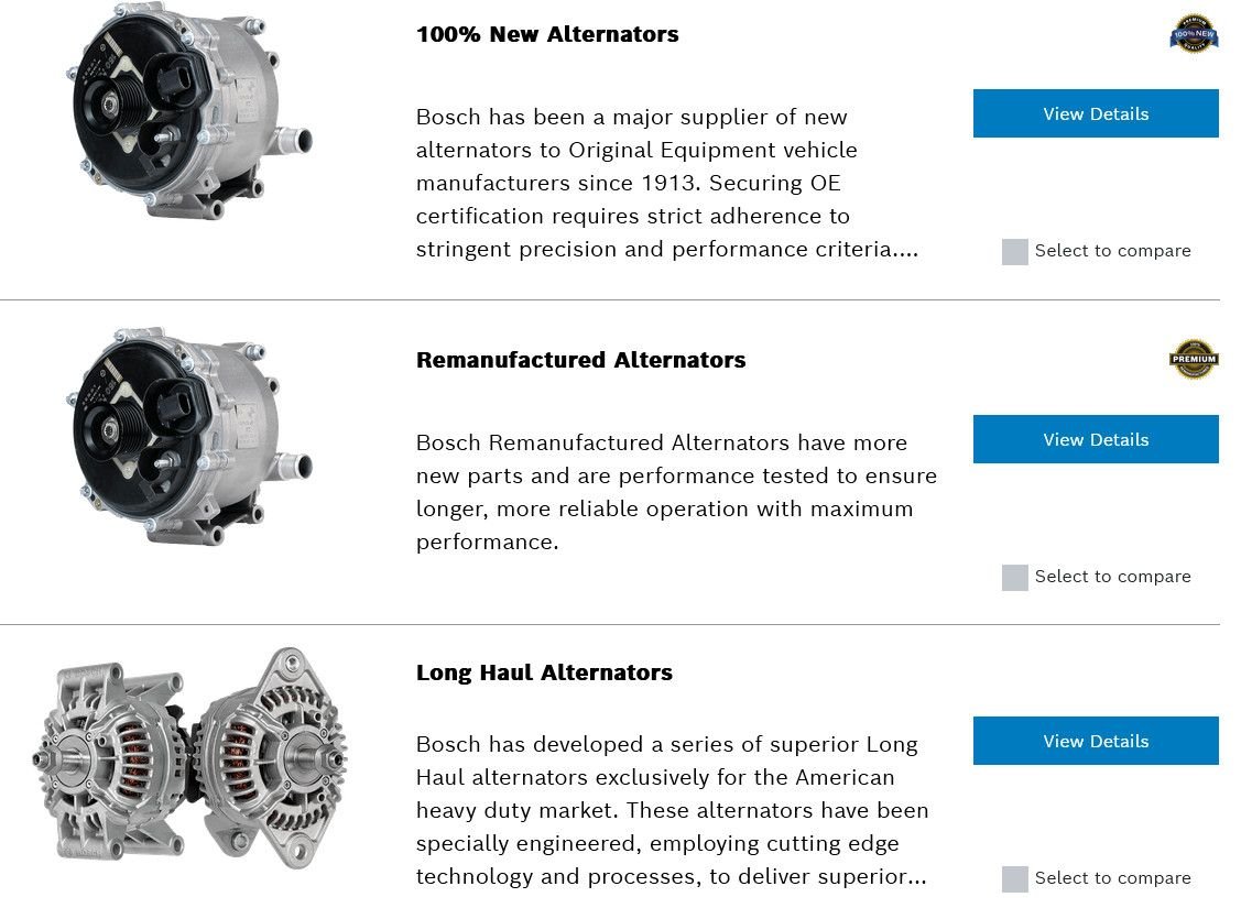

Originally Posted by streborx
Interesting that nobody is rebuilding them like alternators, starters and other components are rebuilt.
Bosch do - they have new or their secondhand https://www.boschautoparts.com/g/sta...nd-alternators
also check the novel name for the secret designed not to fail version at the bottom of each list
Yes, this is what I meant -- starters and alternators are rebuilt because it's economically viable. I suspect TPMS sensors are not rebuilt because the rebuild cost exceeds the cost of a new one.
