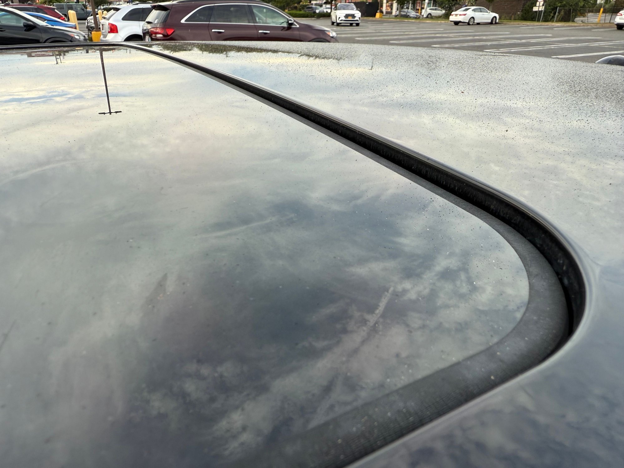

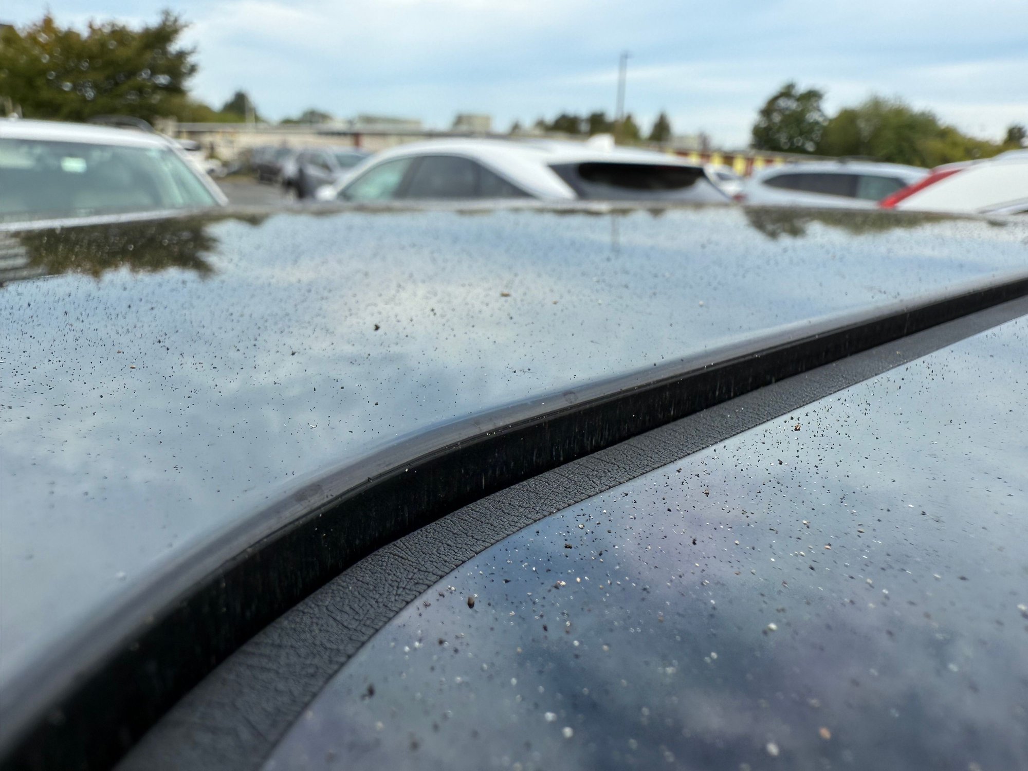

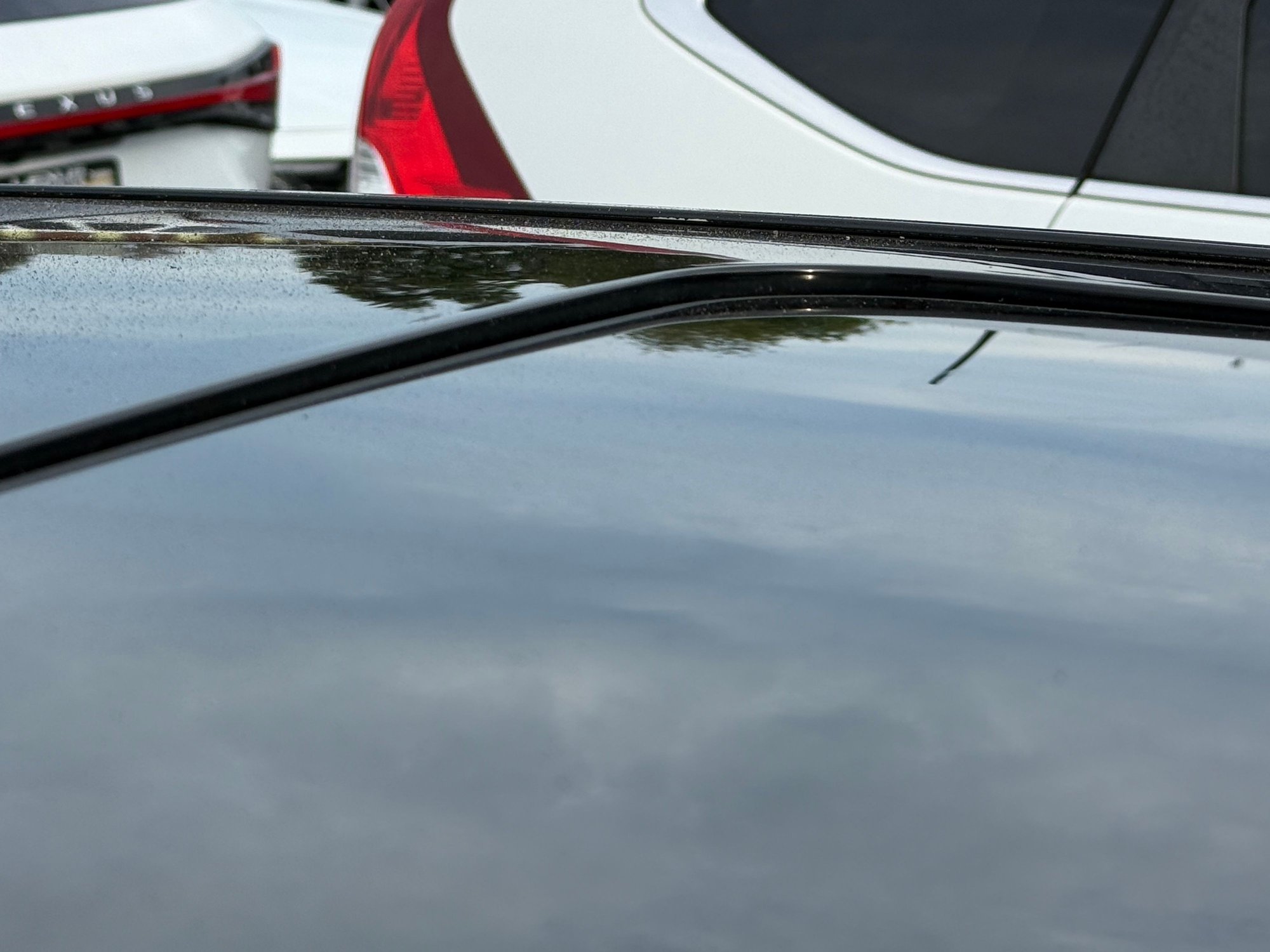

Hey guys,
Just picked up a 2008 S63 AMG with a standard sunroof (non-panoramic).
It all functions normally, however when in fully closed position the rear sinks in. I can correct it by manually raising the tilt slightly, so that it sits flush with the roof, but I do not want to continue relying on this method and want to resolve the issue.
I attempted to search this forum and google for some answers before making this post, however most of the results were for panoramic roof issues.
Any ideas? Anyone with similar past experience?
