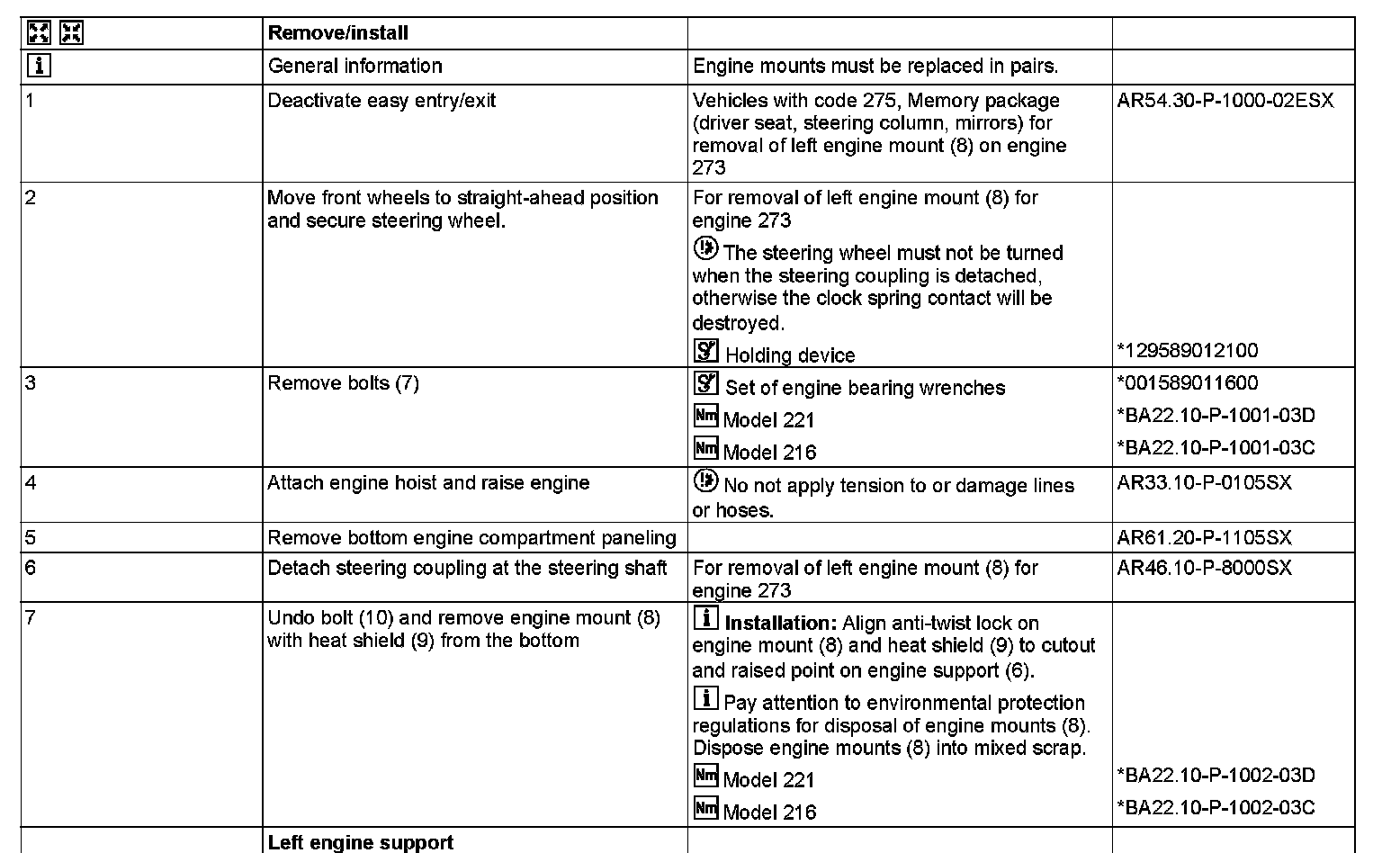

Heres the "AR22.10-P-1260MMB Remove/Install Front Engine Mounts and/or Engine Support" that can be found online: https://charm.li/Mercedes%20Benz/201...ine%20Support/
Seems on RWD they want you fiddling with the AC evacuating it, remove steering coupler, and remove the front axle carrier. Same with 4matic and removing the axle carrier.

Seems the extent of the work is based on which engine and RWD vs 4matic.
I was browsing thru the 2010 S550 manuals and on the RWD M273 they say just raise the engine and the mounts will come out. Plus detach steering for Left mount.
Was looking here if interested: https://charm.li/Mercedes%20Benz/201...ngine%20Mount/
For M273 there are plenty instructions for the mounts. The biggest issue with those is to get to remove the top bolt that screws vertically in the mount. You need to get special wrench for it.
