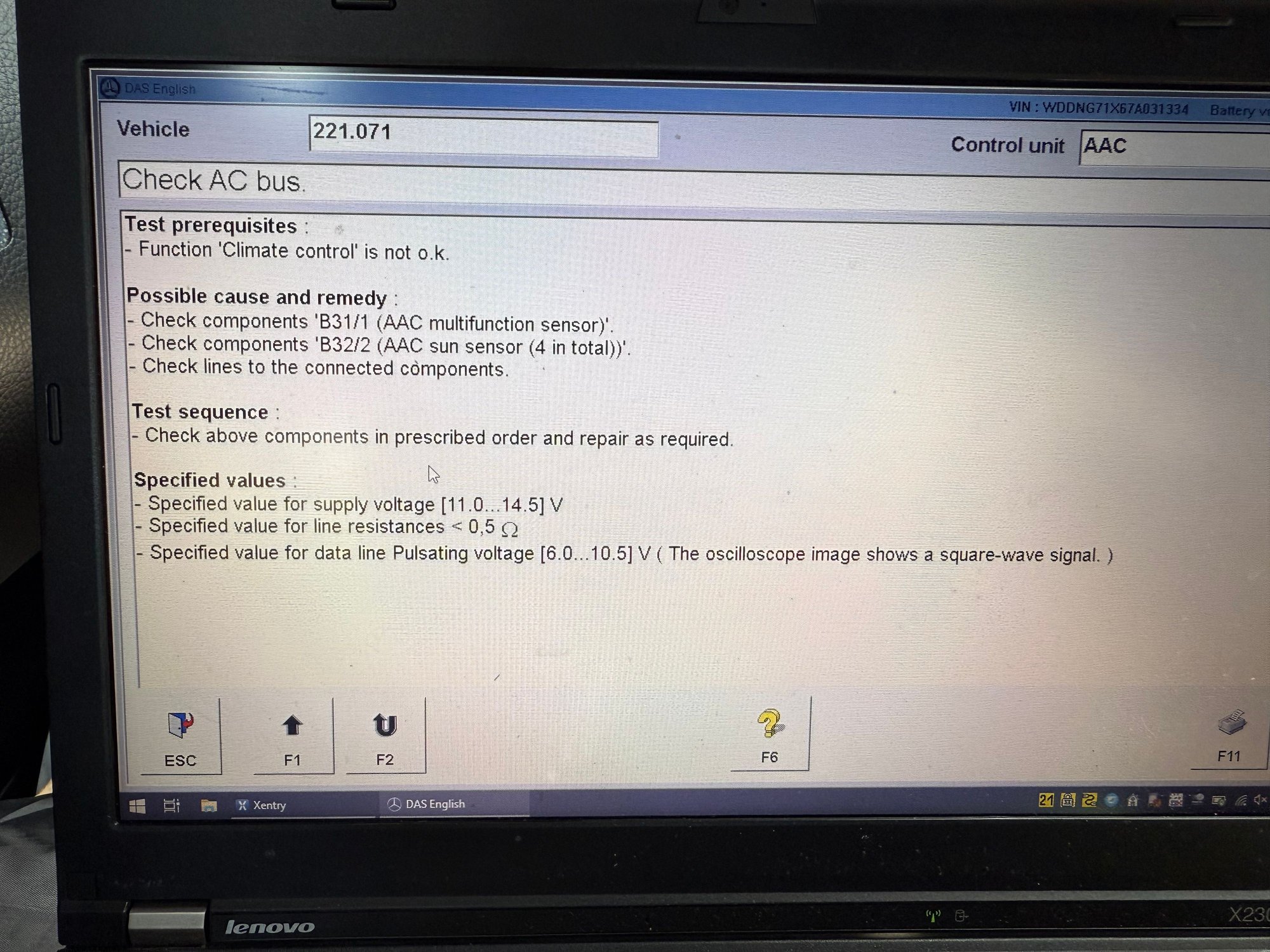

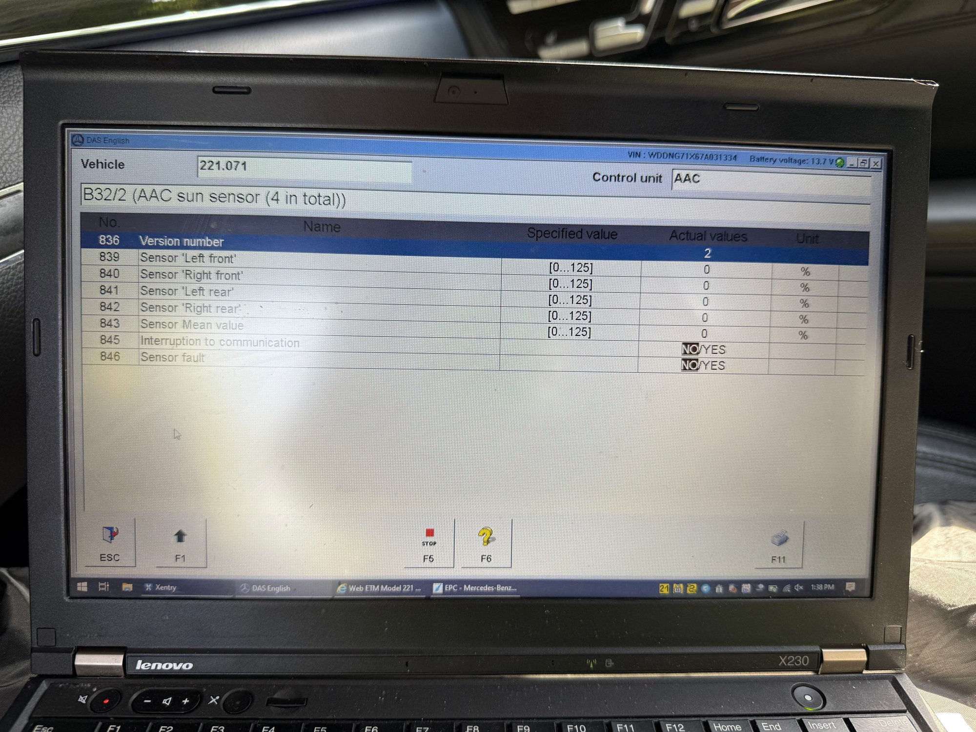

Hello, I am seeking assistance with diagnosing issues related to my ACC control unit. The unit has produced fault codes pointing to potential problems with parts #2118300472 and #2118701310. Upon further investigation, I found that part #2118701310, the Sun Load Temperature Sensor, is not generating any values. Could you please advise if there is a fuse linked to this component? Additionally, I observed that this part has been replaced by a new part number.
Absolutely no readings from the sensor

Check the fuse for your overhead control panel. That's usually what powers that sensor. If the fuse is good, the new sensor itself might be faulty.

there a ambient light sensor - might do temp to, its on the top middle of the screen - but it gets so hot there would seem strange - unless it works with silly number trying to work out solar gain
the whole light thing you have in the photo is the OHP over head control panel (aka DBE) - not to be confused with the heater buttons the UCP - if you do any SW update on the OCP key must be OUT of the ignition or the car goes mad - swapping this is likely to be "interesting"

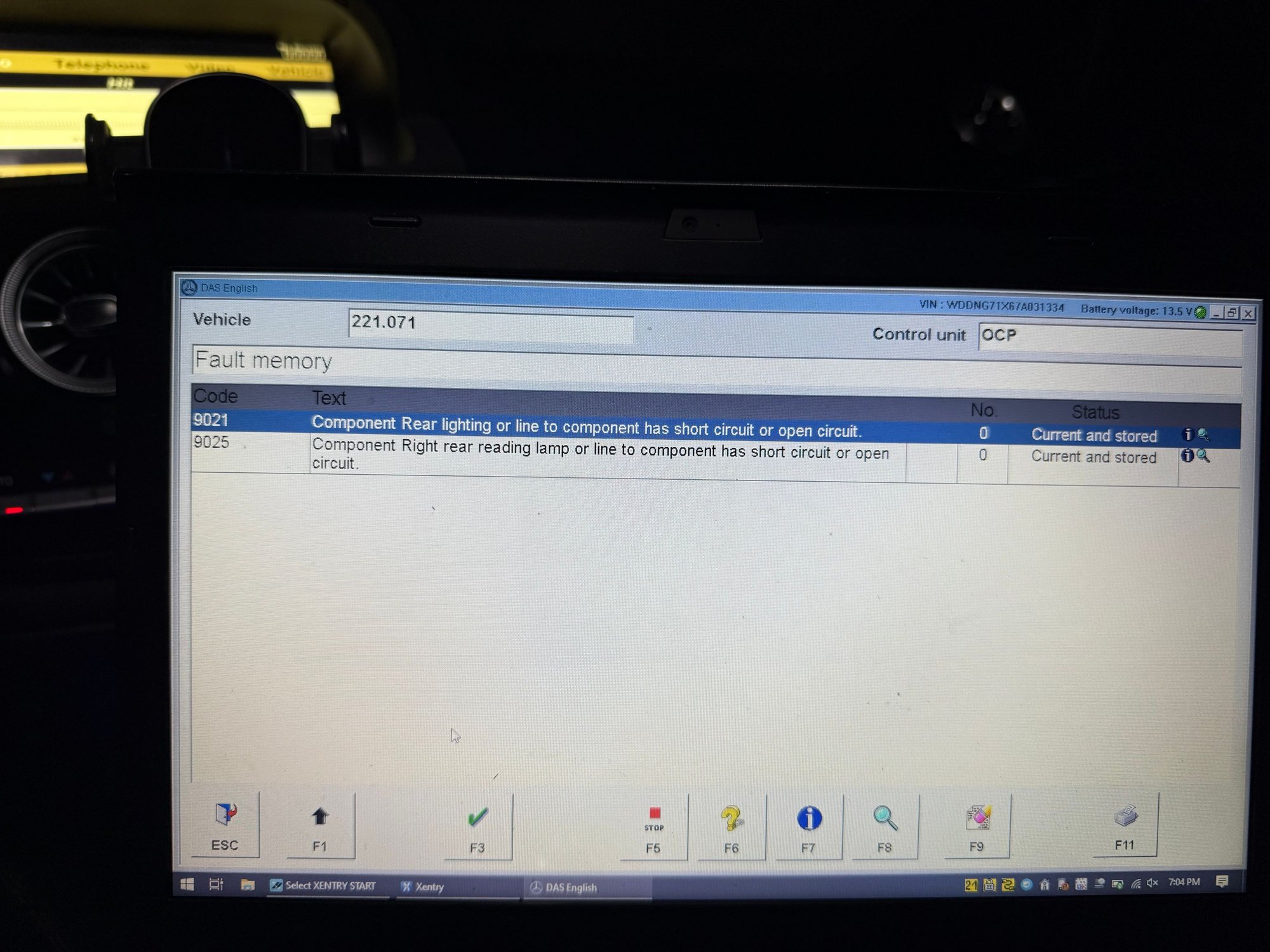

Even with the overhead panel coded correctly the sun sensor doesn’t read anything and I did this test on very sunny day and the temperature was 80 degrees.

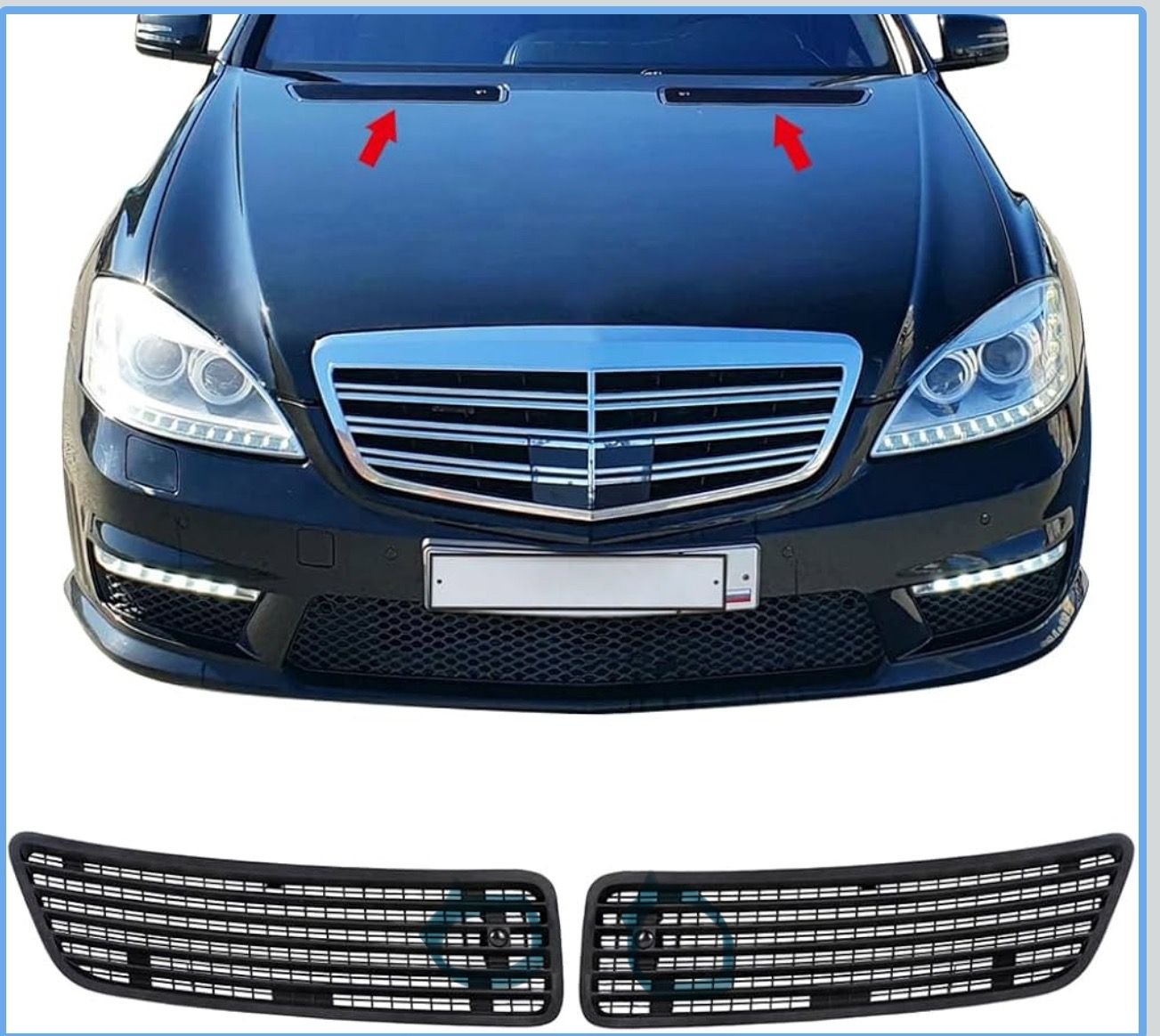

So I ordered part# Light Sensor 211-870-13-10 which goes on the left grille in the picture. What sensor goes on the right side grille? I looked on wis on star and nothing.

Botus,
I've been reflecting on a previous modification I made when i had the stars headliner done, where I replaced the grey overhead panel with a black one. Regrettably, I didn't realize that the overhead panel required coding. I subsequently watched a YouTube video where a guy discussed the need to transfer the coding from the old to the replacement overhead panel. With that being said, the sun sensor attached to the left hood grille still doesn't read anything. I have two questions: should it be reading something, and what is the purpose of the sensor attached to the right hood grille?

if you saw the hell going round the canbus from flashing the OCP - I can imagine there are many versions with low spec cars just about getting a light, and the high spec ones controlling half the worlds internet
it also does stuff differently based on the type of seats in the car and the software version in the rear SAM - my car gets 9 interior heat sensors... and I believe the option rain sensing sunroof closing is both optional and wasting battery all the time (but maybe only if the sunroof is ajar / open)
I never knew that grill has a sensor - I guess the other side is just designed to match ???

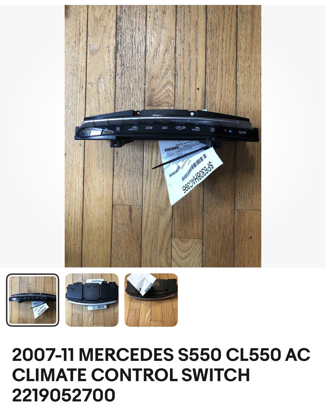

I recently purchased the AC CLIMATE CONTROL SWITCH 2219052700 as a replacement for my current unit. Given that I previously recoded my acc/heater module with Botus' assistance, I would like to inquire whether the installation of this newer AC climate control switch necessitates recoding or if it is simply a plug-and-play procedure? The climate control switch was sourced from a 2010 Mercedes S550 with the VIN # WDDNG8GB0AA335882, which did not feature rear air conditioning. The newest part # for this controller as per Mercedes

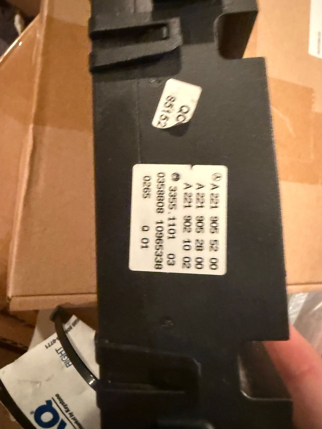

can you post the HW and SW version and dates of its label

This is the new climate control switch.

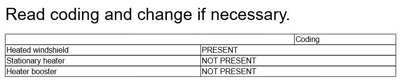

see your bottom number - 221 902 1002 SW of wk 07 of 2010, is the version of SW my car is ruining on - its the last update they offered
check tweak these
you never confirmed if you turned the magnetic clutch to off ?

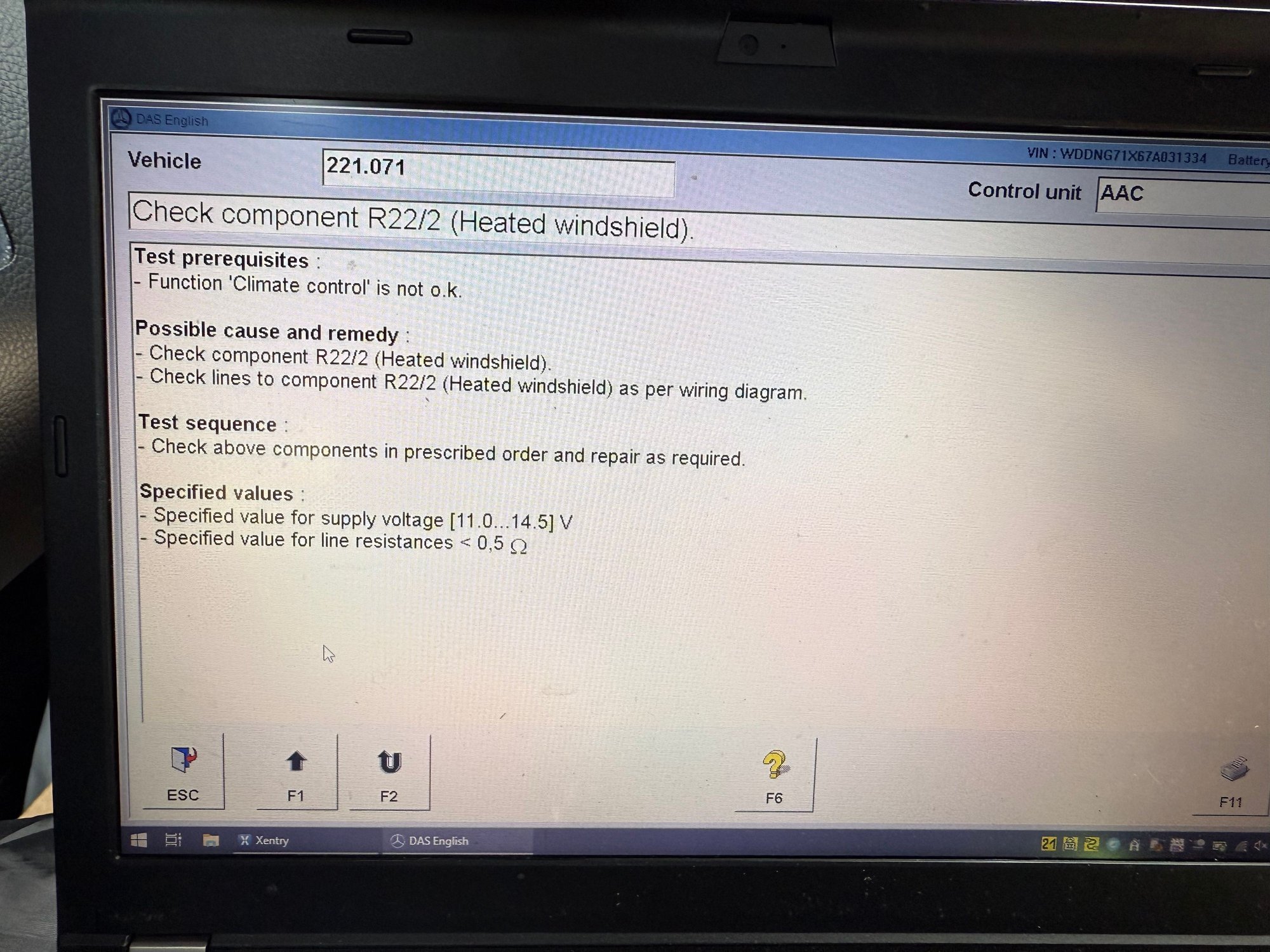

I obtained the panel for $25 and will be installing it either today or tomorrow. In response to your query about the magnetic clutch, I am uncertain. I think it may have been on and I turned it off, or conversely.If I enable the heated windscreen, I will receive the error message I previously encountered before setting it to inactive.

Originally Posted by clb0099
Botus,
either there are two different heated screen ideas or ?
one bit of coding for heated screen is in the UCP and previously you said it was On and in my car its set On - I was suggesting you put it back how it was on the new part ?
there is another bit of coding in the AAC module that was On on yours giving a fault and Off in mine - and when I enable its brings up the same LIN bus fault
and yet more confusion in the Front SAM with coding for heating elements around the wipers
Mine used to work - if it was frosty all around the front screen, the camera and the the wiper area automatically turned on and melted the ice - then the halfwits at Mercedes broke it - with an update but I don't know which
Maybe it needs really needs to be OFF in the UCP and On in the ACC but Merc are too stupid to Know that they are doing with SCN ???
I think the mix up is early cars had it and later cars may not have and the later junk facelift Eng idiots never knew what they were doing...
Or perhaps the halfwits doing the Front SAM are to blame.... My dealer updated Front SAM done back in 2019 and printed out the paperwork
