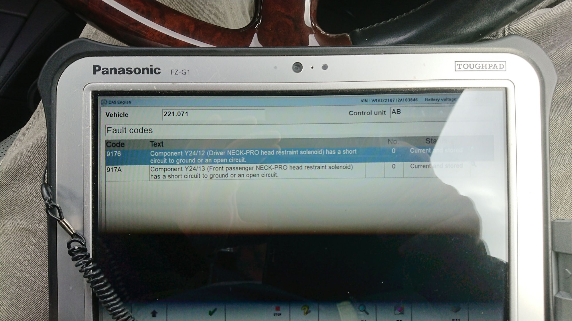

2006 S500 Neck Pro Solenoid fault.
Only appeared after battery disconnect and front SAM removal to allow for swapping the SAM case.
Once all the low voltage codes were cleared, these are the only new codes.

Seat wiring... Just a weird coincidence that it's thrown a code for both seats simultaneously.
Will have a trawl through WIS and see if the wiring diagrams can shed some light on the likely culprit.

double check fuses in the Front SAM ?
F61 7.5 SRS Airbag Restraint System N2/7
F64 10 NECK PRO Head Restraint Solenoids Y24/12 – Driver, Y24/13-Passenger
Thanks for the shortcut👍 Will check there first.

Absolutely spot on @BOTUS 👍
Fuse 64 still intact, but opening the lid revealed the obvious culprit...
I my haste to get everything plugged in, the SAM seated correctly and the lid back on before the rain filled the box up, I didn't quite get the fuse holder locked in, so it was sat cattywampus and hadn't seated any where near it's correct position.
At a glance last night it looked OK, but having driven the car today it was floating free.
My suspicion was a loose plug on the SAM or a pinched wire where the box bolts to the firewall, and although WIS would have lead me to the fuse as a possibility, it was a surprise that any of the Airbag gubbins is fused.
Still, a nice easy fix even if it was self inflicted 🤦
oh - you mean the connection between the SRB to the SAM
signal relay board - fuses
Nope the actual fuse holder... On my car there are 4 fuses in clip on holders rather than integral to the board... One was fuse 64. They're colour coded and keyed so quite precise. I obviously mislocated it when I popped it all back together and then knocked it jiggling the whole SAM assembly into place to refit the two screws that secure it to the case.
