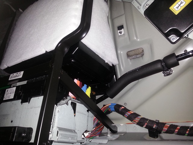

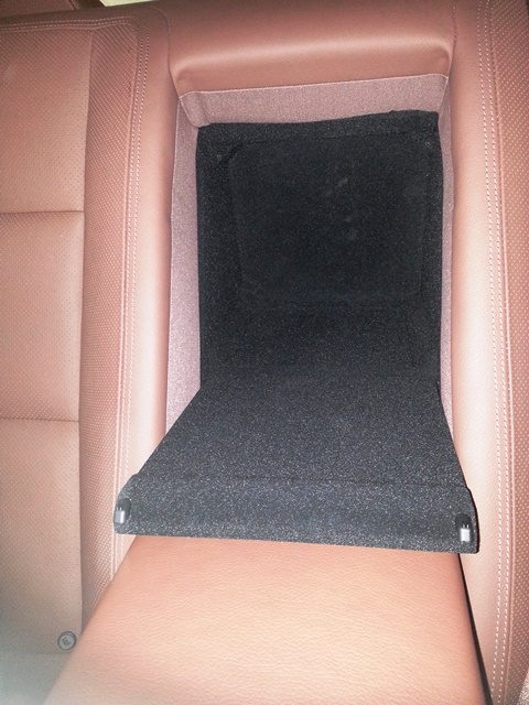

Actually, I pulled my rear panel in the trunk, and it is already setup for retrofit, all I need is the parts. The hole is already there just blocked by the existing plastic storage box, and my rear panel, which has cutouts already molded into its plastic. So after researching this a bit, over the past few days and consulting others (thanks DB!) on this forum. I think I could do it by the following steps:
  • Replace my rear panel with the one that includes the Ski bag door and frame
  • Replace the Stiffener frame with the one that includes the mounting points for the Ski Door and the Refrigerator (may have to pull the rear backrests to do this - no big deal they are not Multicontour).
  • Replace the existing Rear backrest storage box, with the one that accommodates the Ski bag
  • Connect Refrigerator harness to Rear SAM in the identified open slot (Temporarily store car's configuration on a DAS/XENTRY terminal, remove power, install harness connection on Rear SAM).
On my car it does not require any cutting, unless I wanted to save time and just use my Dremel on my existing Rear backrest storage box, and make the hole that is already molded into the replacement part. It does not appear to require any repositioning of any electronic components from what I am saw. The hole is already there just blocked by plastic parts that can be removed via unscrewing mounting bolts

Originally Posted by lganski
In the 220 version the gas tank is located behind the seat.
My car is a W221, and does not have the tank behind the seat - see pics
First pic shows the existing Rear Backrest Storage box, which is located behind the armrest when it is stowed.
Second Pic; shows view of the end and depth of the storage box, covered with sound deadening material
Third pic; shows the rear of the box as can be seen from the trunk if you remove the rear panel
I also have checked on the parts availability and can get the major components that I need. Once I save up some pennies, I may go for it.
