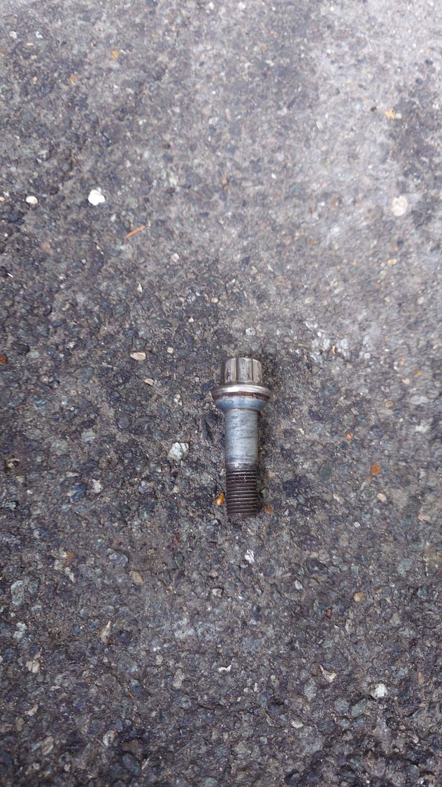

'13 AMG with AMG Appearance package. What is the go to for lug bolts? Mine are okay, One is a little worn, should probably get new. OEM or something better out there? Not a fan of the flower style bolts.

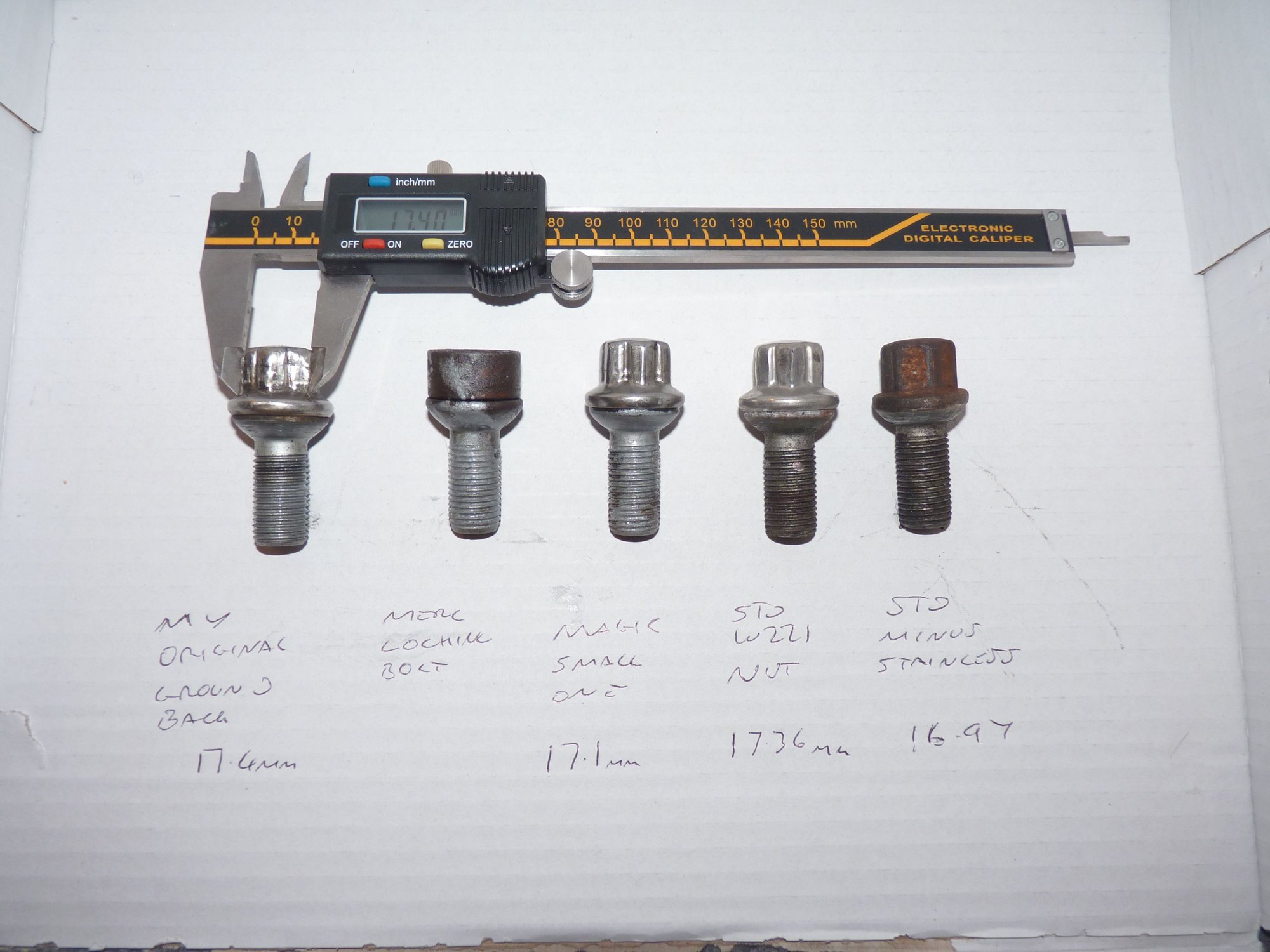

BOTUS's Avatar
Joined: Aug 2014
Posts: 5,319
Likes: 1,675
S500
Originally Posted by AL5461
You're not wrong re the garages... Those bolts all look a bit on the short side though🤔
two bolt lengths based on the wheels on the car
the wheel hub of 18" x 8.5" ones are massively thicker and stupidly heavy - and required much longer bolts
the little ones I show are of the better to drive 17" x 8" wheels that used to run 235 55 17 tyres - the car almost rides correctly when it has tyres - and were the original size when the car was first launched - trouble is they look so silly
