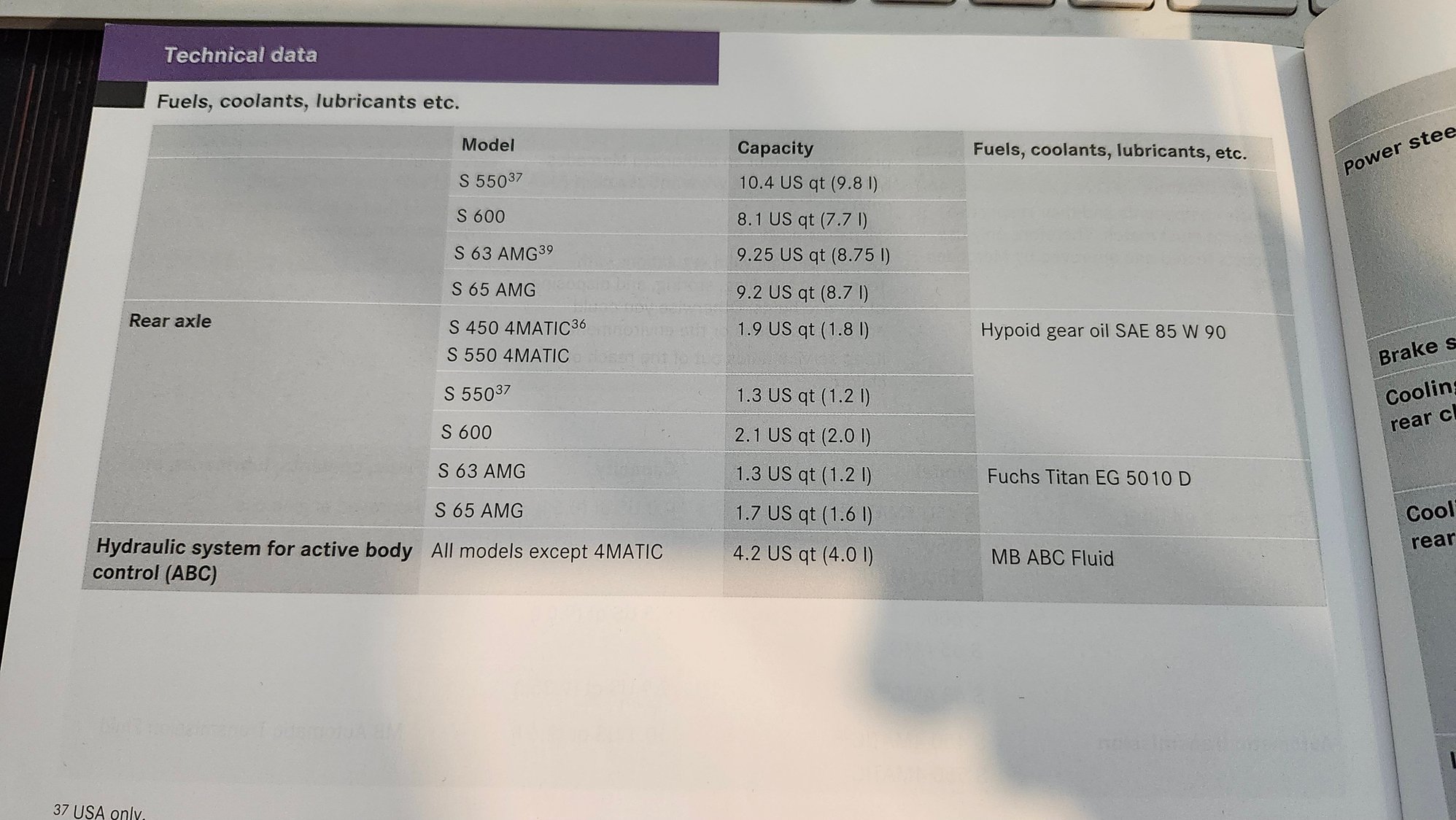

Yup I booked a full rear brake job and front rear diff fluid change this coming week, hopefully it will sort it.
Another question is about the diff fluid I know the rear uses 85W90 according to the manual but how about the front? I found many instruction on how to change it but nobody mention if it uses the same fluid as the rear.
The W164/251 suggests different MB specs, but the gear oil is the same.
The viscosity you give above is different to the W164, but the principle is probably the same...

Yeah the W164 has different spec, I am just wondering if the front and rear uses the same spec since nowhere on the manual or tutorials say about it, so I assume I can use the same for the front diff as the rear does?

That was the point I was trying to make... That both diffs probably use the same fluid, not that it should be the same spec as the W164😉
The ONLY reason they might use different fluids would be if the rear is limited slip and the front is not...
Actually looks like it's the same fluid and the spec you gave is wrong.
https://operatingfluids.mercedes-benz.com/sheet/231.1
Rear axle is 235.7, front is 235.74. Both use 75w85. Which is in fact the same as the W164... Fuchs Titan Sintopoid FE 75w85.
https://operatingfluids.mercedes-benz.com/sheet/235.7
well I have no idea the spec is from the owners manual of my car
In that case either go with the manual or ask MB...🤷
