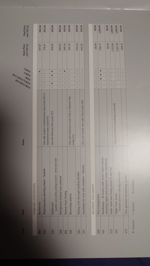

Now, to answer your question, 233 Distronic Plus gives the exact same functionality as 219 Distronic AND 220 Parktronic with ONE exception. 233 will brake the car to a stop in traffic and accelerate away with the traffic. 219 brakes the car down to ~20 mph/32 kph and then switches off.
From an installation perspective, the Distronic part consists of the following items and is identical for both 219 Distronic (Japan only) and 233 Distronic Plus (Not Japan):
Centrally mounted forward looking radar sensor/ECU
Wiring harness to front SAM
Distronic stalk (part of the Steering Column Module with gear selector)
The "Plus" part of 233 consists of the following items, and provides Blind Spot Assist functionality on facelift W221s:
Wiring harness from front/rear bumpers to trunk and rear SAM
Two proximity sensors below the headlights in the front bumper
Four proximity sensors in the rear bumper... One each side behind the rear wheels, two in the rear face of the rear bumper.
Cluster displayed front warnings and rear roof mounted rear warnings
ECU mounted in the trunk in the same bracket as the ECUs for 550 and 881.
In contrast, 220 Parktronic has:
6 bumper mounted ultrasonic sensors front and rear.
Similar wiring
Same warning displays as 233
ECU mounted in the same bracket in the trunk.
So to answer your question, 233 occupies all the same physical spaces that 220 does and fundamentally serves exactly the same purpose for low speed proximity situations.
220 Parktronic was standard on V221/ LWB regardless of engine, optional on all SWB.
233 was optional across the range regardless of engine or wheelbase.
229 is Park Assist and gives steering input guidance in addition to the 218 Reversing Camera guidance and the proximity functionality of 220/233.
229 is a tick box in the Comand programming. I have this ticked on my car, but rarely use it as UK parking spaces are too tight for it to cope with... it complains about excessive steering input but does work with 220. Mercedes obviously chose to add it to 233 to sell it, and perhaps the performance of the 233 sensors is better suited than the 220 ultrasonic sensors 🤔

I'm not convinced we have the info correct above
Mine has the ones with the x
And pretty sure PTS means ONLY the ultra sonic ones...
218 REAR-VIEW CAMERA x
219 ADAPTIVE CRUISE CONTROL (DISTRONIC) - std cruise control with Braking on hills
220 PARKTRONIC SYSTEM (PTS) - std visible ultrasonic parking sensors from 2007
229 PARK ASSIST x guidance on screen for J or Parallel parking (option with early rear view camera )
230 PARKING GUIDANCE -
231 GARAGE DOOR OPENER x Europe
232 GARAGE DOOR OPENER WITH 284 - 390 MHZ FREQUENCY - USA ?
233 AUTONOMOUS INT. CRUISE CONT. PLUS (DISTRONIC PLUS) x radar cruise control - that will manage set speed all the way to walking pace or bring the car to rest
234 BLIND SPOT ASSISTANT - later options
237 ACTIVE BLIND SPOT ASSIST - later options
238 ACTIVE LANE KEEPING ASSIST (FAP) - later options
??? COLLISION MITIGATION SYSTEM 2 - later option, is this AEB automatic emergency braking ?

It seems that cars equipped with DISTRONIC PLUS (code 233) do not have PARKTRONIC (code 220), and the price lists explicitly state that these two options cannot be combined.
code 220 uses ultrasonic sensors
code 233 uses radar sensors and does not need the ultrasonics to provide parktronic.
So with 233 you can/do get parktronic, but with the radar sensors, not the ultrasonic sensors.

229 is specified as an integral part of 233. The 2006 UK brochure/pricelist doesn't specify that 218 is a prerequisite of 229. Likewise, for 220+229.
Basically order 233 and you get 229 for free. I don't have the price list in front of me, but can't recall if 229 was available as an individual option. I know my car has it because it pops up at the bottom of the camera display when reverse is selected... You have to scroll right to access parallel/reverse parking modes
220 Parktronic PTS is the visible ultrasonic sensors. These are replaced by the "Plus" part of 233 Distronic Plus.

yes, is it not part of Distronic Plus ? - BAS Plus - I expect is Collision Mitigation 1 - it senses via radar you are at severe risk of crashing - if the driver then hits the brake pedal - closes sunroof, closes windows, adjust drivers seat to best crash position, inflates seat bolsters, snatches seat belts tight, makes silly beeping noises and smashes ABS to full on (and remains in that state so long as you leave some pressure on the brake pedal). - it does everything AEB does except for no sensible reason doesn't auto brake - I suspect back then they didn't have the bottle to enable it - but the car always had the capability....
yes, which makes me think this is the radar based parking sensor set up that early cars get
you have to have the camera 218 for 229 to function
my understanding is 229 is an option as some cars don’t have it, but they do have the camera ?
later cars changed the camera control module - and I thought they lost the active guidelines so they likely lost 229?
233 did not replace option 220 - radar parking was an early mistake - but SGR radars were left in pay for Distronic Plus duties - then in 2007 Ultrasonic sensors superseded the radar rubbish parking help for all models
if you run the wrong later facelift software on the CGW ending 1427 - instead of 1327
Collision Mitigation 2 is an option but does nothing
220 PARKTRONIC SYSTEM (PTS) will not work

They're all separate systems that work together.
Brake Assist gives maximum braking if you suddenly stamp on the brakes.
Pre Safe is that little pull you feel against your shoulder if you brake and turn suddenly and uses the ESP/BAS sensors as a trigger.
The brochure includes BAS Plus as a feature of Distronic Plus. Presumably this is the braking element between 20mph and zero.
My car only has Distronic. When set it behaves much like Distronic on the W220 and will brake to about 80% brake effort if the car ahead stops suddenly. This gives you a head start for emergency braking compared to not having it and it beeps and flashes a message when it disconnects as the speed drops below 20 mph.
In passive mode it gives a visual warning if it thinks it's too close to the vehicle ahead. It beeps and will apply the brakes if it thinks a collision is imminent but does release the brakes the instant the threat passes. Beyond the occasional close call on a busy roundabout, I haven't stress tested this and wouldn't rely on it under normal circumstances, but I suspect that it will get the job done in a pinch, if only to make the impact less severe... Which is what it's there for.
Also my car does have the full function rear camera rather than the later one, lines and Park Assist. I have the later one on my '07 ML and it is just a camera, no lines or space guidance
According to the 2006 price list, 218 is ONLY available with EITHER 220 OR 233. But no mention of having to have 218 if you specified 233... So it's possible to have a 233 equipped car without 218. If that car still has 229 is anyone's guess🤷 as neither the brochure or pricelist mention it. Likewise, no mention of 218/220 having 229.
Because 229 is only mentioned as a part of 233, it begs the question as to if it's actually available on factory 220 specified cars? It is activated on mine because I ticked the box in Comand to activate it and it works as it should, (and as poorly as the 233/229 system as discussed earlier &#128514.
