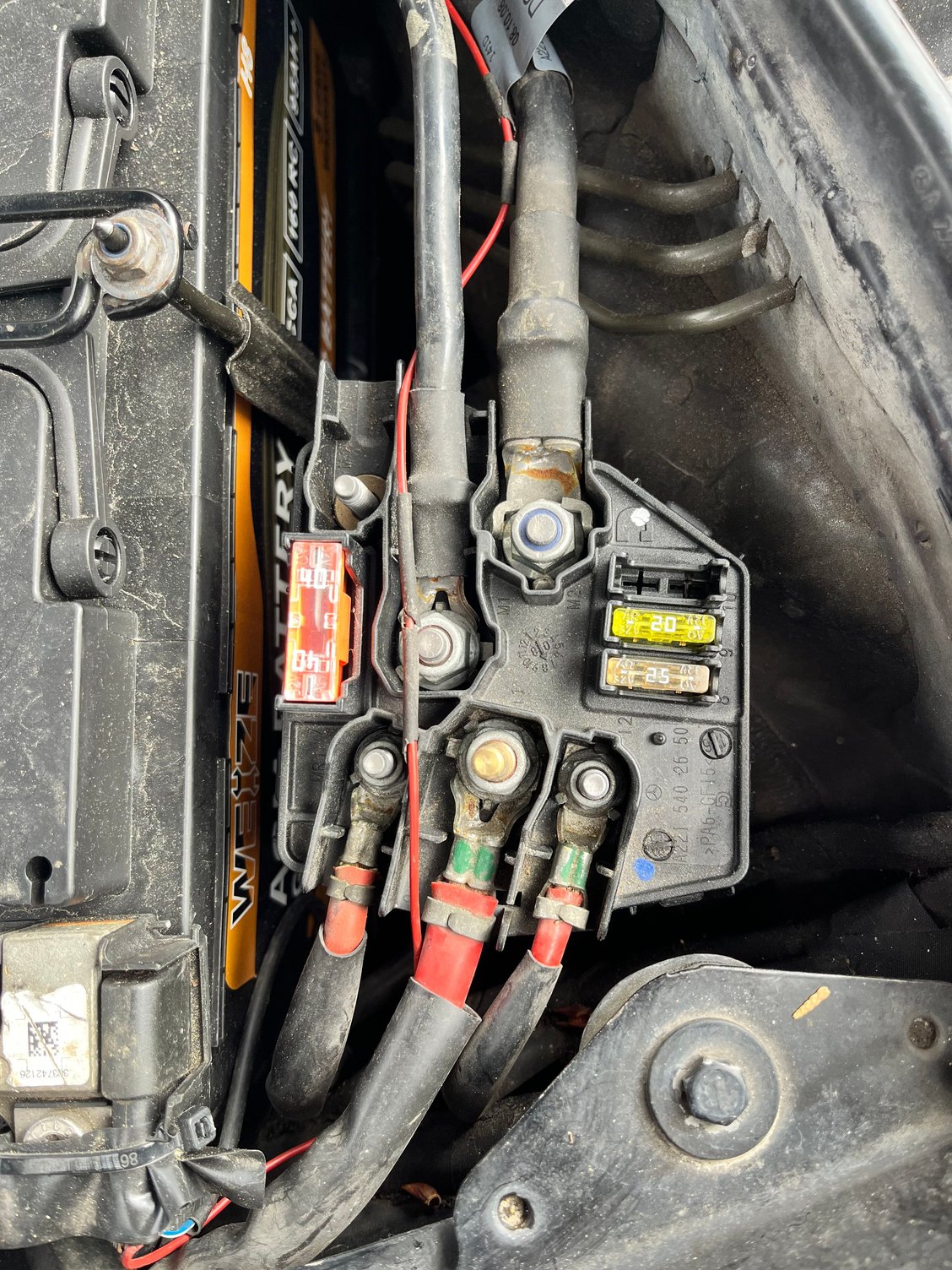

My power distribution box, sans cover.

that box of tricks shows you have at least the mini facelift away from the twin battery madness of the early cars - however it likely means behind the ignition switch is a smaller motorcycle battery that also needs changing now and then
I very much doubt it will help your interesting cause but may as well start from a good place
next to your real issue - it seems after a certain age interesting weirdness becomes many a merc - why and how remain an anathema

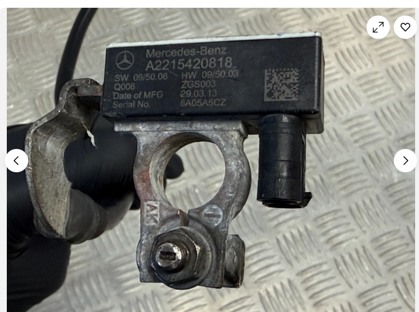

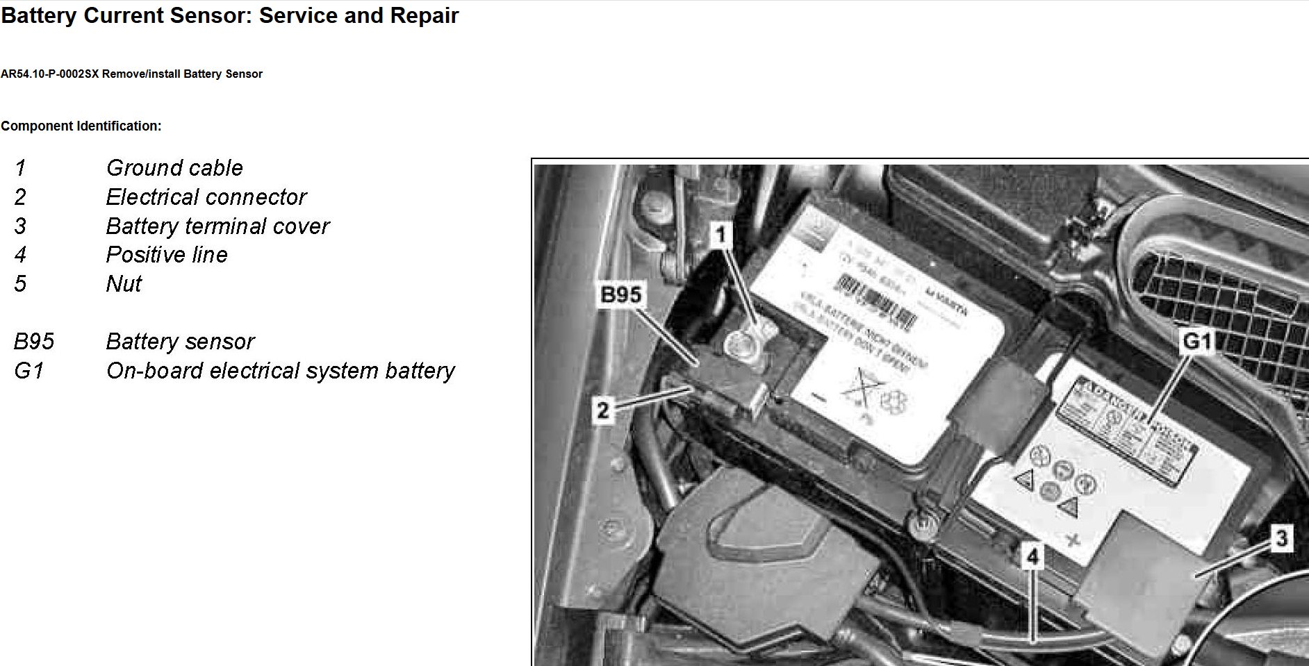

Does anyone know what the little device, I'm assuming sensor, located on the negative battery terminal by the battery? If you look at the lower left hand corner of the picture I previously posted you''ll see it there, literally sitting on the negative terminal of the battery.
Old Apr 27, 2026 | 04:57 PM

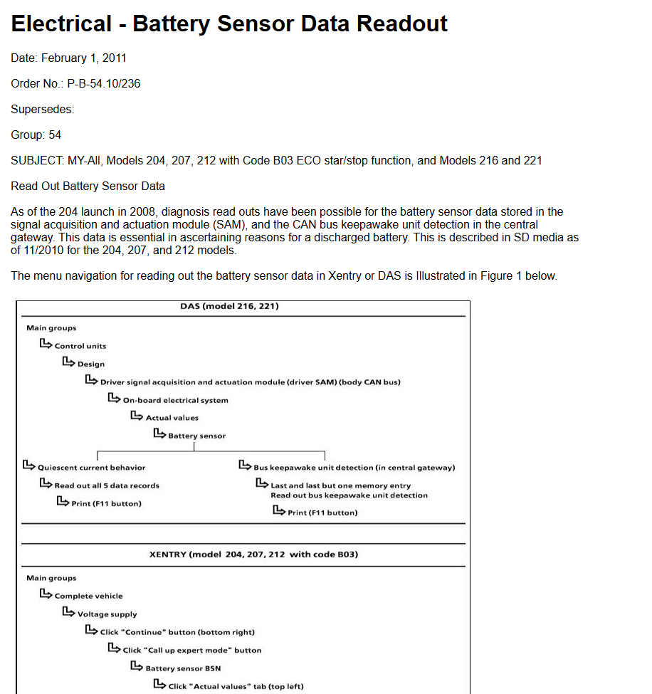

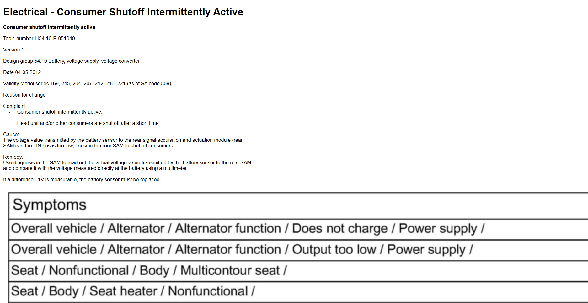

Sensor on the negative battery terminal is the B95 battery sensor.
Theres two TSB's on that I can find.

Very interesting. That actually helps me understand some of the dying messages that popped up and the message the car's head unit displayed.. Something to the effect of system (audio) will shutdown in X minutes. I guess it was thinking the key was left on and the battery was draining...

What part are you looking for, the battery sensor/negative cable on the battery in the engine compartment?
Mercedes is usually good with stamping part #'s on every part even tiny connectors. Just look on the part for a part#. Confirm on the parts diagrams. If the car is used you never know if it was replaced at some point with the wrong part #.
To look up parts using parts diagrams listing your submodel or vin is helpful. part #'s may be different depending on options.
Photo below is an example of part # on the battery sensor:
