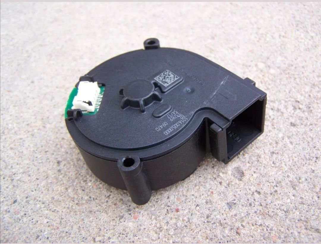

​​​​​​Hi, in pdf file Headlights condensation
You could see at page 5(17) temp graphics inside/outside the headlight. The sample is for headlight with HID lamp(xenon), which generates more heat than LED.
BTW at page 28(39) there is explanation using velocity approach. It is visible, that condensation at MB headlights are also located at lower "lee" sectors. Mounting very small fan(used in comps) inside headlight is relatively easy to be power supplied and accommodated,but is still complicated for doing at home. The purpose of the fan is just to make air flows and to utilize internal heat from led modules, creating no "lee" sectors. In my opinion, this could be done from MB, rather than to insert the silicagel packs with limited workspan.
Inside the headlight, there is a cooling fan, but it is for DRL module,and obviously does not create enough air flow.
Cooling fan DRL.

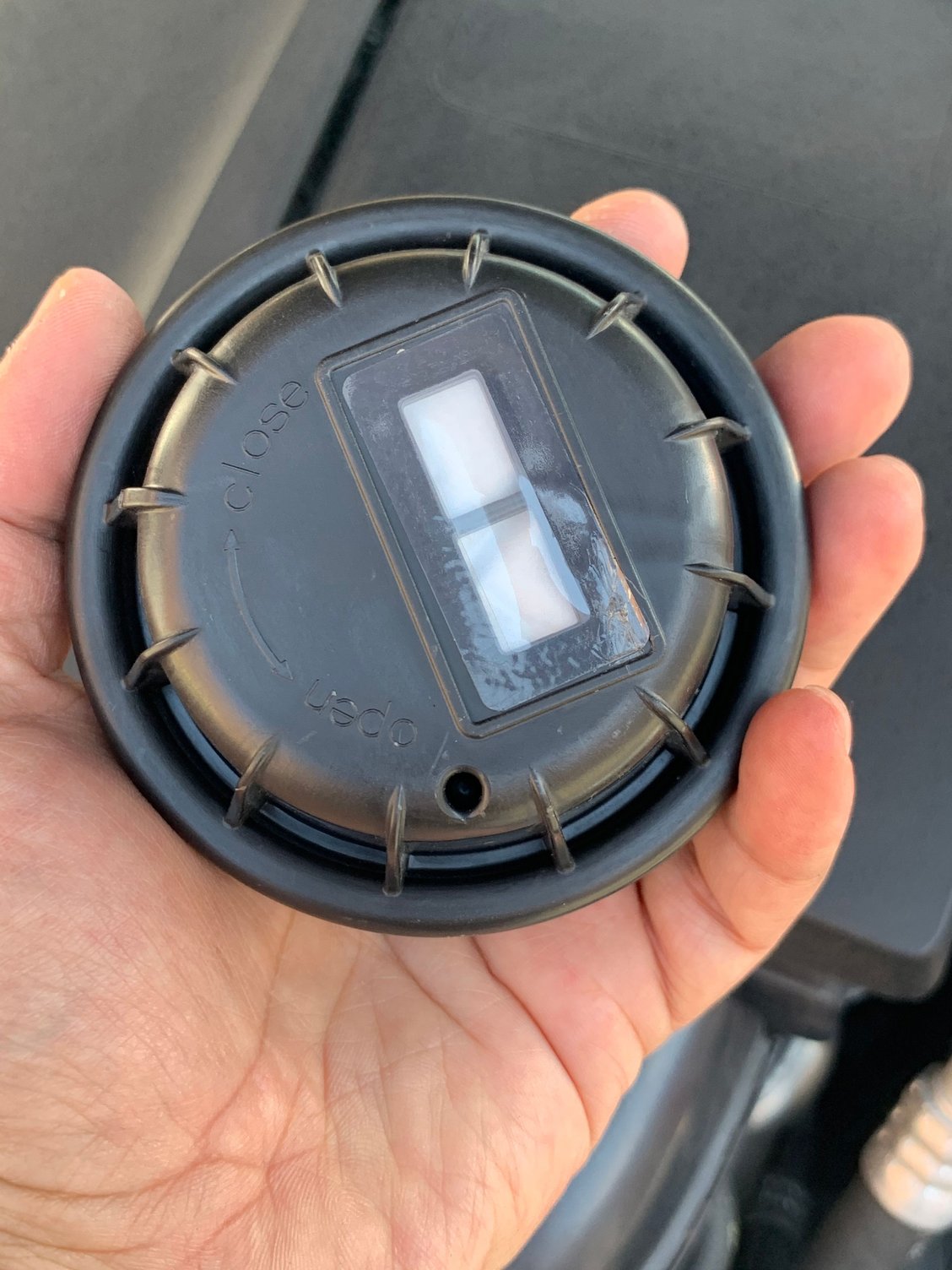

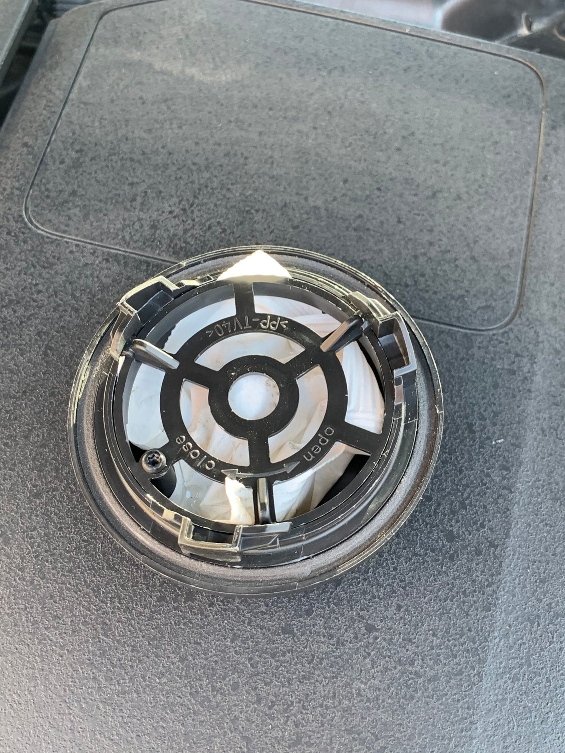

An update on mine... Had to get my drivers side headlight replaced.Got 50% contribution so around £900 including the diagnostic.
Anyway yesterday it was humid weather (no rain) and my left side headlight started to steam up inside, and thought there goes another £1k. However I checked the back of the light this time and to my surprise found the so call 'gel/desiccant pack fix'. Its a cap the size of a petrol cap filled with these gel packs! Anyway took the cover off and left it off for about 15 minutes while driving, and all the condensation gone! I took some pics which are attached, however my question is what gel/dessicant packs should I buy to replace these ones as they look gonners Don't mind changing the pack every few months as they would be cheap enough??
The new right headlight does not have this fix but not too bothered as that should be under two year warranty i think!
Screw/Unscrew cover on the right
Gel Packs inside held with a torx screw
Outside of the cover

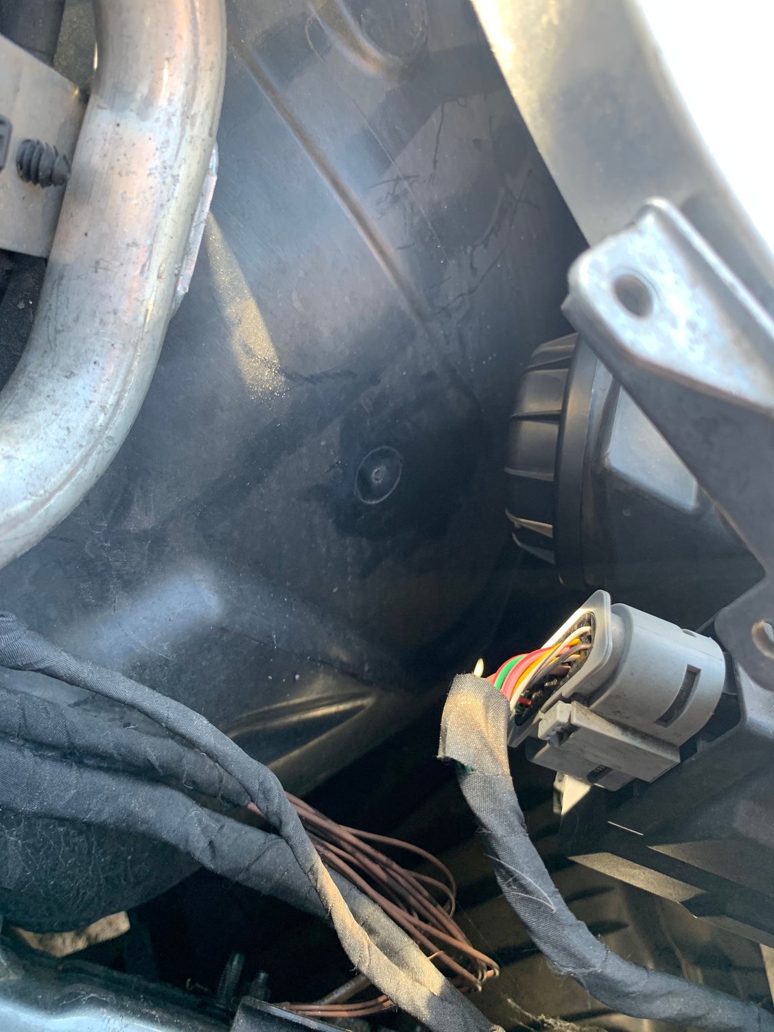

• Remove the right side headlight assembly
• Remove both electronic control units and place the headlight assembly in a small closest room in my house with a dehumidifier for 24hrs.
• Install new gel packs, and reinstall the headlight assembly.
Before I attempt the above Id really appreciate any advice from anyone on here that has removed the headlight assembly from their sclass below are some concerns/questions I have:
• Looks like 3 bolts hold the headlight assembly in place, the top two are easy to access, the lower one appears to be accessible from underneath after remove the two underside covers. Do I need to remove or loosen the bumper fixings in order to slide out the headlight?
• If I were able to remove the window washer bottle I could access the control module on the rear of the headlight to reinstall the gelpack without removing the complete headlight? Has anyone tried this?

Thanks for the reply, I started the job this evening but didnt have enough time to complete it and I want to order the new gel packs before I actually remove the headlamp.
I got all three screws out quickly enough and the grill, and as you correctly pointed out there wasnt enough room to lift the headlight out.
Tomorrow ill remove the bumper retaining screws on the driver side wheel arch and the bumper screw behind the grill im hoping i can slacken the bumper on the driver side only without removing it completely and lift the headlamp out.

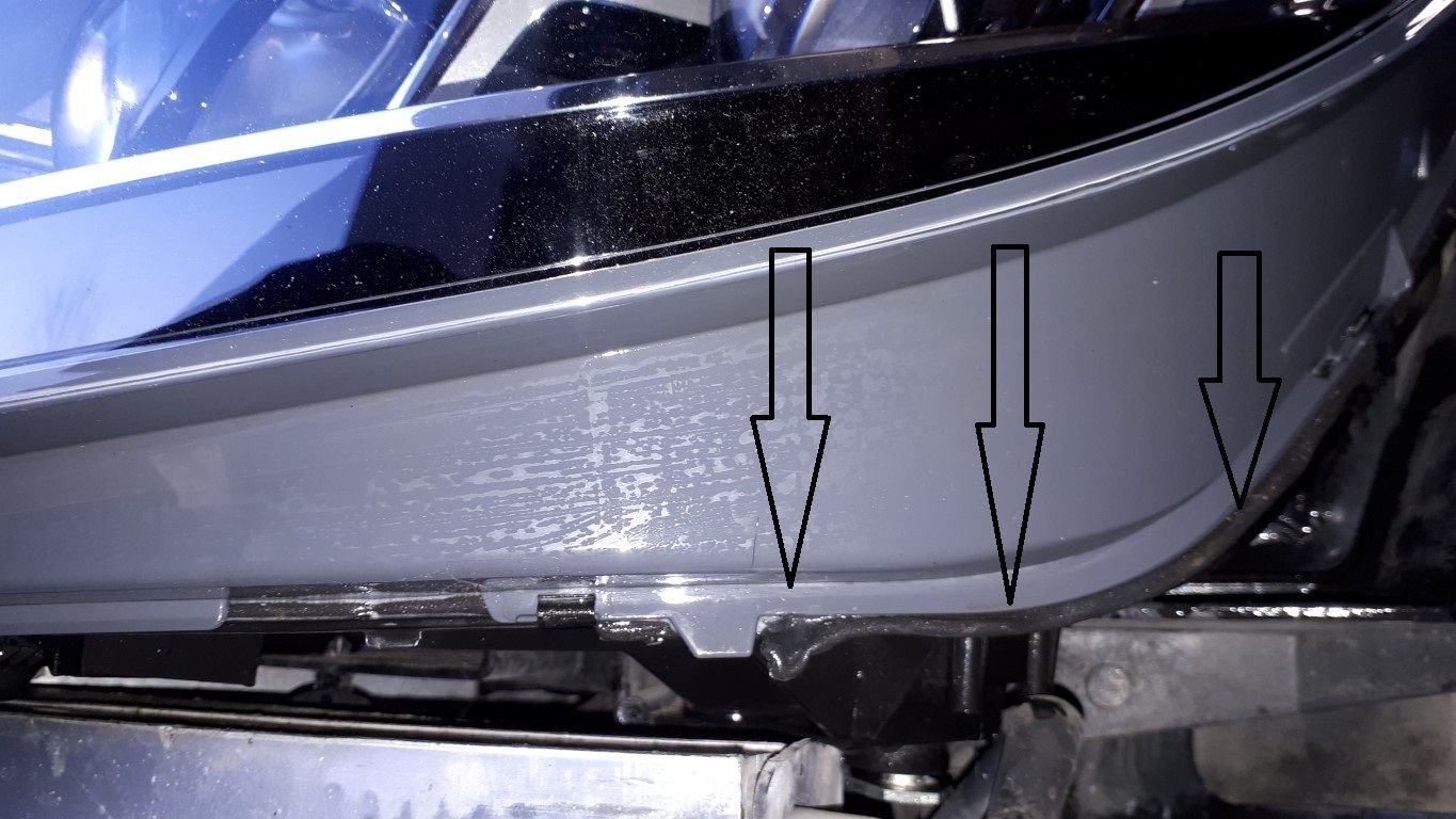

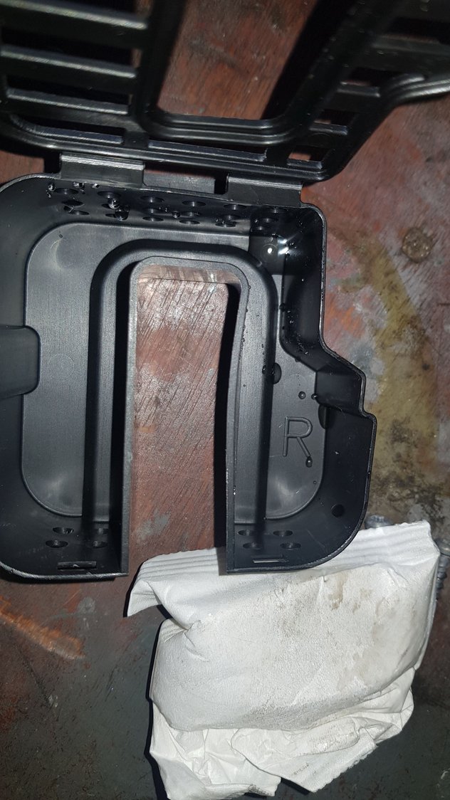

Just coming back to give an update to anyone else attempting to remove their head lights.
It was quite easy in the end, heres a brief outline of the steps I took:
* Remove two bolts from the top of the headlight assembly.
* Disconnect 360 camera connections, remove grill, remove headlight & bumper bolts
* Remove two clips from inner liner of driver side wheel arch, pull liner back to access two torx and remove them.
* Remove two panels from the under side of the car.
* Remove bolt from underside of headlight assembly.
* Remove two screws holding front bumper
I have WIS instructions for the above if anyone wants them.
Now you can gently pull the bumper and lower it on the driver side, you dont need to remove it totally as you will have enough room to lift the headlight out.
On inspection I found the gel pack (7 months since it was installed) was totally soaked and there was water in the gelpack basket. It took me about an hr and a half to remove the light and reinstall it. I've now come to conclusion this is not something I can be doing every 6/7 months. So time to start thinking about a more permanent solution.

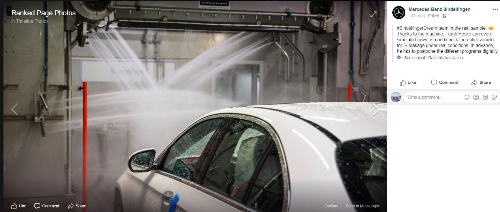

This appears just now on Mercedes Sindelfingen facebook page (home of sclass production), I dont know whether to laugh or cry
