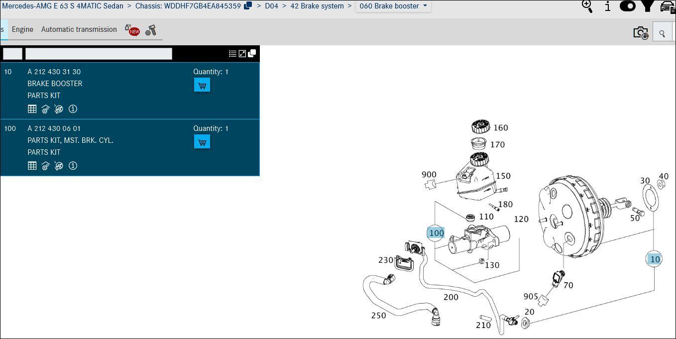

On the shoulder
Bumping an old thread - does anyone have the part number for this? FCPEuro doesn't seem to carry it.
Edit: Two parts found:
Brake master cylinder:
212-430-06-01
Brake Booster:
212-430-31-30
