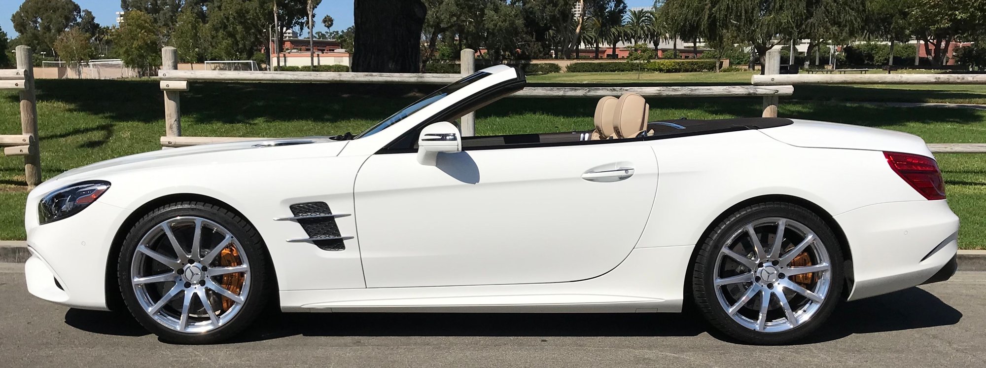

I am such a fan of the Carbon Ceramic Brakes option, that I retrofitted them to my little SL450, along with AMG forged wheels and I never drive fast. It was a VERY expensive upgrade, which I did about 90% for the ZERO DUST factor and 10% for how cool they look. MB really should make these fabulous brakes available across all models and trim levels, like Porsche does, not just for the AMG models. Not only do the wheels remain near spotless after weeks without a wash, the rest of my car seems to remain cleaner much longer as well.

The problem is that the CCB brake option is ONLY available on AMG models. You could get them on the S63 & S65 sedans, but they are not available to order on the other W222 models, which to me, is just plain NUTS! If somebody wants to pay the price, why not? Not everyone—not NEARLY everyone—wants a full blown AMG car, but would like to be able to pick & choose some of the “bolt on” AMG goodies. By the way, the CCB brakes simply bolted onto my SL, easy-peasy!
