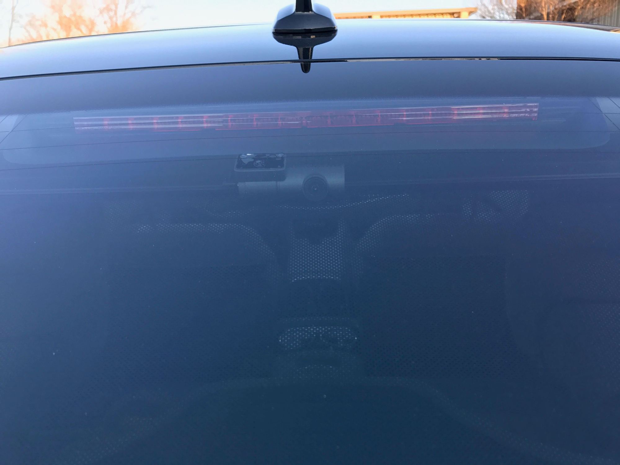

Crappy pic but here is rear cam install on our old S-Class. The Blackvue rear camera fits perfectly on top and it not affected by the rear screen and thus invisible from the inside. We have the Thinkware dash cams now (U1000's) and if memory serves, the mount of the rear cam be be a bit taller than the Blackvue's. Still think that the shade will not interfere. Good luck!

Yep, thats right where I put mine. All installed!

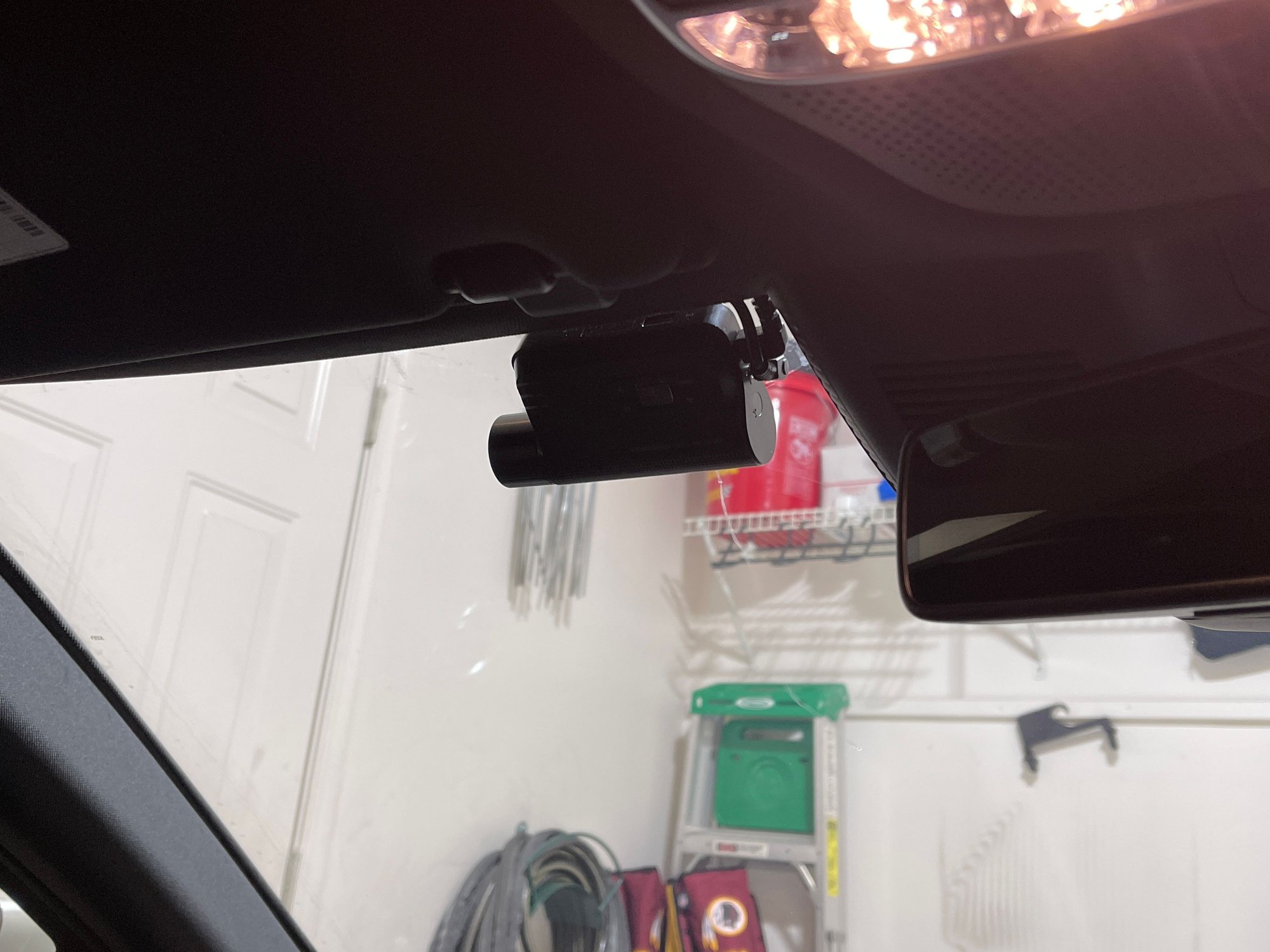

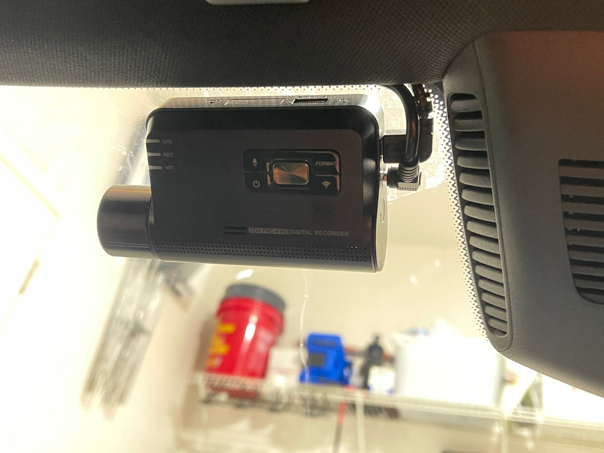

Not quite as slick an install as on my LS460L because of the large camera housings around the mirror, but looks fine.

Thank You! Any issues with GPS with the unit being on the left, the cutout is on the right side of the mirror for EZ-PASS and Radar Detectors..

That location definitely interferes with the GPS. A similar mount on my own 2018 S560 can take up to 15 minutes to acquire GPS signal. Once it locks into GPS, it's usually good to go for the whole day no matter how many times I stop and turn the car off. Same location mount on my 2017 SL550, GPS locks on immediately. Both cars are kept inside a garage. The metallic coating on the S560 is definitely a problem for GPS. The 2021 S Class with the OEM electronic toll transponder eliminates the windshield mounting signal blocking.

Surprisingly, not really. It takes it a couple minutes to connect to GPS, but once it has it, it seems to keep it.

GPS data is crucial for a dash cam for accurate speed calculation and exact geo location tracking. It maybe helpful to check the actual footage itself to see if you have the info is good as the GPS needs to lock onto multiple satellites for accuracy...
If you end up having GPS issues, just move it to the other side of the mirror. The windshield has a cutout in the infrared coating there.

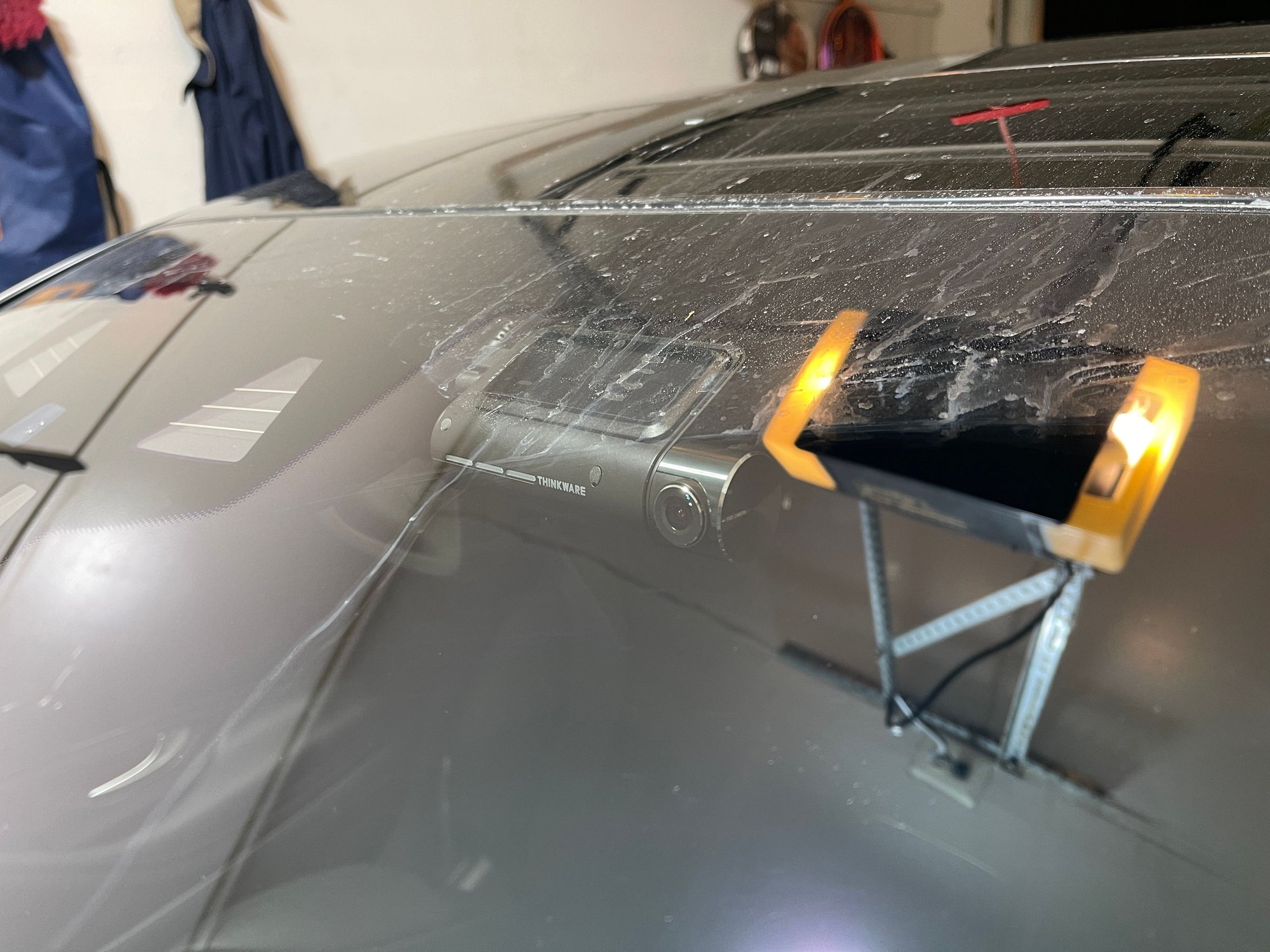

If anybody wants to see the camera view from that placement here it is
