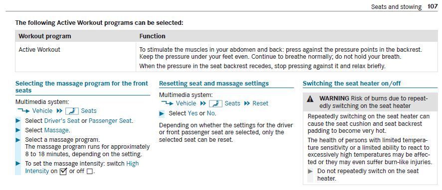

Thing is I can keep the seat massager running all day long if I keep hitting in a different massage before it times out after around 15 minutes. Once it times out the only way to get it operable again is to turn the car off and restart the car and then it will run another 15 minutes or in my case I switch to a different massage after 14 minutes and I can keep it running for my whole trip, lol. If this were normal as the Florida dealer stated, Mercedes would be out of business. Some of these dealers sure do Mercedes a dis service. I suspect like you said if the code is cleared and the unit reset it will probably be fine.
