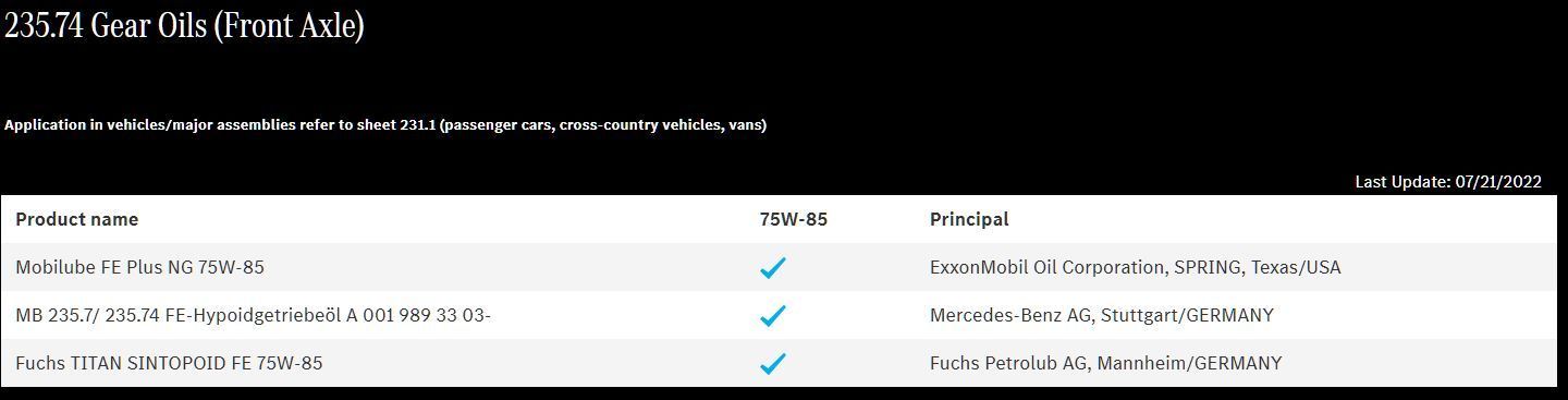

Barring any mechanical problems discuss replacing gear oil with independent using this method to avoid filling through shaft: https://mbworld.org/forums/s-class-w...ml#post6397209 proactively a number of members replace fluid @ ATF intervals 60,000/6 years.
Appreciate this, I'm going to look into then speak to my independent.
