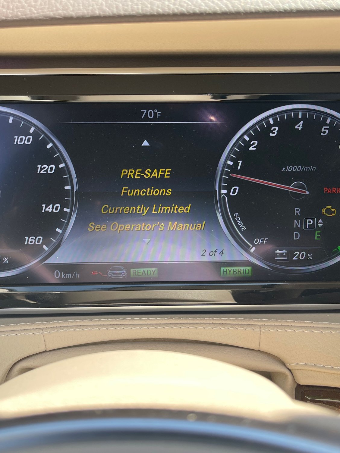

Hi folks i need some help. I had to jump start my 2016 S550e this morning after it died yesterday. I kept the car started for about 6 hours. During the time it was on it kept giving me the message “stop the car. Keep the engine running” which went away after about 2-3 hours. Since then it has been giving me a “battery malfunction “ error and other errors related to some safety features getting disabled. I tried driving the car on the local street and it drove fine. I was not wearing the seatbelt but it didn’t have the audio warning, backup camera never showed up etc
I looked it up online and most people have had the “auxiliary battery warning” problem but I couldn’t find any tips on “battery malfunction”
is this just a matter of getting the main battery replaced?

facts gathering...
How old is the main battery?
Do you own a battery charger?
Do you have a battery tester or voltmeter?
CEL is on... scan the car for faults is faster than replacing good parts.
One can guess your car has a voltage issue, specifically a low voltage condition. What caused that is a good question to seek answer to.
Is the alternator control charging or draining the battery?
Hope this helps 🤞

1) no idea how old the battery is. It hasn’t been replaced since i bought the car in july 2019 as a CPO
2)i tried charging the battery using a charger but it didn’t help. It didn’t do anything overnight. Which is when we decided to jumpstart it and i kept it running for 6 hours. I guess i can try again now that it has some battery in it
3) i do not have a battery tester or voltmeter. I’m imagining you’re asking to test the voltage in the battery and battery health?
4) Is the alternator control charging or draining the battery? - no idea what this means. How do i check?

battery is done...
If you charge the battery all night and the car still requires a jump to start...
95% chance the battery has an open cell.
Not starting is the ultimate test, no fancy tools needed.
Time for a new one!

So after the car standing for over 15 hours and engine off, i started it this morning and it started right off. So I guess keeping the car started for 6 hours yesterday helped. The panel still shows batter malfunction but i can drive it.
Does this still mean the battery needs replacement or is it a matter of charging it ? Not sure how to make that call?
I can also take it to an auto parts shop to get it checked but just wanted to see how much i can diagnose at home

I believe that most auto part stores will be able to test it for you, and they will probably even sell and install a new battery for you too!

99% you need a new battery.

educated guess...
thank you for all your help so far
It's up to you to decide if you want to buy a $200 battery or if you'd rather wait and pay $300 for a tow truck.
Your current battery may be just fine: One time it doesn't charge, next it holds charge well... so I am on the fence to lean either way - I'd say be safe.

sorry one last question before heading to the auto shop. How do i know this is because of the main battery and not the auxiliary battery?

odds to stay fixed...
This message is definitely NOT about the AUX✌️
Replacing the battery may only bring temporary relief to this issue. Other factors may be at play to make the battery look bad.
My best advice would be not to rely on a parts store to service your Benz with a parts-canon... I'd take this opportunity to develop a relationship with an honnest local MB specialist.
If this problem returns, you will be in a much better position to get joy.
​​​​​​With that being said, if your battery is 5, 6, 7 or more years old, then $200 is definitely money well spent without question.

It needs to be seen by MB.
Thanks John, At this point I’m trying to just get the gas engine going so I can take it to MB. I did put the battery on my charger and it did receive a full charge, but the car still doesn’t do anything.
Old Mar 6, 2026 | 09:57 AM
JohnLane's Avatar
Joined: Feb 2012
Posts: 2,632
Likes: 1,217
From: Phoenix
222 S-65
Ring MB at 800-222-0100. That is roadside assistance. They can arrange for it to get drug to MB for the attention it needs.
