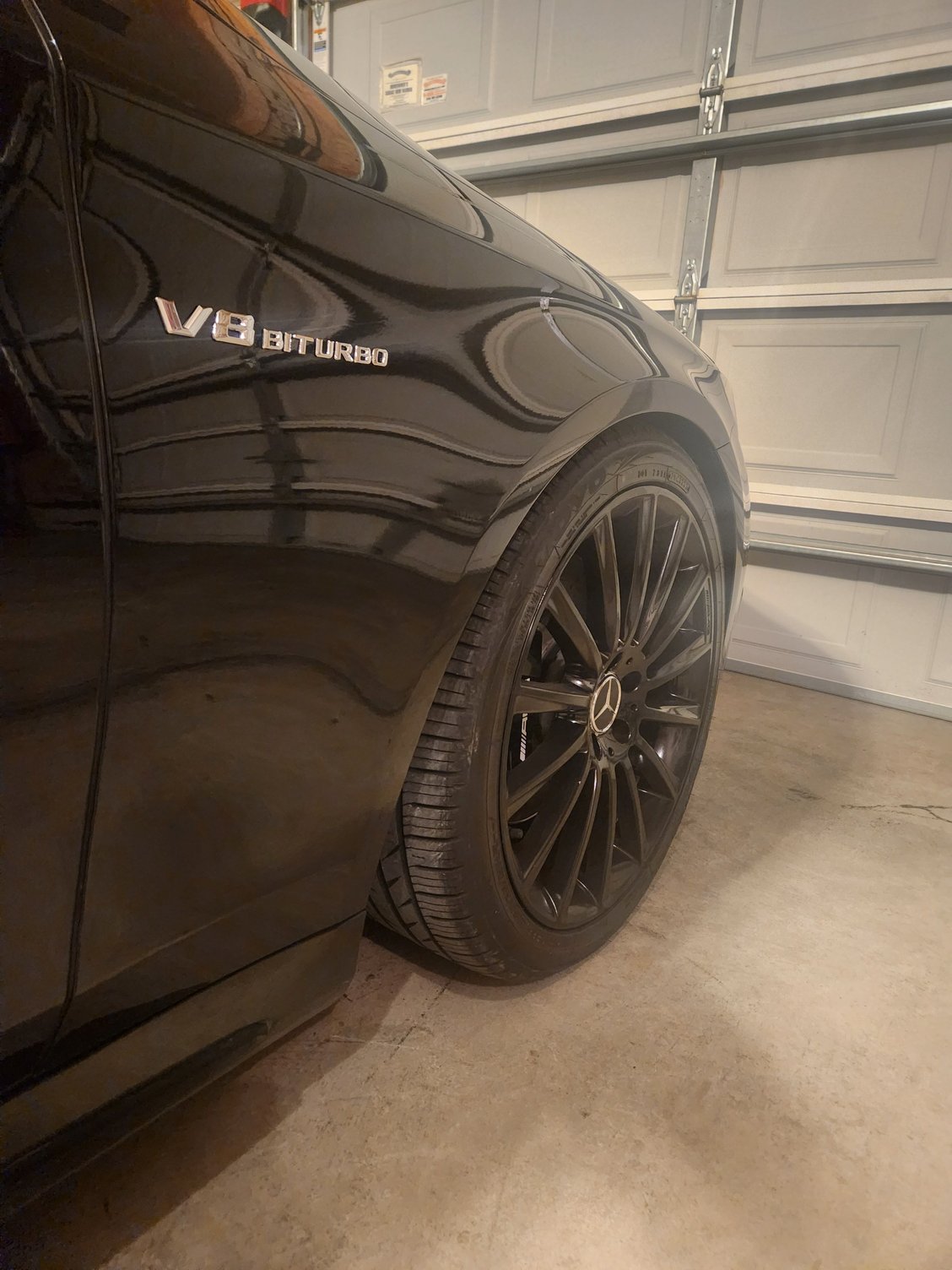

Air suspension lowering by itself when not driven for a while?
hey guys. had my s550 for about a month now and noticed when it sits in the garage for a few days without being driven it gets low on its own. it looks really good dont get me wrong but im wondering are the shocks leaking air or is this normal? i also noticed when i start it the compressor starts pumping and it raises itself back up. the front seems lower than rear.

That does not look like a leak, that looks like an s class that sat for a few days.
the system is filled with air.
if it sits a few days air will come out. Nothing is airtight.
if you have a leak it would be more dramatic of a drop and it would be clear which side or strut is failing.
These struts have lasted me over 10 years on my w220 and both my w222 and w220 sit a little low after not being driven for a few days.
If your airmatic compressor is kicking on a lot and for more than a minute you have a leak.
leak is usually at the strut or valve block.
Computer won’t tell you everything and can only tell when a sensor says pressure is off.

If the slight lowering is a sign of a leak, it usually happens in the front because of the long term sustained loading due to the weight of the engine (comparing to the rear).

You defenitely have a problem. It might only be slight, but it is a problem. The quicker you act and find the leak, and get it fixed, the better chance you have of not burning out your pump. I've owned several air and hydraulically suspended cars, starting with my Infiniti Q45A in the late 90's. The car should not lower noticeably even if sitting for a week or two. By the way, I've enjoyed watching the mods you're doing with yoiur car

I posted about this in the past, and here is a copy of my notes/response at that time (specifically during cold/winter months):
I've been taking measurements (distance between the lower edge of the rim to the fender) over past 2 days:
Baseline: 27.25 inches (2 days "48 hours" measurement )
Distance between the lower edge of the rim to the fender):
  • Baseline: 27.25 inches (day 1 morning)
  • after 12 hours: 26.75 inches (day 1 night )
  • after 24 hours: 26.75 inches (day 2 morning)
  • after 36 hours: 26.75 inches (day 2 night).
  • After 48 hours: 26.75 inches (day 3 morning)
Experiment is done. This confirms the air contraction theory for the W222 AIRMATIC system, during first 12 hrs only before it stabilizes, with around 0.5 inches due to air contraction. This happens when ambient temperature of air inside suspension drops to 30-40F or lower, yielding a lower air density and thus a smaller air volume in the suspension which causes the car to set lower.
**For the record, these measurements were taken at temperature of 32-35F. I expect the contraction to increase by another 30% based on air density at 15F or lower, meaning another 0.25 inch for a total of 0.75 inches at colder temperatures such as 20F or lower.
Based on this, 0.75 inches of height difference is within design parameters, however, for those who experience more than 1-inch of height difference overnight, i would encourage them to test for any potential air leak especially during summer or when temperature is not that low.
If you experience a height drop that's outside the normal numbers/parameters above, It's likely that there is a leak somewhere.

You likely have a leak somewhere along the lines.
The compressor running for a minute at start up is unlikely to cause issues, what you don't want is the compressor running every 5 minutes to keep the car level while running.
