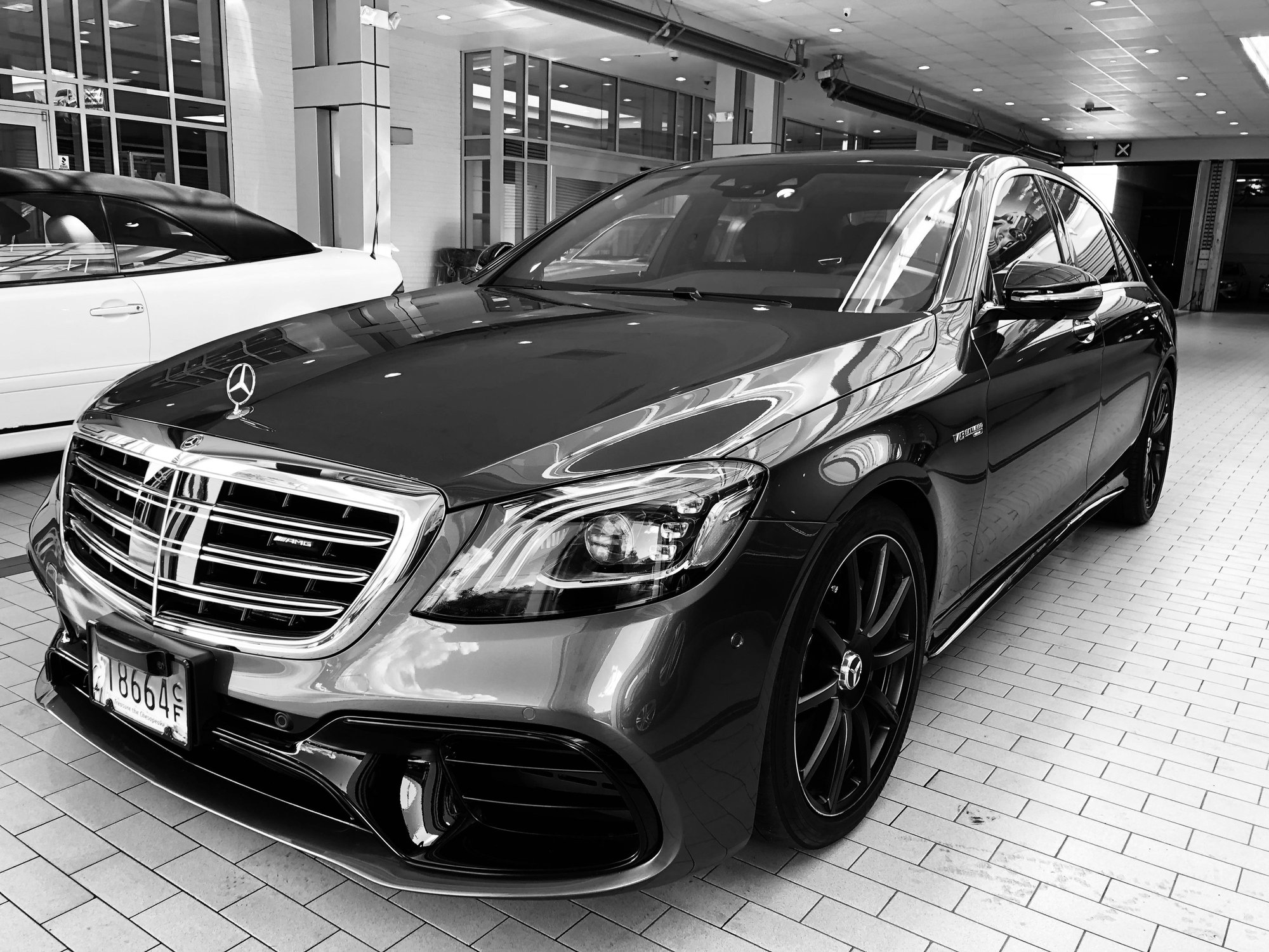

I have a 2018 S63, I don't drive it for months at a time, never, ever had an issue. Starts RIGHT UP.

Starts loud too I bet : ) nice car.
