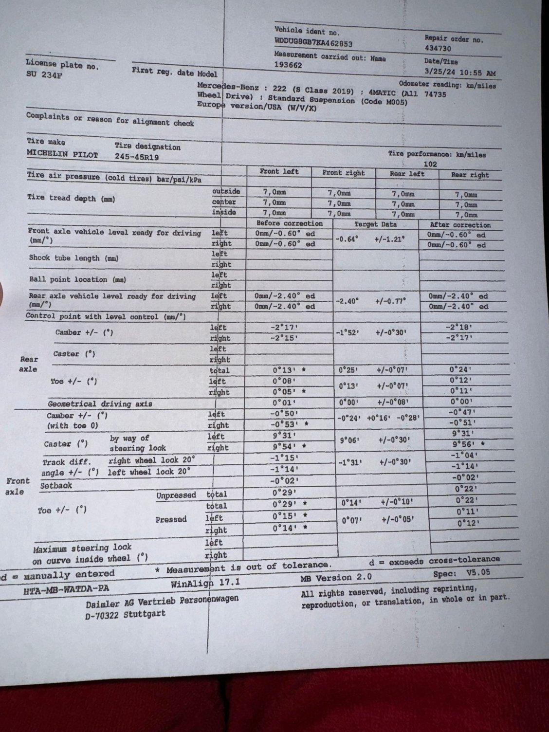

Here are my specs, before on the left, target in the middle, result on the right.
i did lower the car 9mm to a 15mm ride height and that was the issue with the wear.
first alignment since.

Lot of negative camber in the rear.

Even after adjustment.
so kmac is the fix for this?

K-mac kit # 502226-5M should do the trick.
It was MSRP around $595
2 choices for the 2019 are available... for rear camber adjustment if my memory is correct.
If your chassis series is W222......... this allows for up to 4 degrees of adjustment
Set your rear camber to ZERO it can.
trust but verify the correct part #, as I am not a KMAC expert or evangelist.
Just one with focus on safety & performance
I have seen and put quite a few on units for owners that wanted to stop buying $3,000 of tires prematurely,
not to mention the more better safety factors when these are installed,
