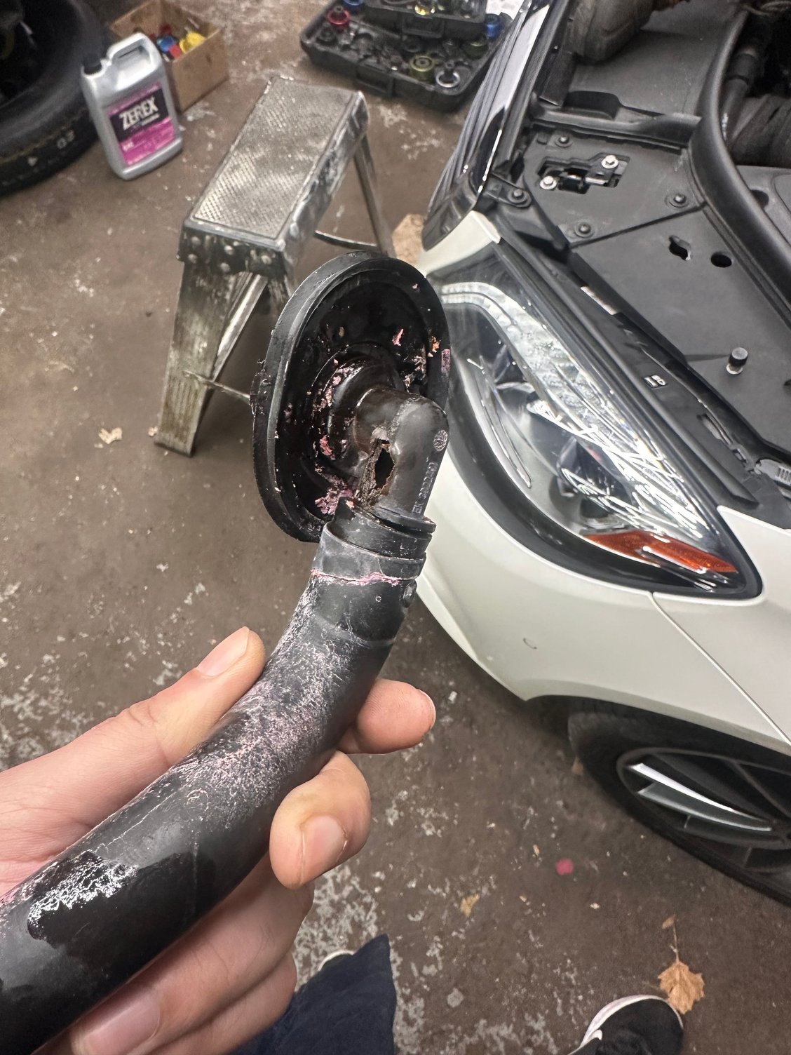

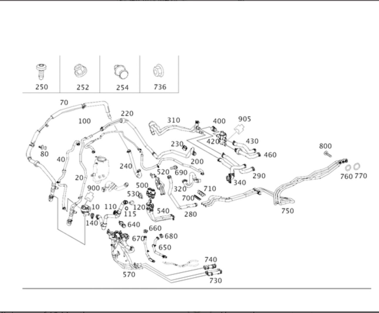

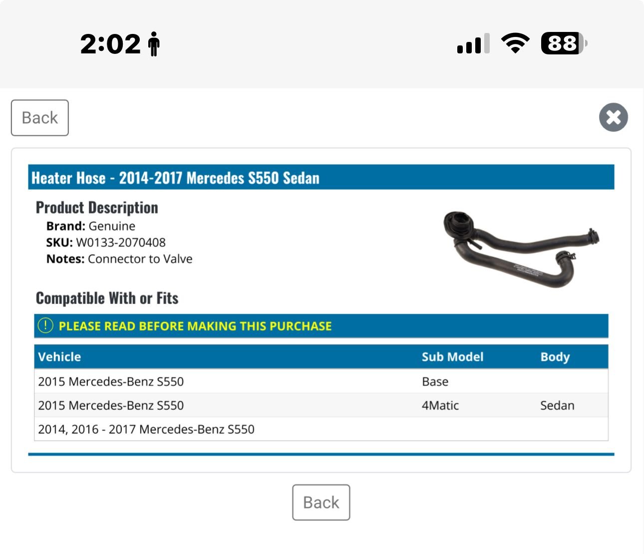

Here is what I know, there must be a COOLANT Hose going to the fire wall (second wall) behind that you will find a hoses u need to know which one is leaking.
ANS: its the main one that comes from the the engine. So just check if you need the back or the front
MB ONLINE diagram 340 or 320 not sure if i can link i will
Something like this:
its 1.5 hrs job need skinny hands
and re pressurize the coolant so better have some spare coolant G40
you should be good
COST. $200 estm
parts can cost you 60+ just worry about installing
the wiper blades dont come out. The bypass shield is there 2 bolts and it will pop out
