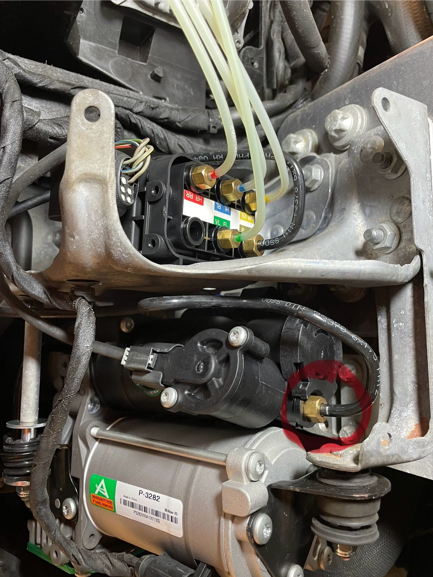

When I had a 2015 S550 I replaced the pump and air distribution block thing (can’t remember its exact name). From what I remember, circled in red is the air supply to the pump, follow it to above the wheel arch. Easy to access.
Thank you for your help NbyNW!
That’s help a lot!
