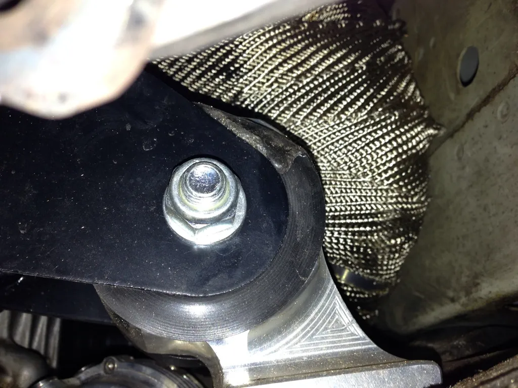

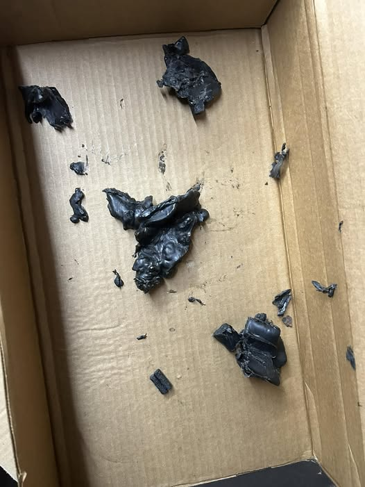

Originally Posted by JohnLane
I beg to differ RE: longevity of engine mounts in two models I owned.... 211 E-55. Mounts every 30,000 miles. Not because I enjoyed doing them; they had sagged to where the oil pan was mere millimeters from the sway bar. 221 S-65.... Engine mounts annually. Mounts in the 211 and 221 are similar design with the goo inside to absorb vibrations that failed early and often. Somehow my 2004 E-500 (211 with N/A five liter) never needed mounts in the four years I owned it. Perhaps they fail due to big power? I have never been one to spare the horses.
I don't disagree with your experience, but I see a LOT of cars, although you've seen a LOT of mounts so we'll meet in the middle.
Did you always live in Phoenix? Do you think its a heat issue?
I'm based in a mediterrean-ish climate here in San Jose so I have the luxury of not seeing the more extreme repair cases. The rubber bellow below the mount is fairly soft and I can see it melting with exposure to heat. It doesn't help that MB underhood temps are what they are either if what I'm thinking is correct, so the S65 chowing down on them routinely is probably par for the course. I don't think parts selection is suspect since I trust Corteco/Lem/MBG to be all worth replacements.
Here's some pictures of some melted rubber engine mounts. The polyurethane stuff has less tolerance for heat. I can't imagine the hydraulic ones love heat either. It gets to 100 for a couple days here a year maybe. The C63's with LTH's will melt them too

The E-55 and 221 S-65 were both in Washington for all of the engine mount replacements. Winter to 10 degrees... summer mostly in 80s.
The 222 S-65 has lived with me here in the valley of the sun. 110 is ambient for 4-6 months of the year. The 222 car has not needed mounts yet; but they are of a different design then were used in previous cars.
I’ve seen many mounts fail as you describe in photos above. I never let them get that bad in my cars.
I can't even tell that is a mount anymore, wow. It is almost like it been through hell or fire and therefore was burnt.
Old Jun 8, 2025 | 05:47 AM
  #44
JohnLane's Avatar
Joined: Feb 2012
Posts: 2,611
Likes: 1,209
From: Phoenix
222 S-65
An oil leak will hasten failure. I’ve seen a number of them like that through the years. Go to disassemble and they fall apart.
Old Jun 8, 2025 | 06:26 AM
  #45
W205C43PFL's Avatar
Posts: 32,222
Likes: 6,281
Yes that makes sense, the oil that leaked disintegrated the rubber. Sort of how it did with the vacuum check valve: https://mbworld.org/forums/w212-amg/...ve-repair.html
