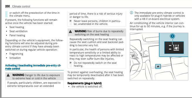

Just an educated guess, but it might be the "pre-entry climate control." Do you have this feature/button on your center console? (it also in the settings menu of course). See attached pic

Oct 30, 2022 | 11:24 AM
Quote: Just an educated guess, but it might be the "pre-entry climate control." Do you have this feature/button on your center console? (it also in the settings menu of course). See attached pic
That button I believe is only for the Plug-In models.
Reply 0
Oct 30, 2022 | 12:32 PM
Quote: That button I believe is only for the Plug-In models.
Should be for EQ Boost (48 V battery cars) and EQ Power models (plugin hybrid).
Reply 0
Explore
Oct 30, 2022 | 12:55 PM
Quote: Should be for EQ Boost (48 V battery cars) and EQ Power models (plugin hybrid).
But not standard, at least not on the EQ Boost (48 V battery cars).
Reply 0
Oct 30, 2022 | 02:18 PM
Quote: But not standard, at least not on the EQ Boost (48 V battery cars).
I see, odd though as I cannot see it as any option in the European price list. Standard on the plug-in hybrid.
Reply 0
Nov 1, 2022 | 09:16 AM
I don't think I have this button in the car, I'll check when I get in it today.. Strange how this only happens when its cold, anyone else have this same noise ?
