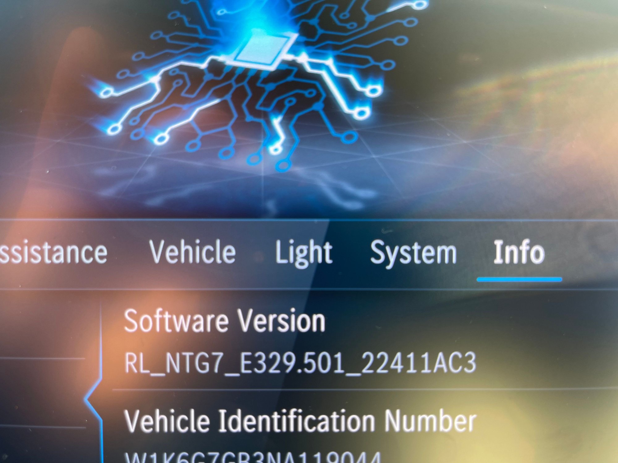

System info/ Version is _E250 Needs upgrade to _316

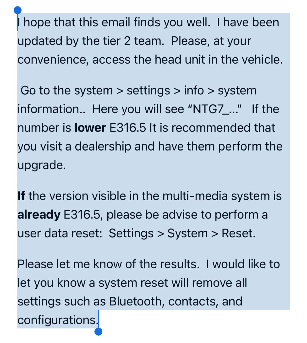

hi, I have S580 2022, the following is an email I have received from Mercedes me connect Support team, I hope this is the fix, will keep you informed.
* go to settings then Info then System information *

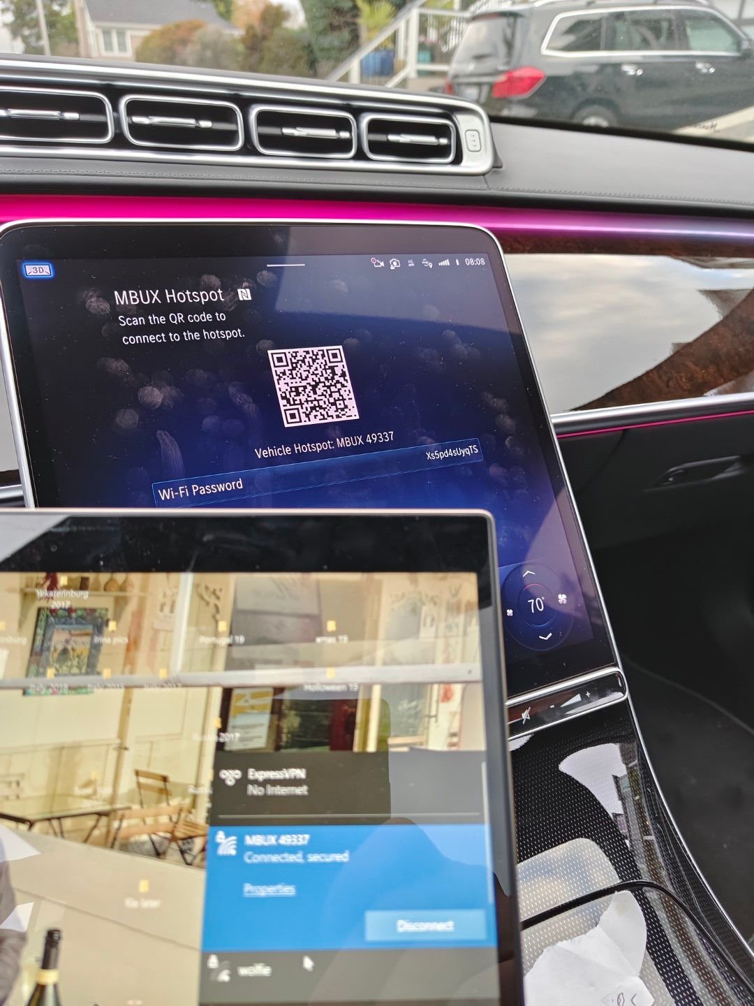

Hotspot Fixed after updating the system
