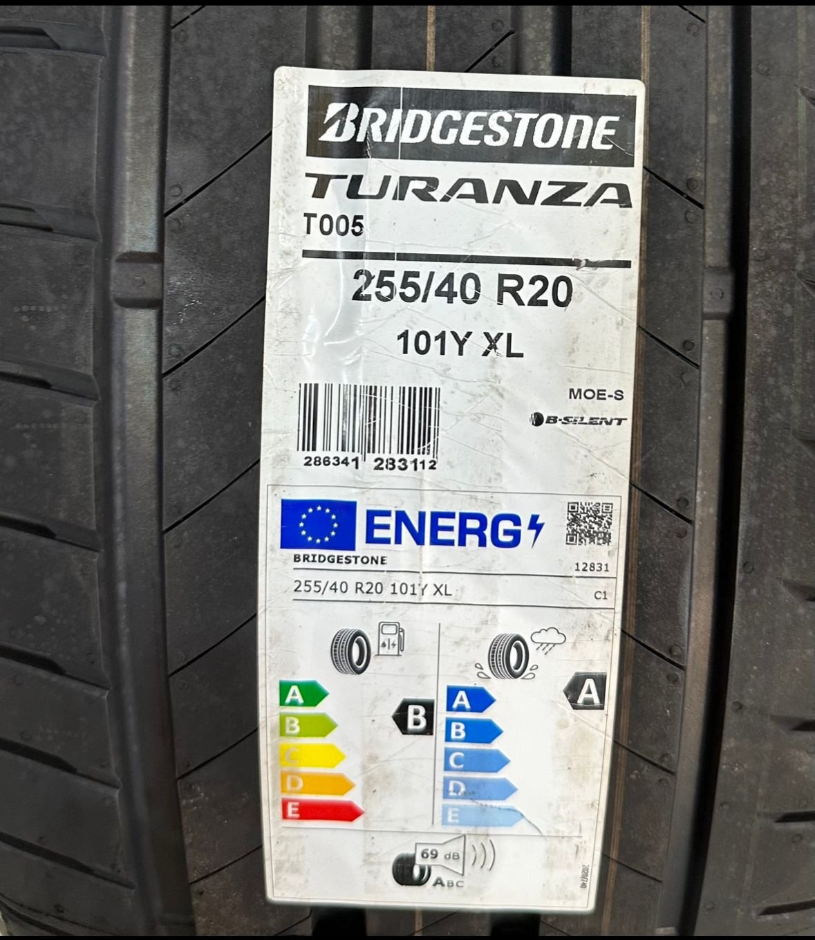

To be clear on the RWS issue:
the issue is the width of the rear wheels not the diameter. 255 millimeter rear tires work for full 10 degree, while 285 millimeter limit you to 4.5. I do not know how much extra/room for error is in any of those.
In the US, there are three AMG like 20 inch wheels that have been offered, RVR, RVP, and RVQ. All of those, like the 21 inch wheels, have the wider 10 J x 20 rear wheels on 285 width rear tires. In other markets, though I don’t know the codes, there are similar wheels offered with the thinner 9 J x 20 wheels on 255 tires, and those work on 10 degree rear steering. That’s the real thing to worry about, though, wheel and tire width.
In the US and other markets, all 19 inch wheel options I clouding the AMG wheel, as well as most of not all 20 inch non AMG line wheels should have the thin rear tire and allow 10 degree rear steering.
Reply 2
@Sonic Boom can u please verify, given u actually have the 10deg with the 20" amg wheels...
Quote: Yes. I was just about to correct the previous posters. I did A LOT of research on this issue before I chose:
-for 10⁰ RWS you can go up to and including 20” wheels.
-if you go with the 21” (AMG?) wheels then you’re restricted to 4.5⁰
Personally I prefer to have 10⁰ much more than to have 21” wheels. So it’s a matter of preference: more RWS or larger wheels.
For me it was a no brainer. I’ve posted endlessly on the merits/benefits of 10⁰ as opposed to just 4.5⁰. The difference is amazing!
PS
My 20” wheels are AMG: code RVU AMG multi-spoke alloy wheels with 10⁰ steering code 216.

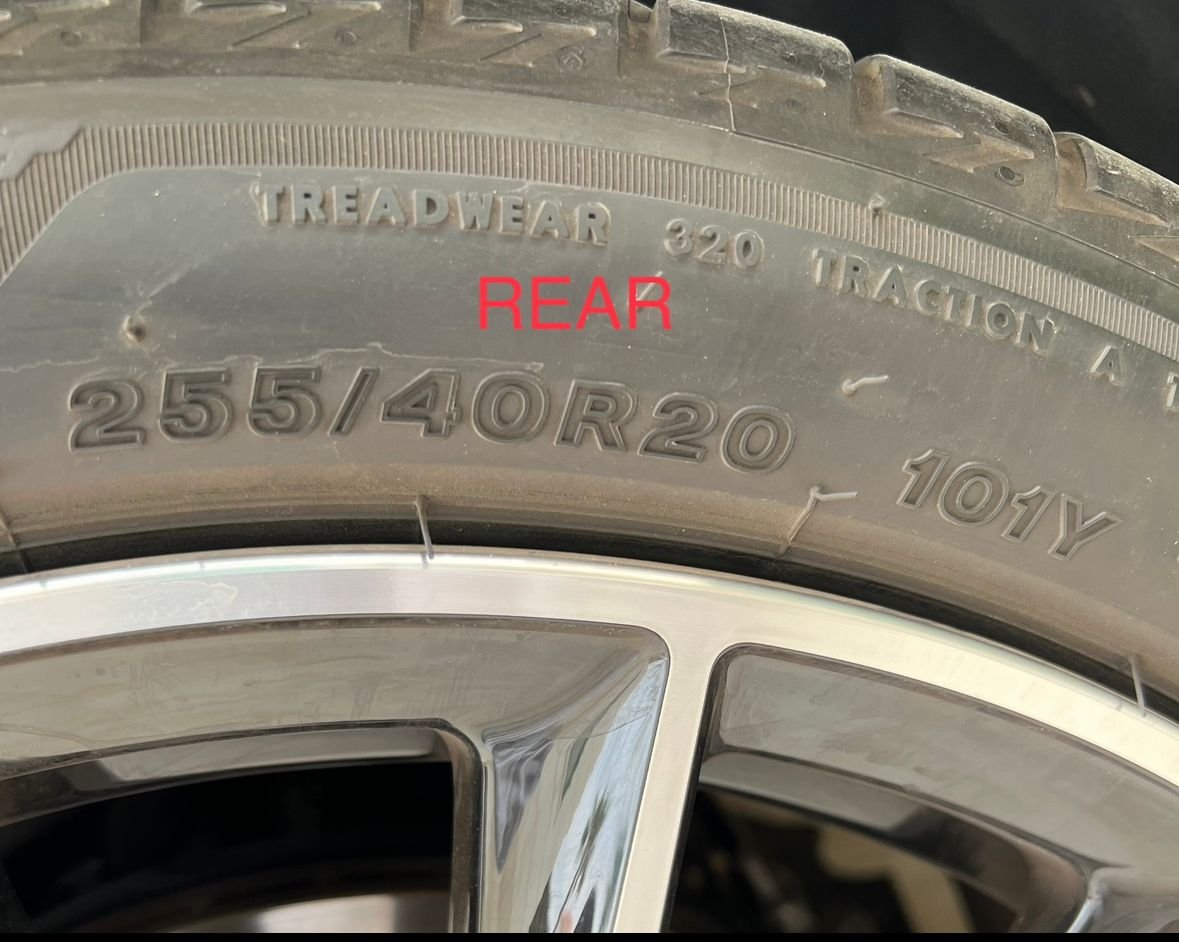

Quote: @Sonic Boom can u please verify, given u actually have the 10deg with the 20" amg wheels...
Hi, does the attached help?
Reply 0

Quote: Hi, does the attached help?
do you know the other 20 inch wheel possible codes? I only have the USA and Canada ordering guides which only give wheels that are offered in their two countries, so no RVU or other wheel options. If you have an ordering guide for your country that would be very nice
Reply 0
indeed, thanks!
​​​​per @BenjaminKohl looks like ur rear is amg 20x9.
my rear tire here in the US is a 285... which probably means the amg wheel is 20x10.
damn
