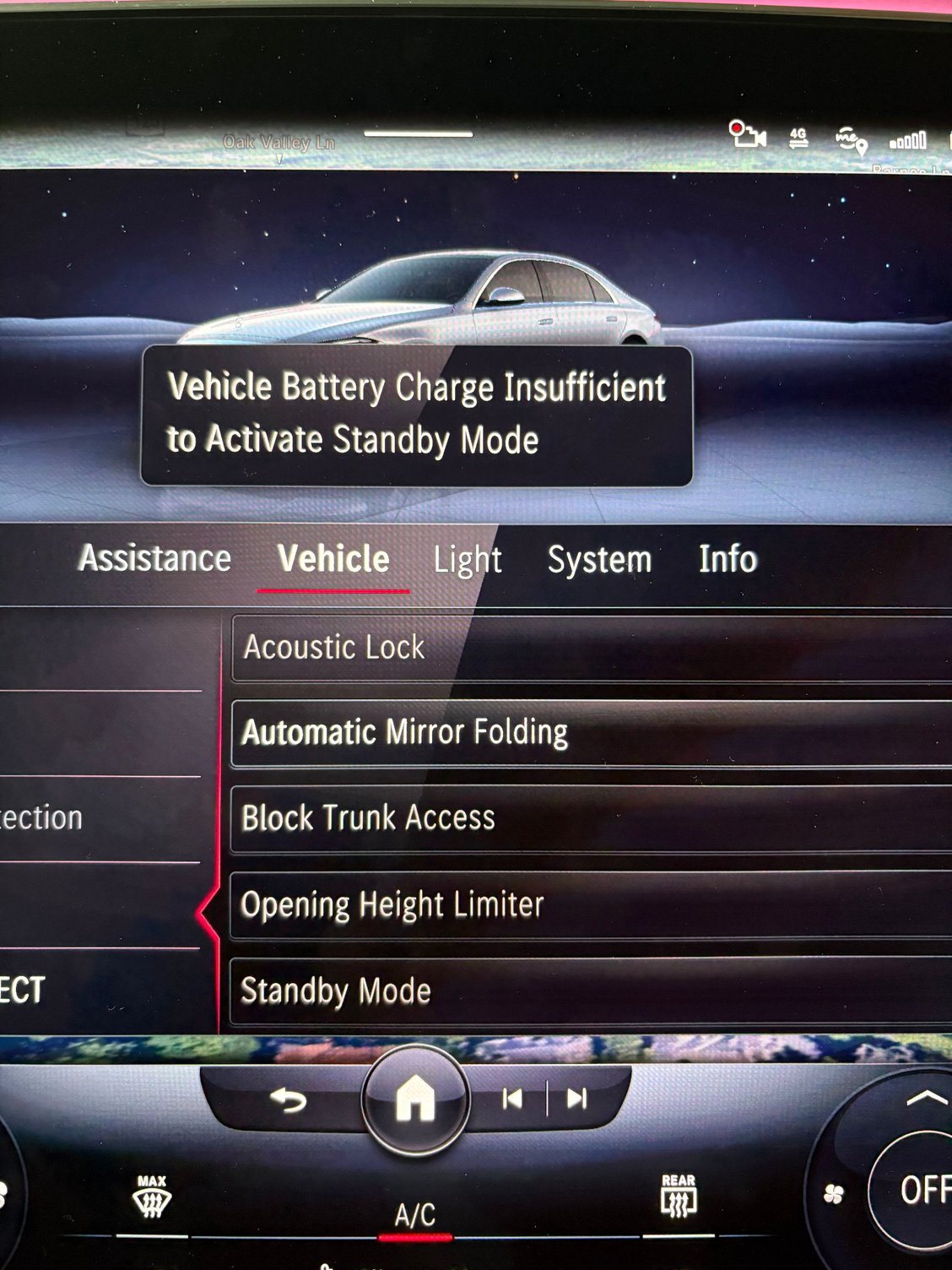

standby mode problem
any owners run into standby mode not coming up and getting this message, even when battery is fully charged (at least that's what the mobile app states)?

Every time I have tried to use it. Hopefully someone has overcome this issue and can report.

Last week I drove approximately 130 miles at speeds from 65-85 mph and I still get that message. Shortly after purchase (2024 S580) I could get it to say I could have 5-6 weeks in standby mode but that was months ago. Lately it has been the above message all the time even as you said with the battery fully charged. I bought a Faraday box to keep the fobs in but that has not made a difference. I have no had my first maintenance appointment yet. I will mention this and maybe something will be found.

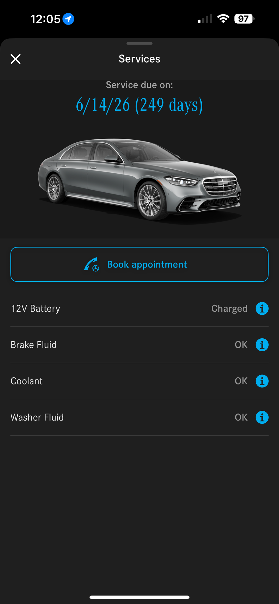

Try checking the battery health in the Mercedes Me app
u mean this?
if so...ya... still doesn't allow standby mode🤦🏼‍♂️

Originally Posted by tonupbklyn
u mean this?
This https://mbworld.org/forums/c-class-w...ml#post9169443
but... See if this helps https://mbworld.org/forums/c-class-w...ode-issue.html
https://mbworld.org/forums/c-class-w...operative.html
