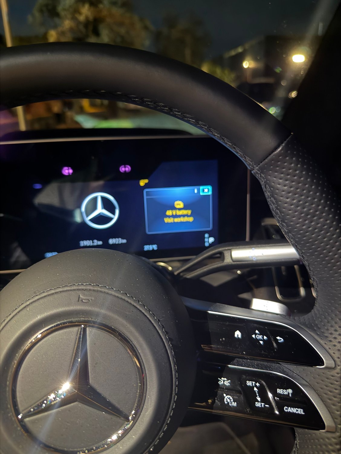

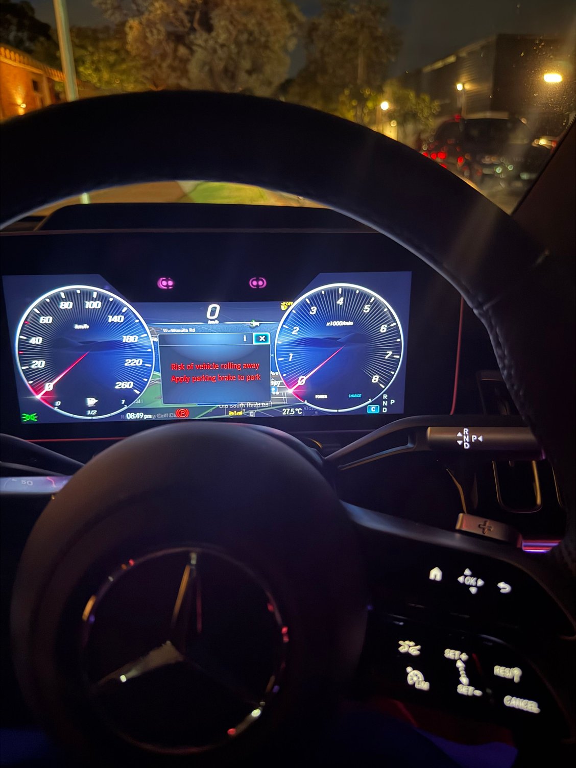

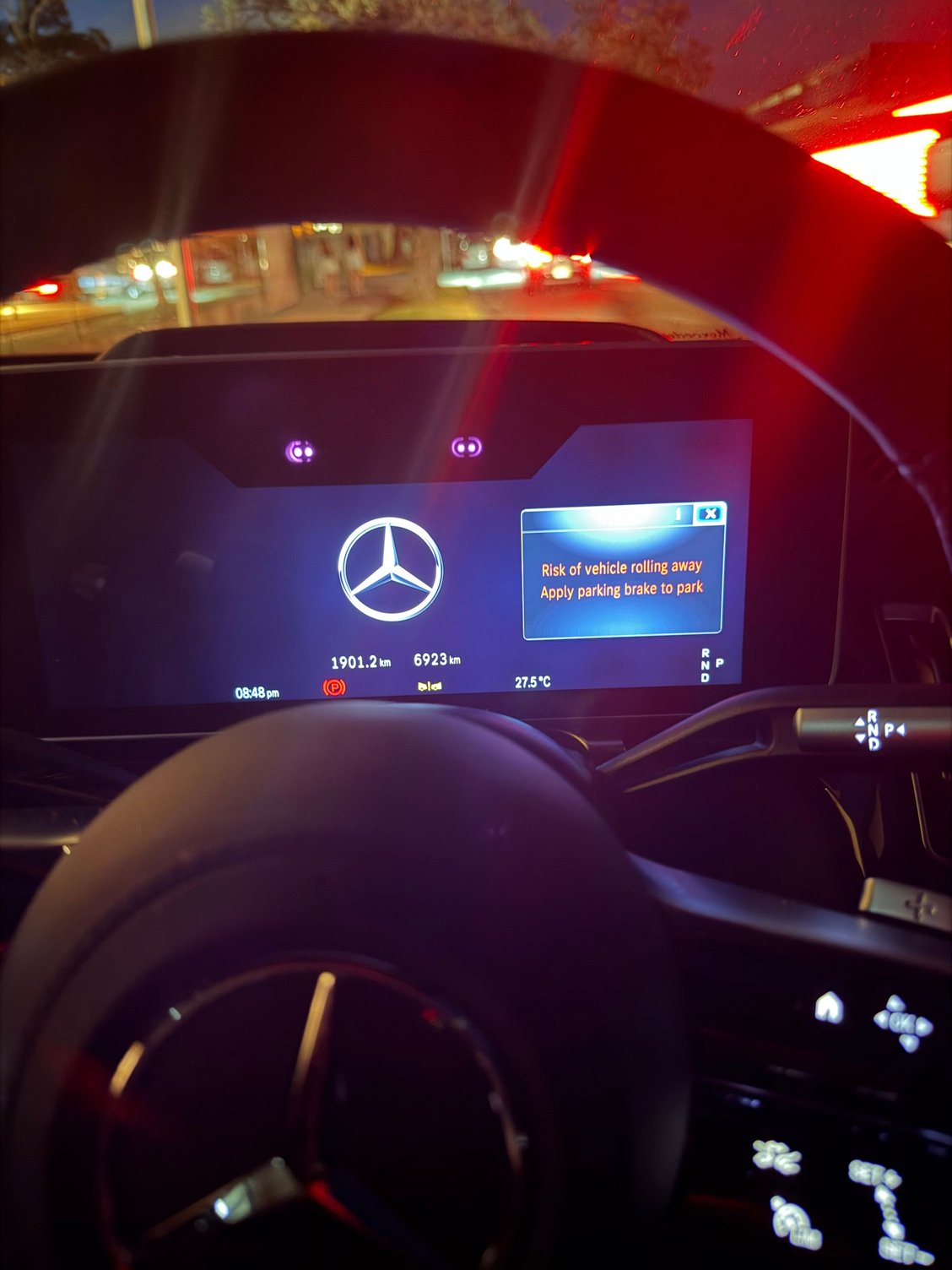

Finally getting some screen messages. Also consistently the shift park indicator is blank until it reappears car won’t start or run
Finally a 48v message

• Fault is intermittent overall, but reliably triggered when both rear wheels drop into a road rut; it can also occur randomly at other times.
• When it occurs, the car shows 48 V warnings, loses Park indication, and disables cruise control and driver assistance (limp / no-accessory mode).
• The condition is temporary and resettable with a full stop + door open + lock/unlock + restart, after which all systems return.
• Pattern strongly suggests a loose or marginal electrical connection / earth / loom, likely involving the 48 V system, rather than a pure software issue.
