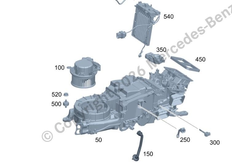

The rear HVAC is a complete separate HVAC system for the rear seat, not just remote control for the front HVAC. Here a parts diagram photo of the HVAC box, I should have searched for a better illustration of the parts (heating/cooling lines, air ducts etc.) but had not time.
Thank you for the information.
Wow, that's a whole another unit right there.
