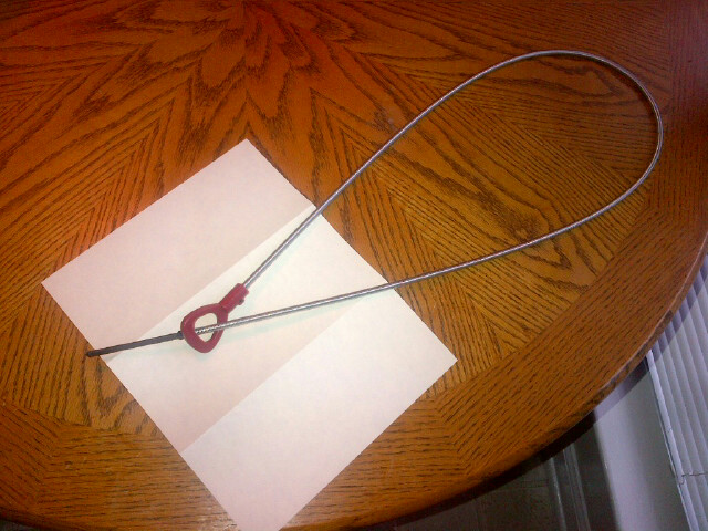

Hi Mike, any chance you can share a pic of the dipstick for the Tranny on the S55 you used to get the right level for the fluid? I have the dipstick but unsure whats the proper level it should be at

Sure ill get a pic, or at least measure the depth from the bottom on the universal dipstick...ill get that info tonight while in may garage and post assp.

Thanks Mike , I had purchased the Tranny dipstick long ago when I had an E class, so its the same one for our S55's 5 speed with the same part#.
I appreciate you taking the time out to snap a pic of it. Do you still have the marker on the dipstick where it should be at approximately for proper level of the fluid?

My S55 was cold and the dipstick bottoms out and the fluid is just barely on the stick...just below the 25 degree mark...like 1/2 inch on the stick. Engine cold and running...prior to startup it was above the 80 degrees mark on the stick.
