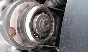

This morning I started my car and started hearing a awful squeaky noise. I looked under the hood and noticed the snap ring that holds the bearing inside the supercharger pulley was missing, I can see the actual ball bearings, and there was dark grey grease oozing out.
My Questions:
1. where do I buy the snap ring? I found the bearings but they don't come with replacement rings.
2. Or what size snap ring do I need if I go through "Grainger" snap rings company?
3. How safe is it to drive less than a mile a day?
Please help I have searched and could not find any out there or the size specification to buy a GRAINGER brand snap ring. Also I have until March 31st to fix this issue because I drove 800 miles from FT Hood, TX to FT Benning, GA for school and have to report back.

you can resue the snap ring / c clip
you can drive for a couple of miles without any problem.

I am pretty sure I didn't see the c clip and I think it either broke or is missing. I just ordered the Nachi bearing. Still trying to find a snap ring or someone know what size snap ring I can order one from GRAINGER

clean the grease off and you will see it

ordered the bearing, found the c clip still in place it was just covered in grease, this post is completely answered now...thanks

If you have not already, I suggest removing the supercharger belt until you have replaced the bearing. The car will feel fine under low load. Just don't race anybody

Be very careful when pressing the new bearing in and make sure pressure is only applied to the outer ring. Pressure on the inner race , seal or bearings will result in early failure.
