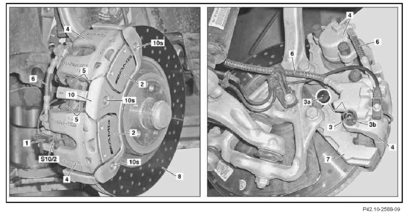

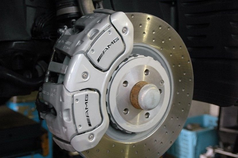

Thanks Plutoe! I think the instructions are the ones for the S550/S350.
The S63/S65 came with the twin caliper ones like the below. Would you have the instructions for these? Thanks in advance.

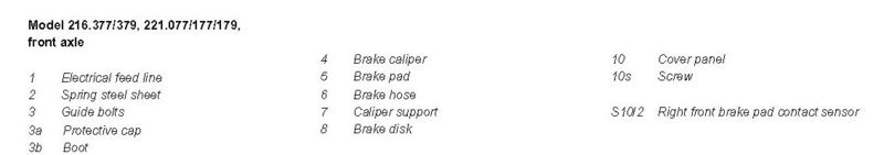

HTH
Anybody has DIY instructions for S63 Brake replacement-148062348_zpsuwzourca.jpeg

Life saver!!
Thanks Guys! appreciate all the help. easier than i thought!
