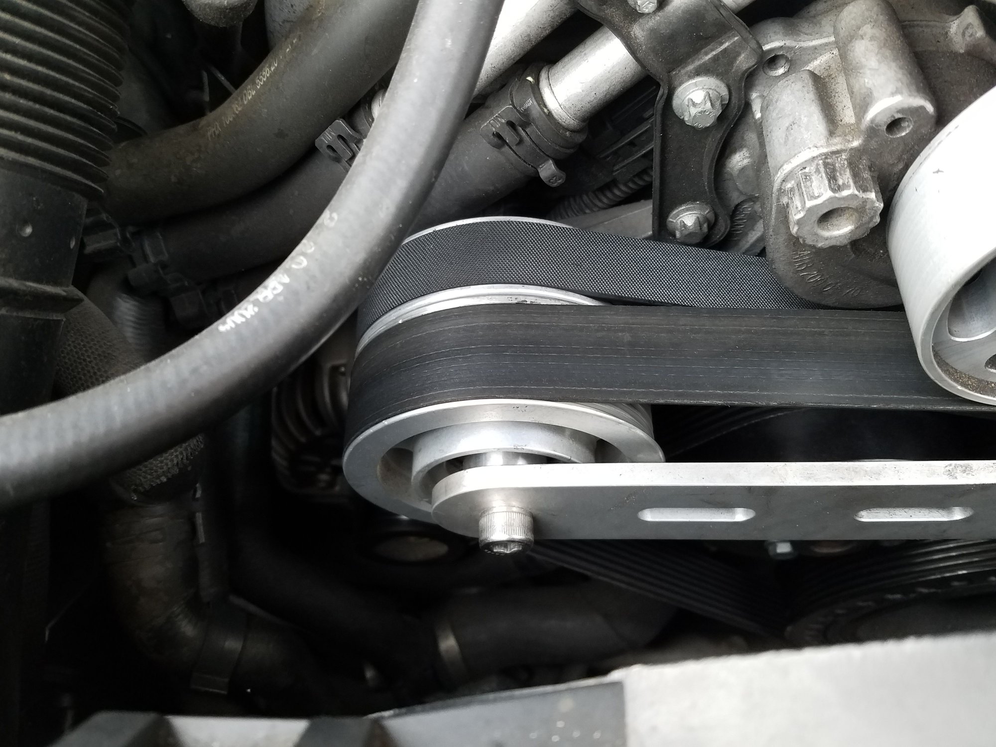

I replaced most of the pulley with aluminum ones. So far so good. I went thru 2 plastic double idler pulley before getting the aluminum.

2004 CLK 500

E-Class
I can't tell for sure if it does. Might have to ask one of the vendors about that, but I do know that it allows me peace of mind when I step on the throttle that my belt wont slip with all my mods on it.
While you're in the area, might as well check all the pulleys.

Ive also changed all my pulleys out for metal but not aftermarket aluminum like Sako......mine are all stock "look" and size....I just cross referenced multiple pulleys and found exact matches for the stock pulleys and idlers.....like Sako said...now zero worries about exploding plastic tensioner pulleys...cheap insurance
