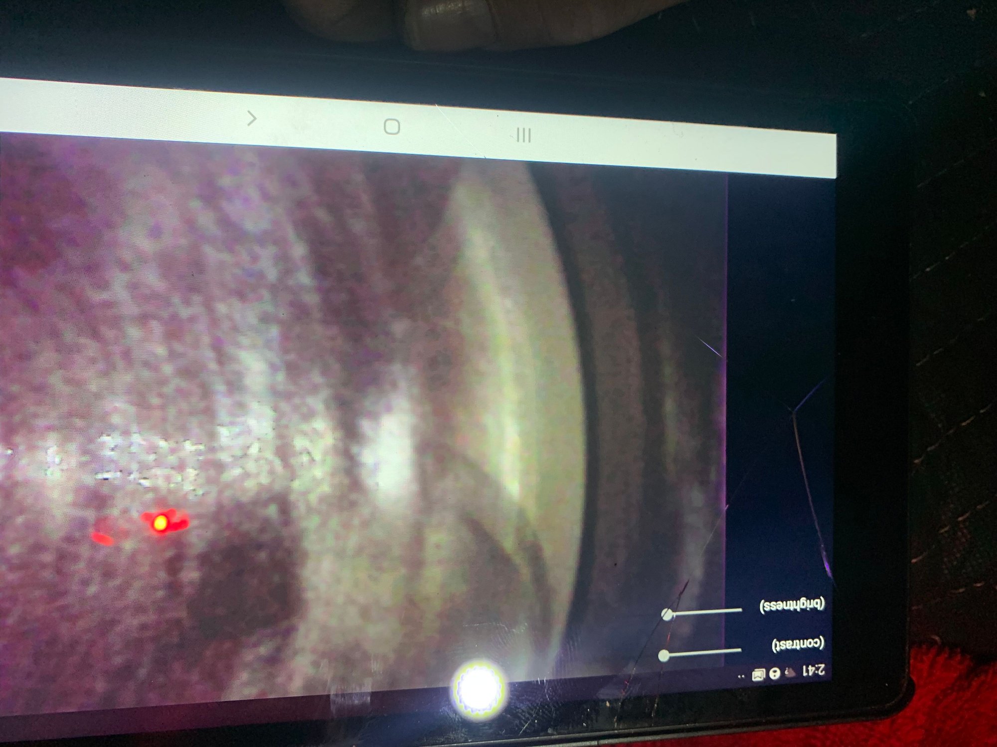

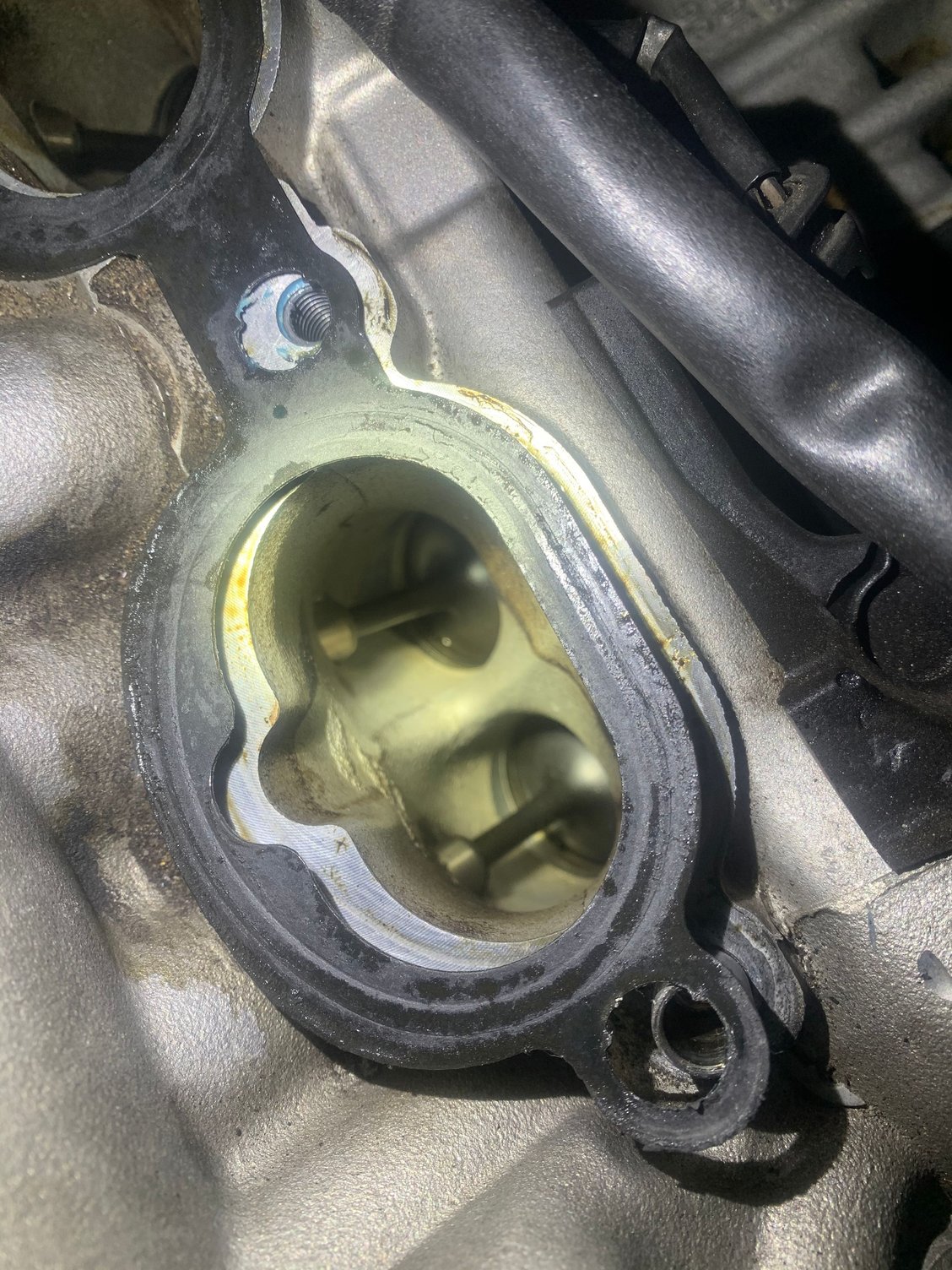

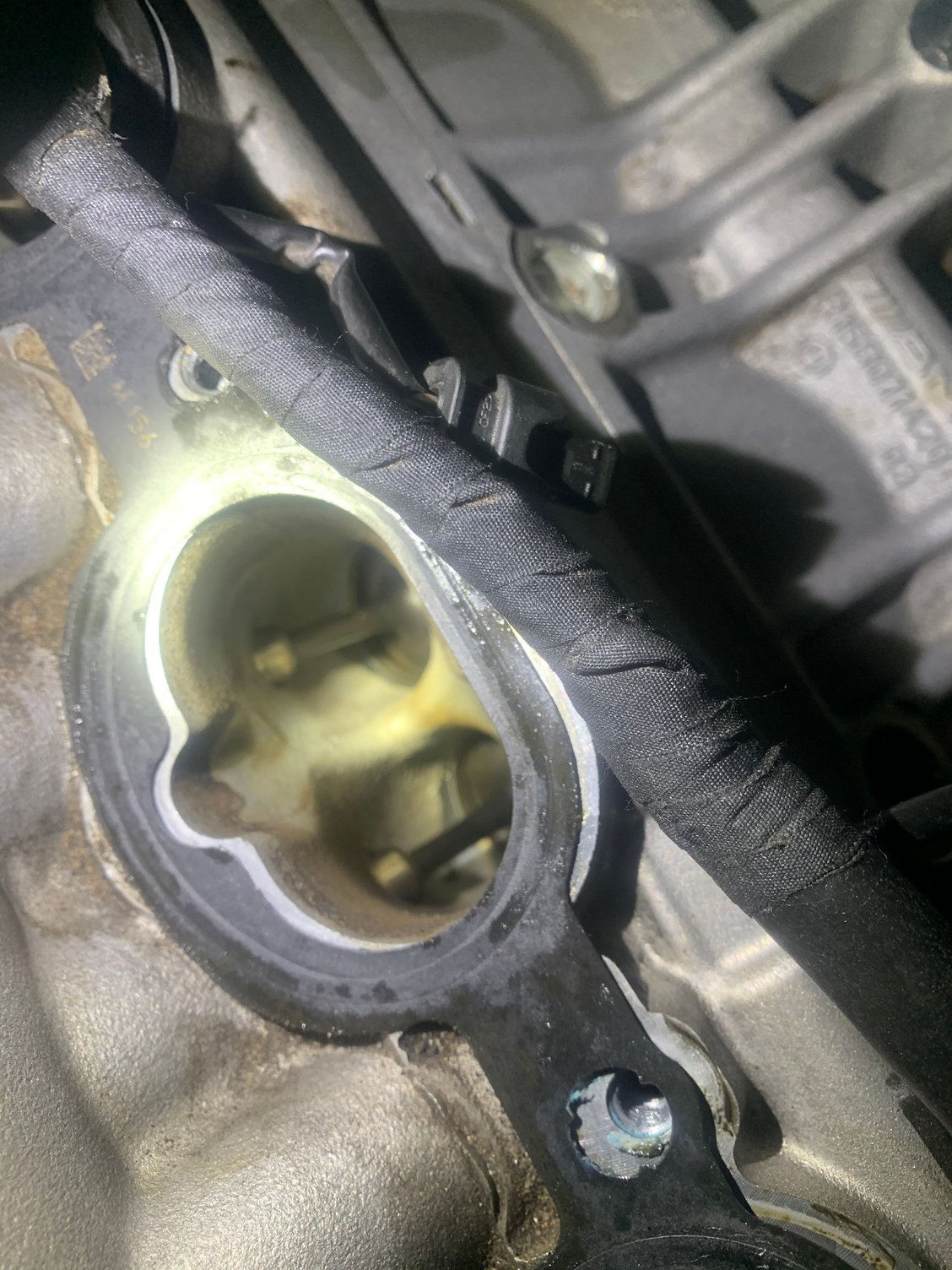

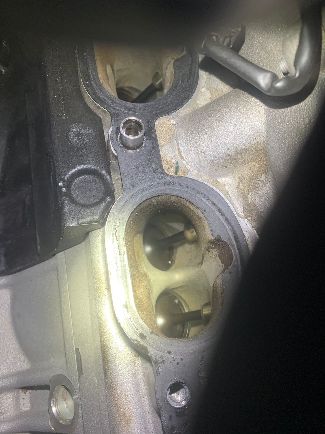

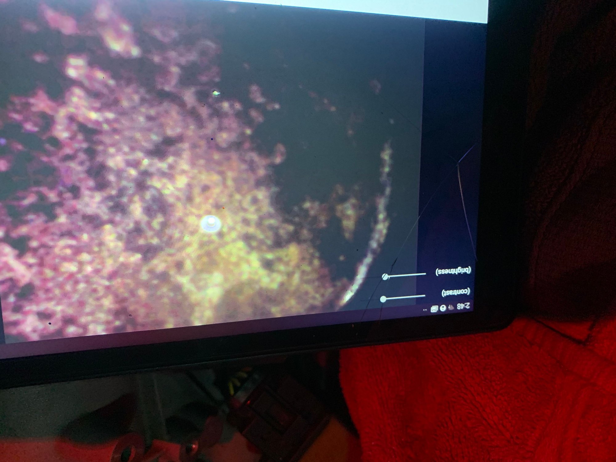

UPDATE!!! Hydrolock Stuck Injector

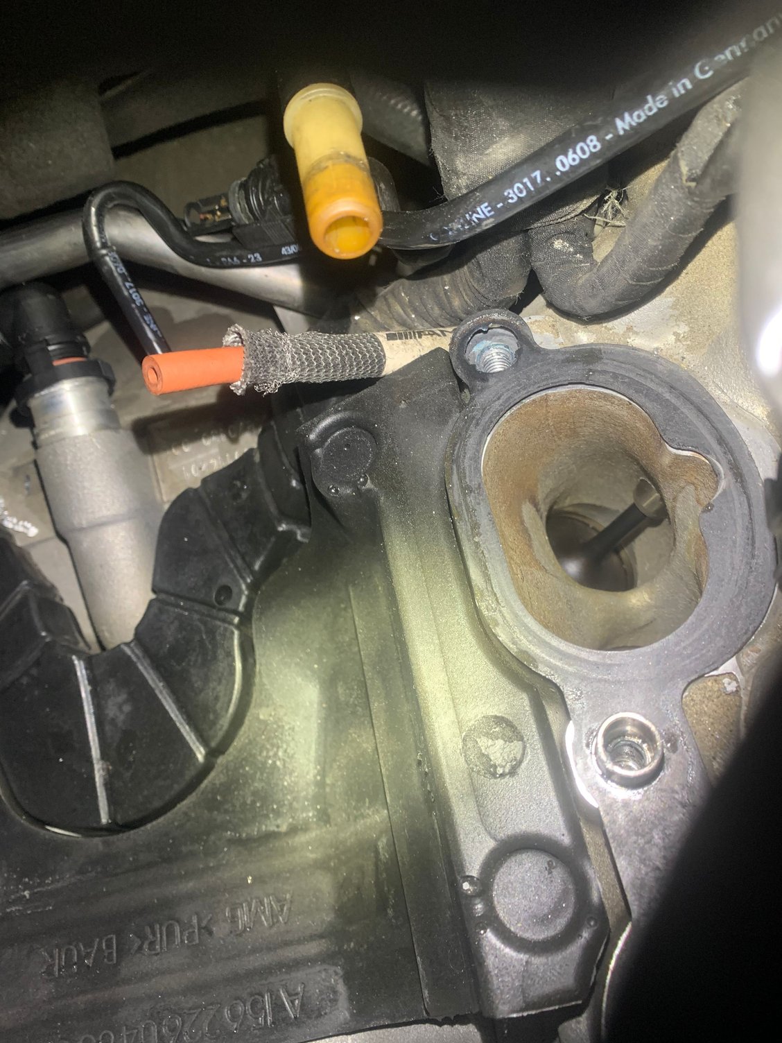

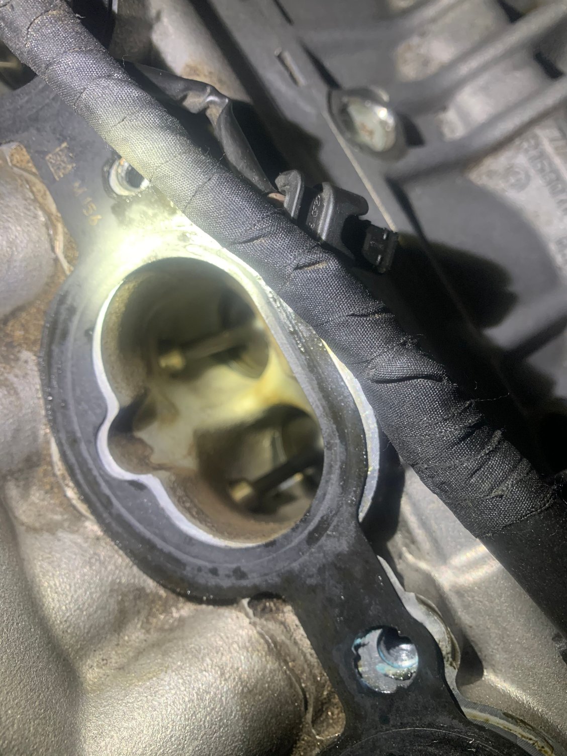

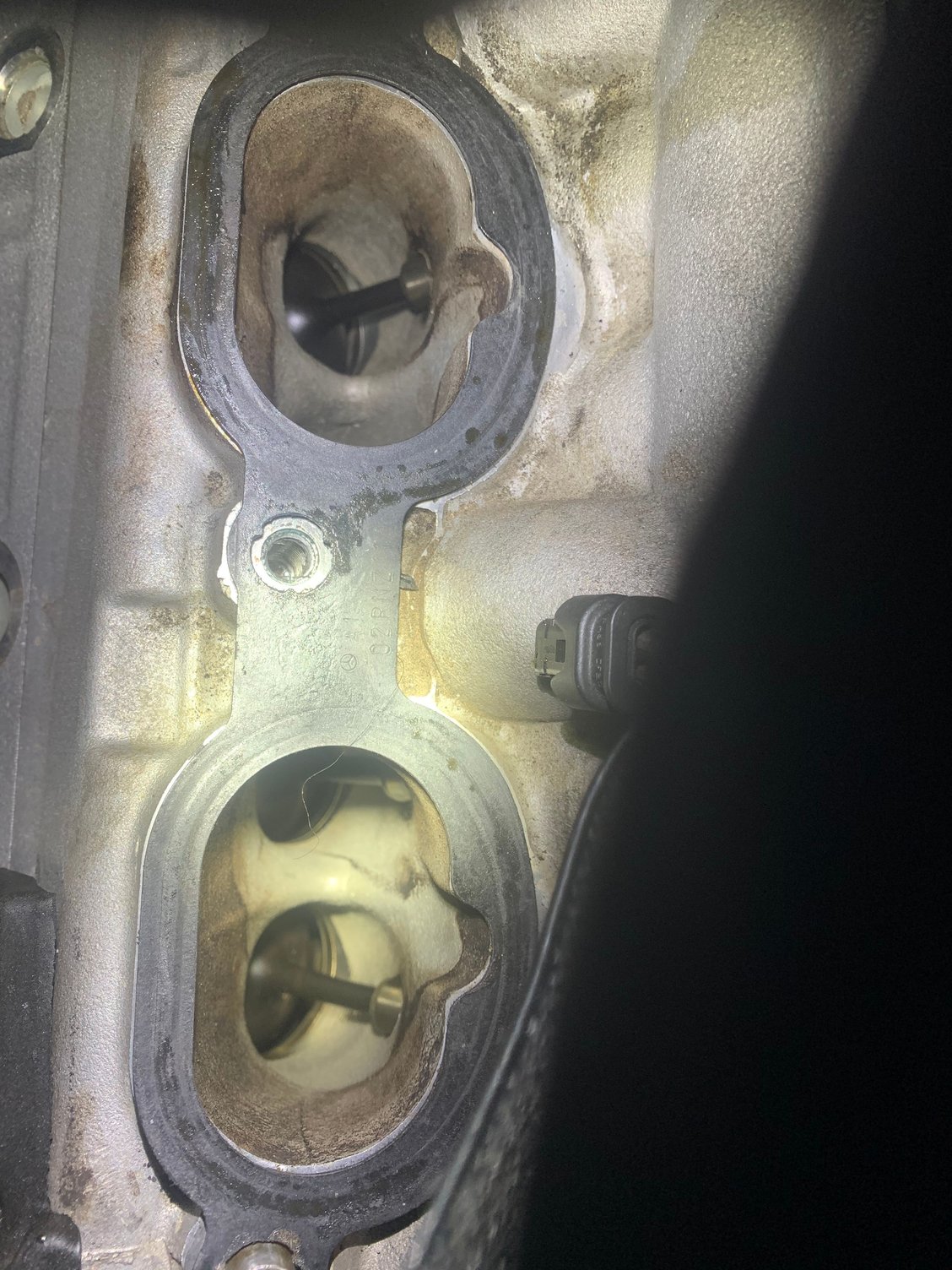

Here’s a picture of the valves they all look into it in working order. I placed an order from numbers #1-8 and #5 & #6 are pictured together.

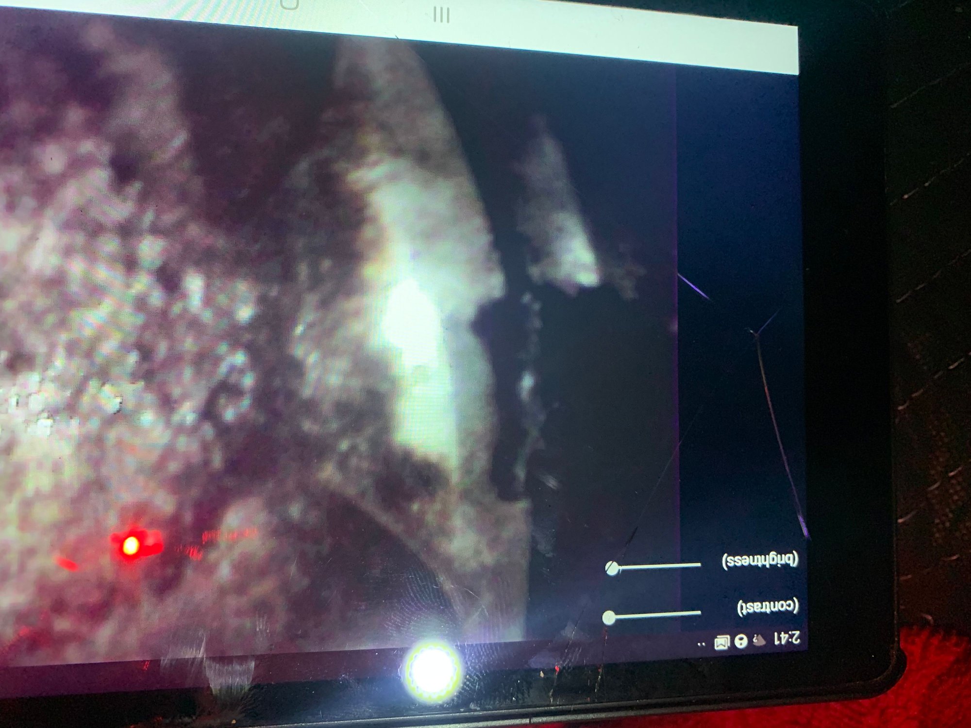

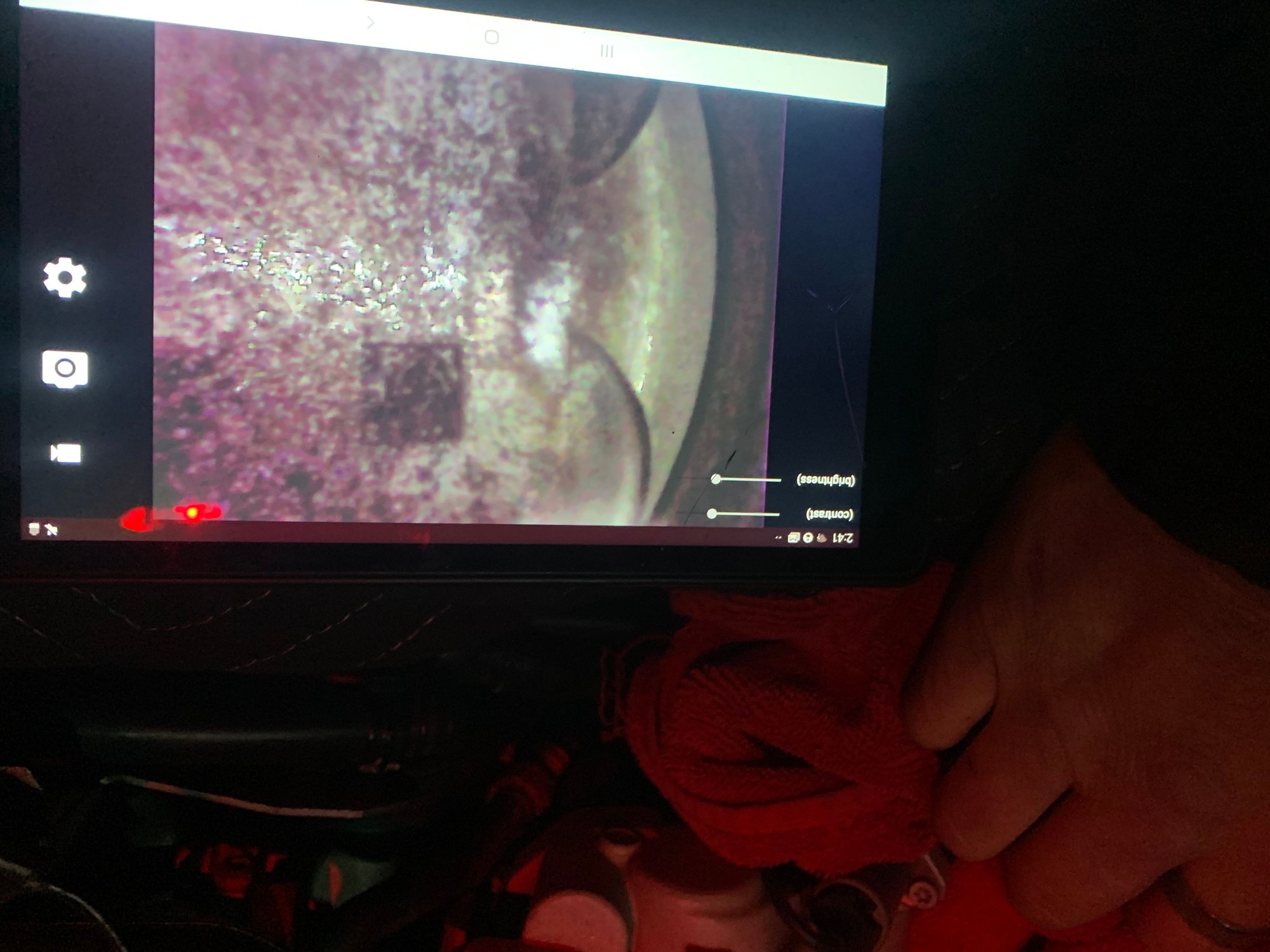

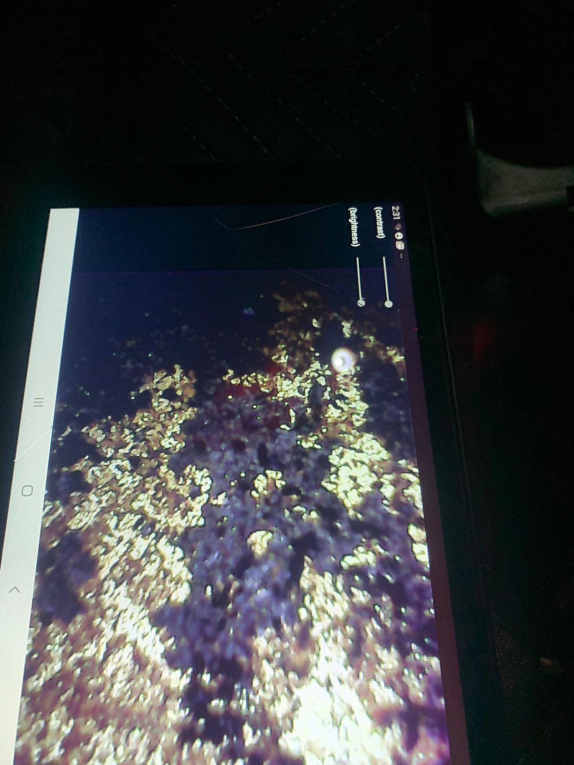

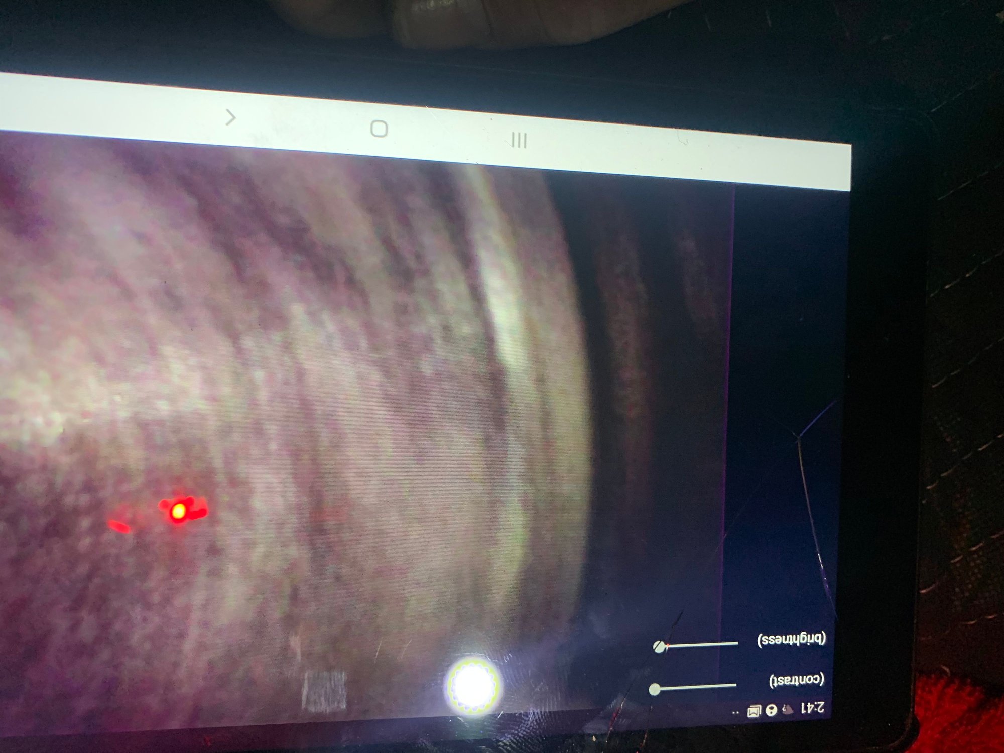

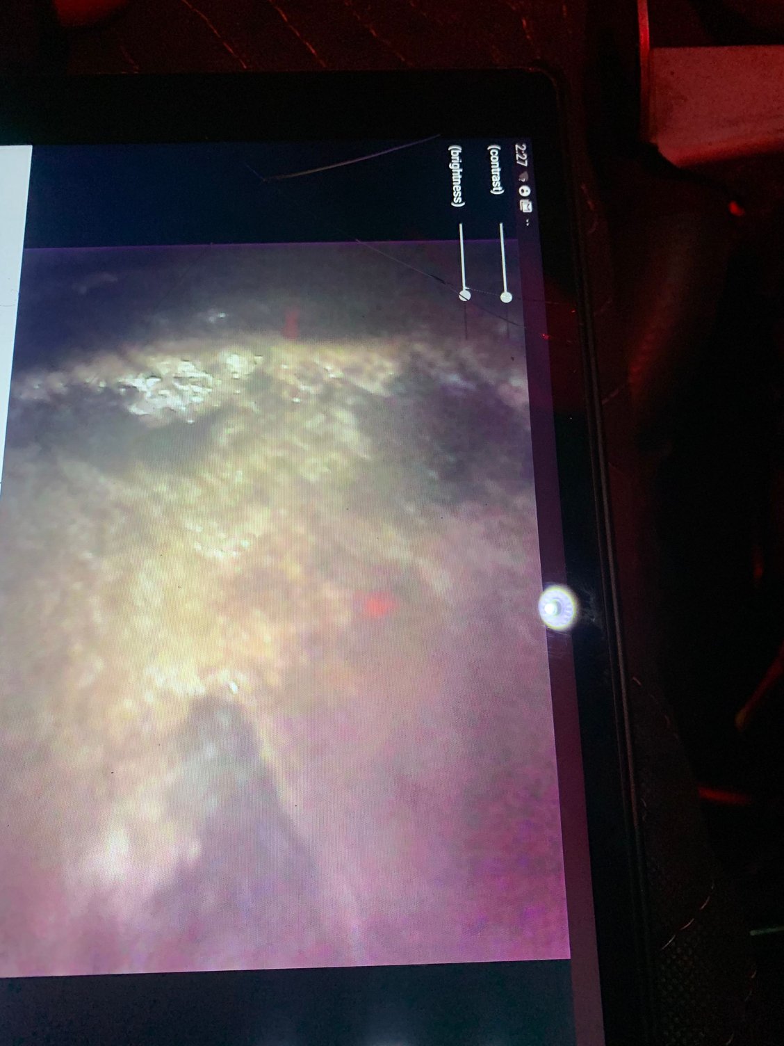

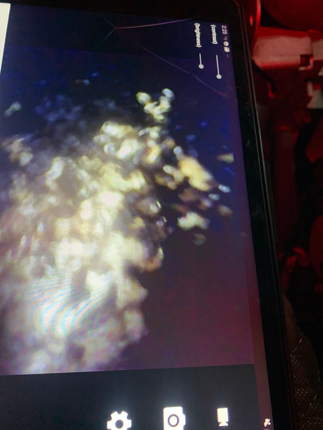

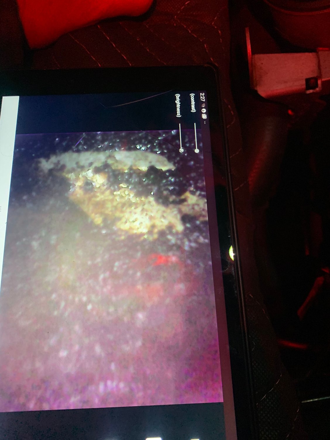

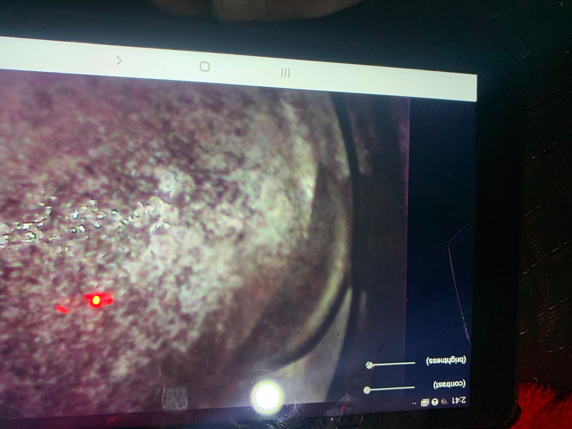

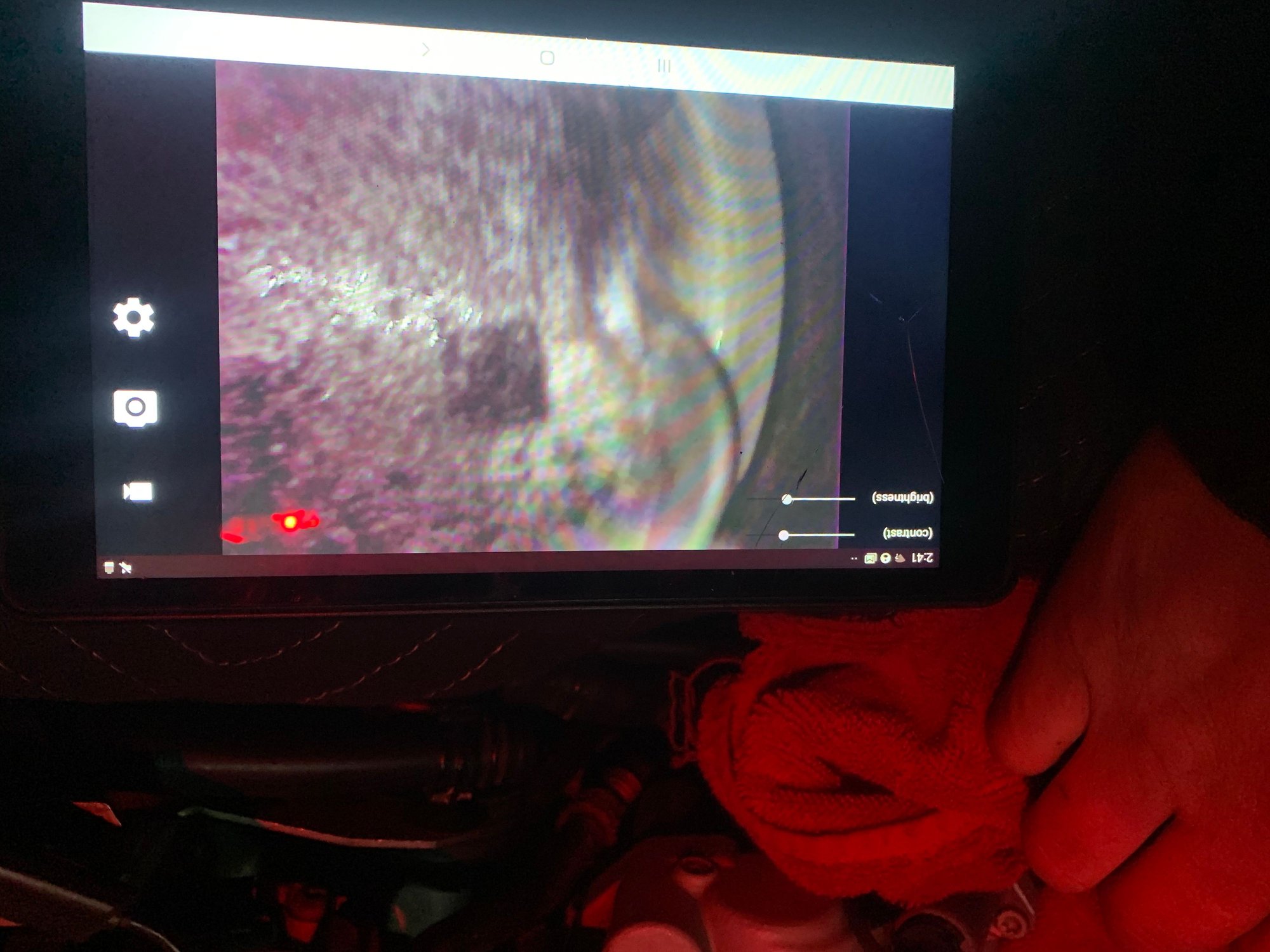

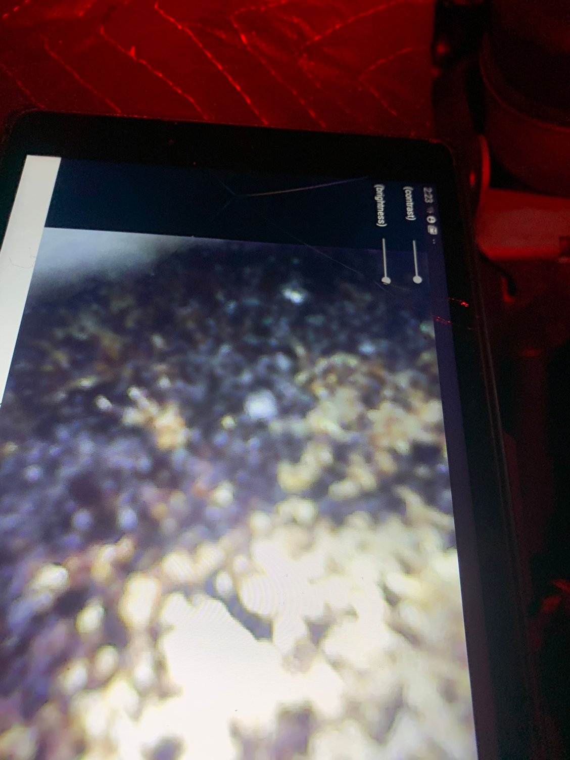

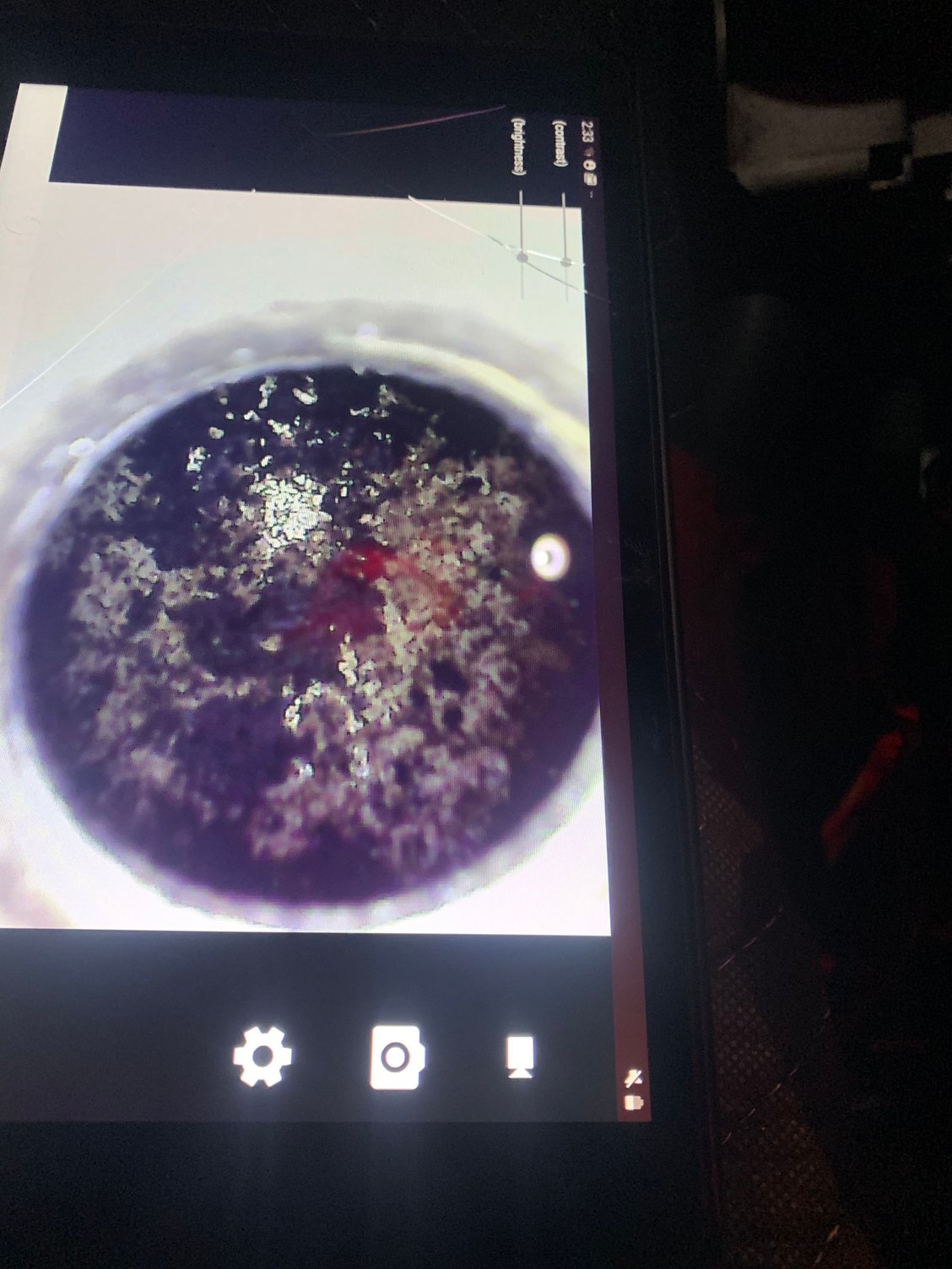

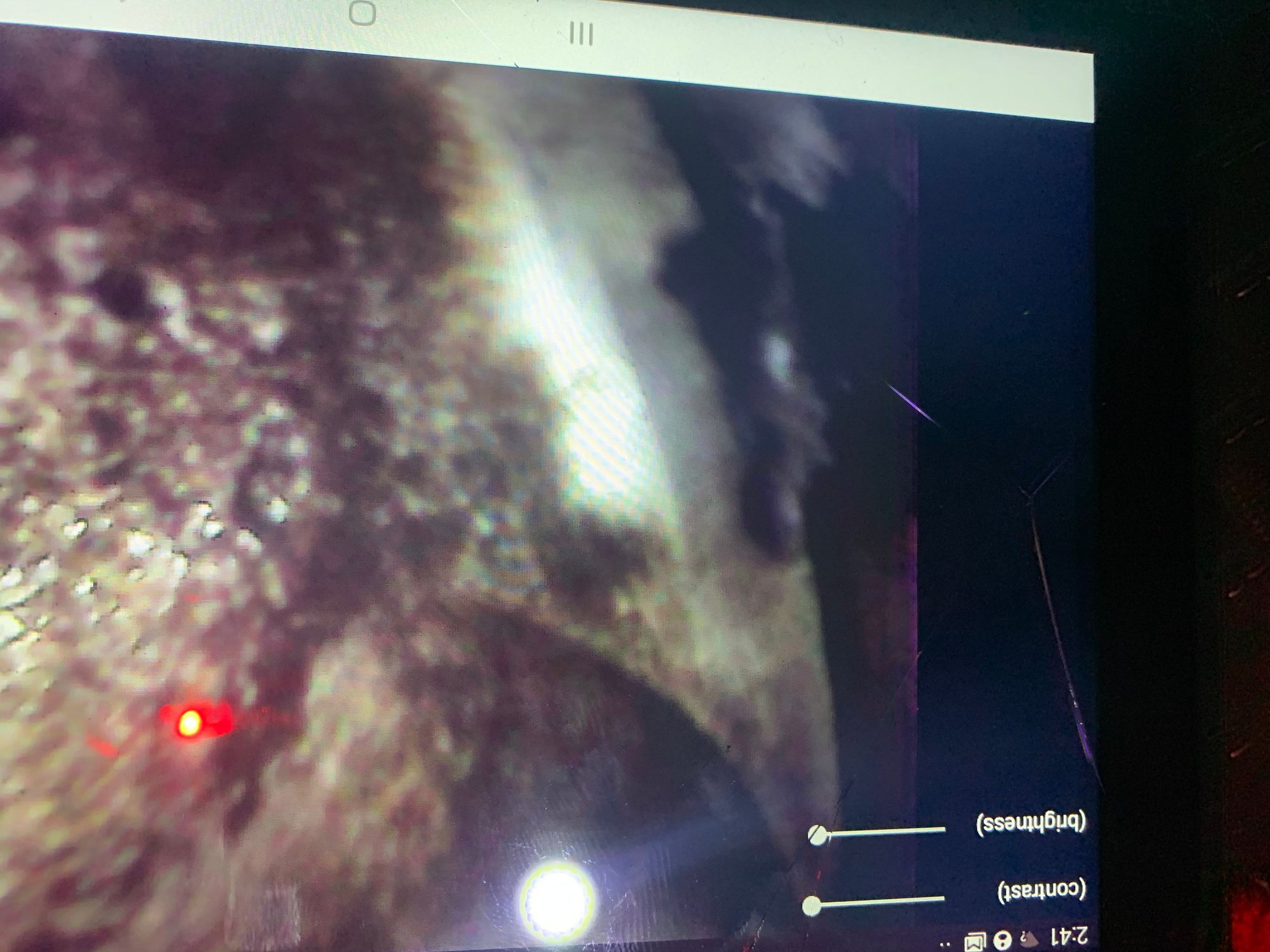

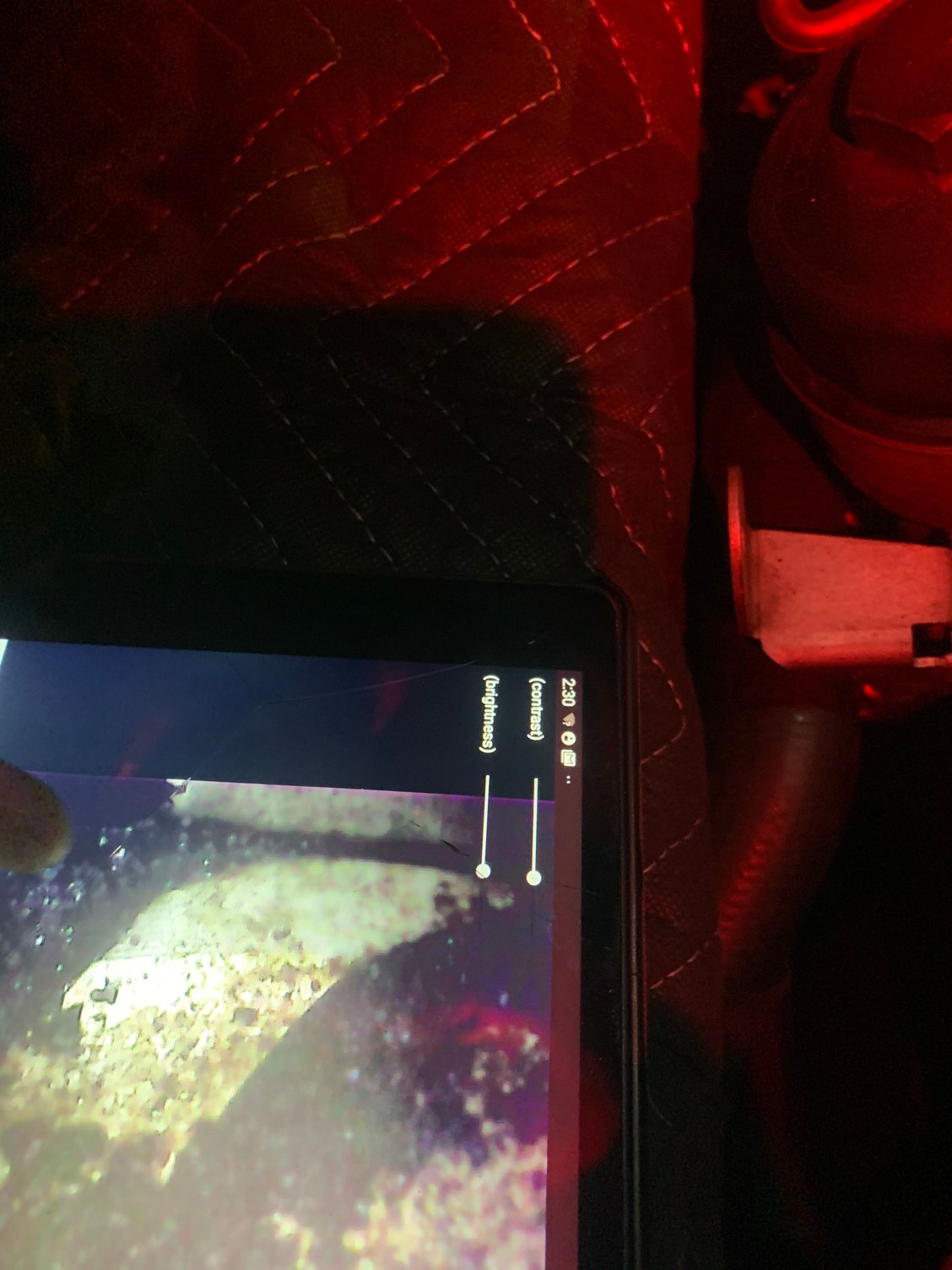

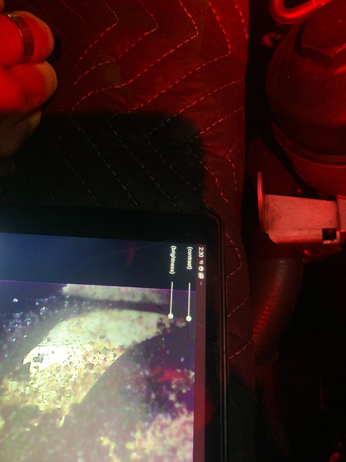

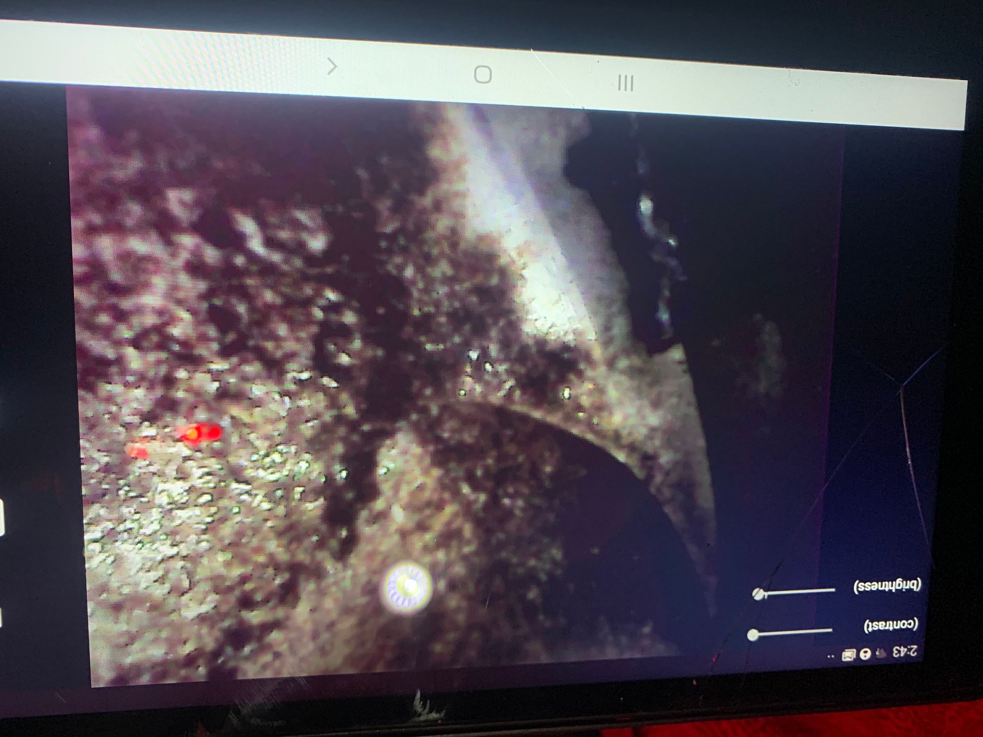

Here are some of cylinder heads w scope down spark plug hole. Engine turns over by hand and seems to be smooth and consistent. I’m going to spray seafoam down into cylinders and suck that **** out w a vaccine line as best as I can. Any other ideas more valuable input would be appreciated. Thanks
Cylinders not in order but I’m sure numbers 1-4.

So you're worried about a hydro-lock engine and you're going to dump fluid into the cylinders...
Yeah, you do you.
Pictures of the valve stems through the ports are all but meaningless. Valve damage doesn't come from hydro-lock, it comes from piston impact. That didn't happen.
If the engine seems smooth by hand, go ahead and crank it with the starter, leaving the plugs out, with no fuel being fed. Stop cranking with any clunk or bang noise. A bent conrod might not interfere with a slow turn, but its presence will be very evident when cranking.
Don't even think about worrying about cleaning the inside of the cylinders. That's what happens in there, and Seafoam isn't going to change anything.

1-4

Pictures of the pistons are irrelevant. Good job getting them, I guess, but useless information. Hydro-lock damage is not in the combustion chamber, it's in connecting rods and bearings. You need to look in the bottom of the engine, and to inspect bearings (main and rod) you have to take stuff apart.
It is apparent that you don't understand what has happened. PLEASE, find someone who does! You're chasing nothing that matters.
