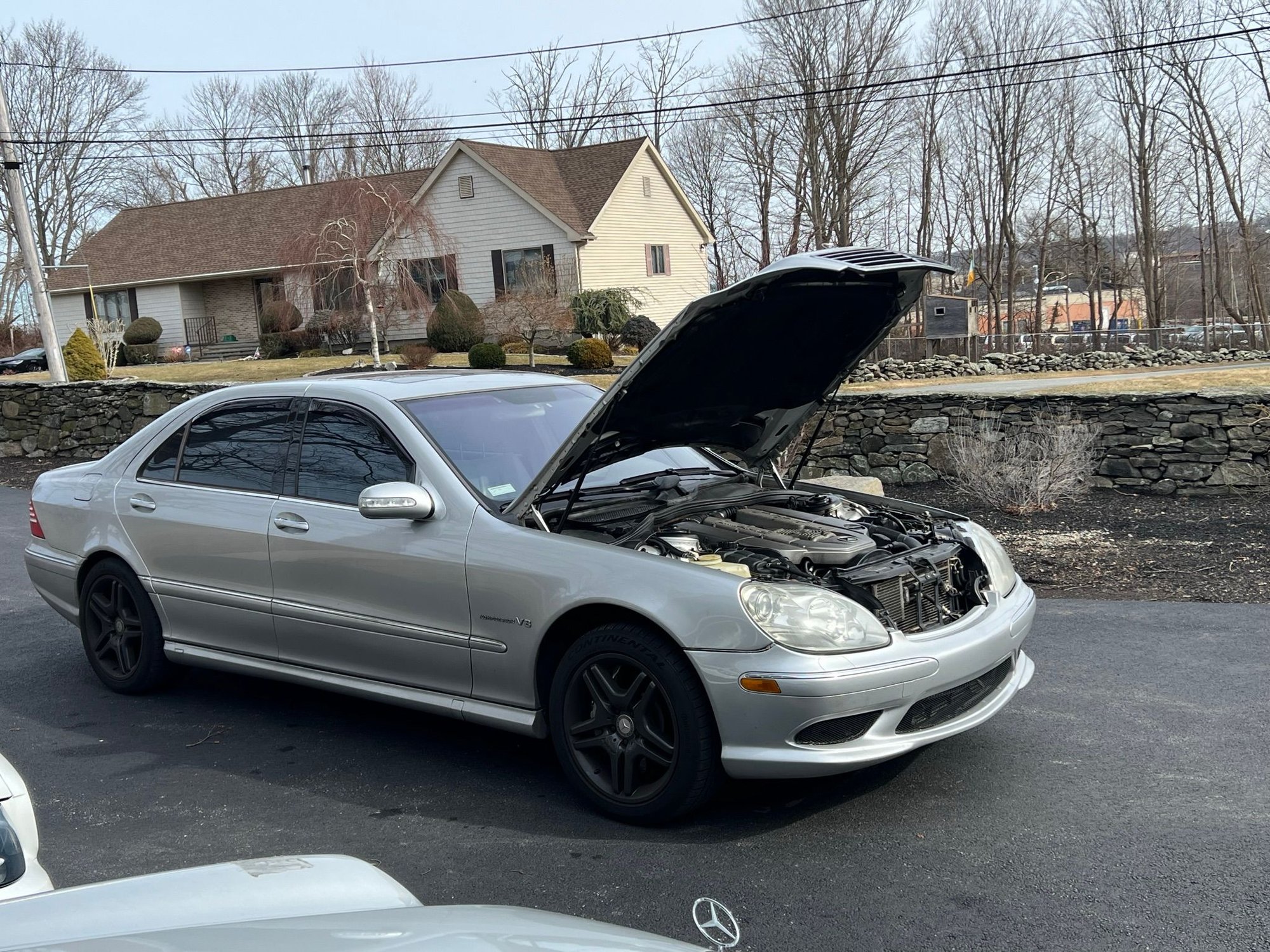

Just picked up my first W220 S55
She has 197k and needs lots of love. Looking forward to fixing her up and adding some mods.
Might also consider a nice set of wheels and some lowering links.
im open to any ideas on maintenance that should be done. I’m very familiar with the W210 but the w220
is new for me.
thanks

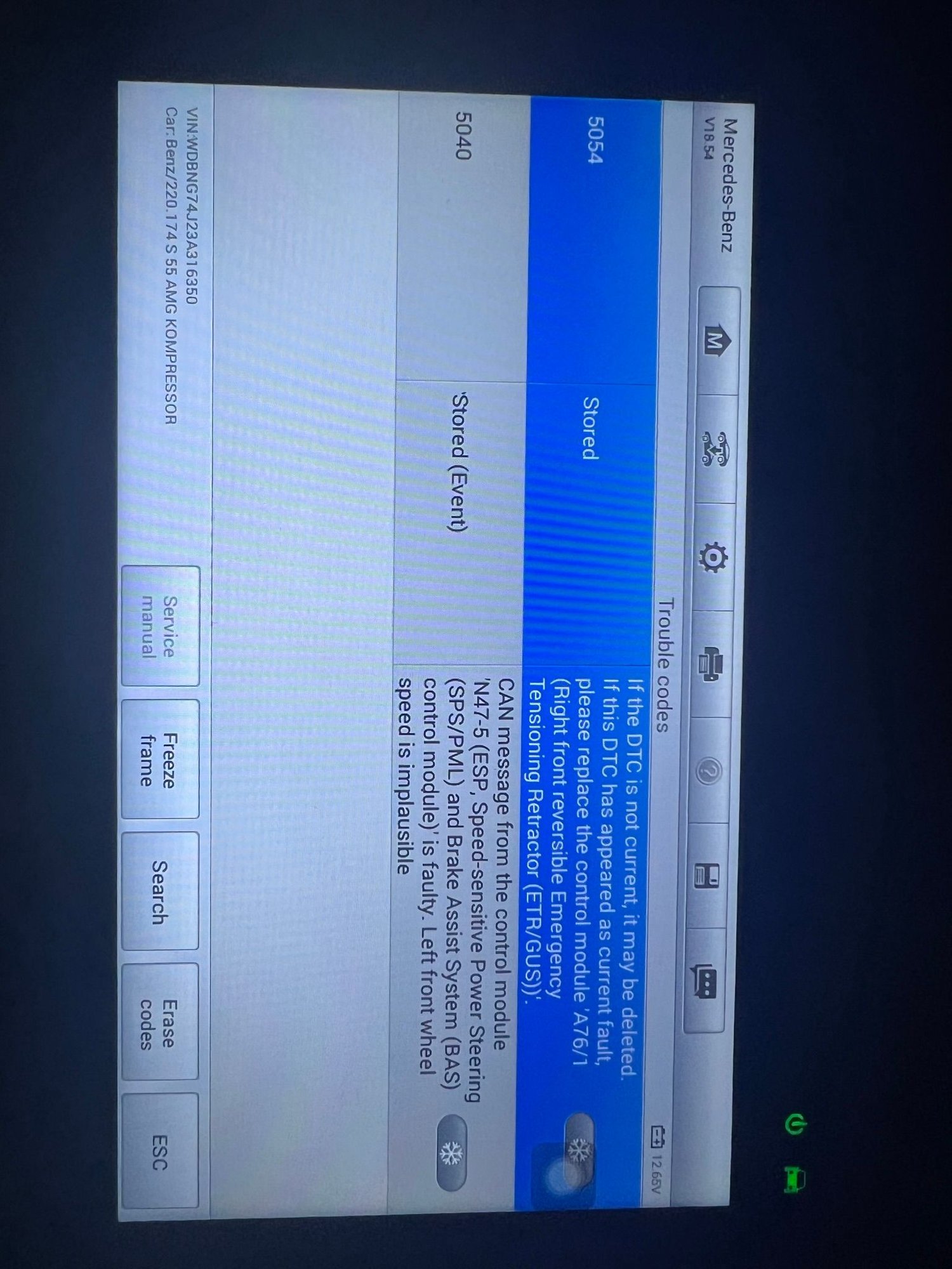

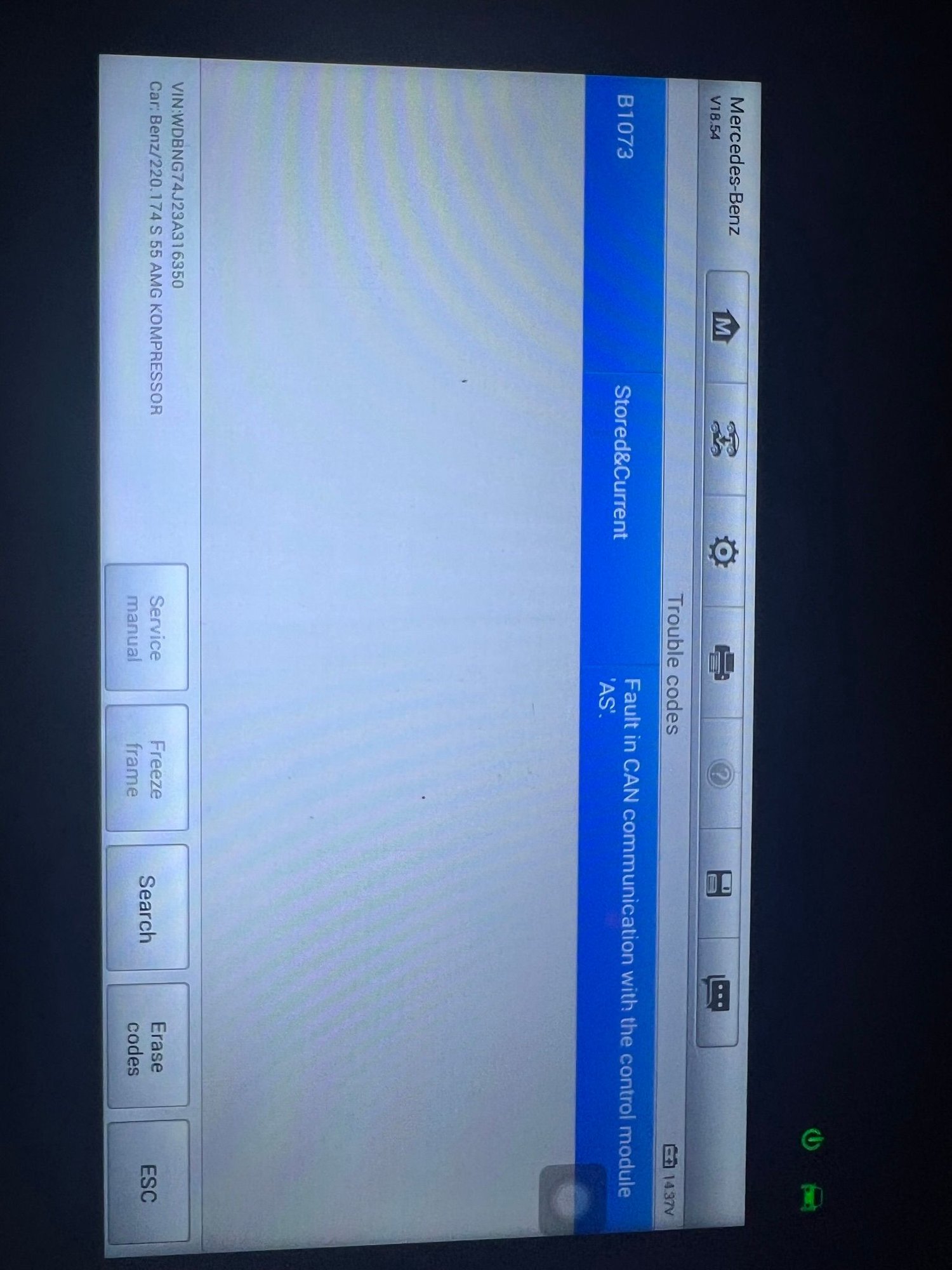

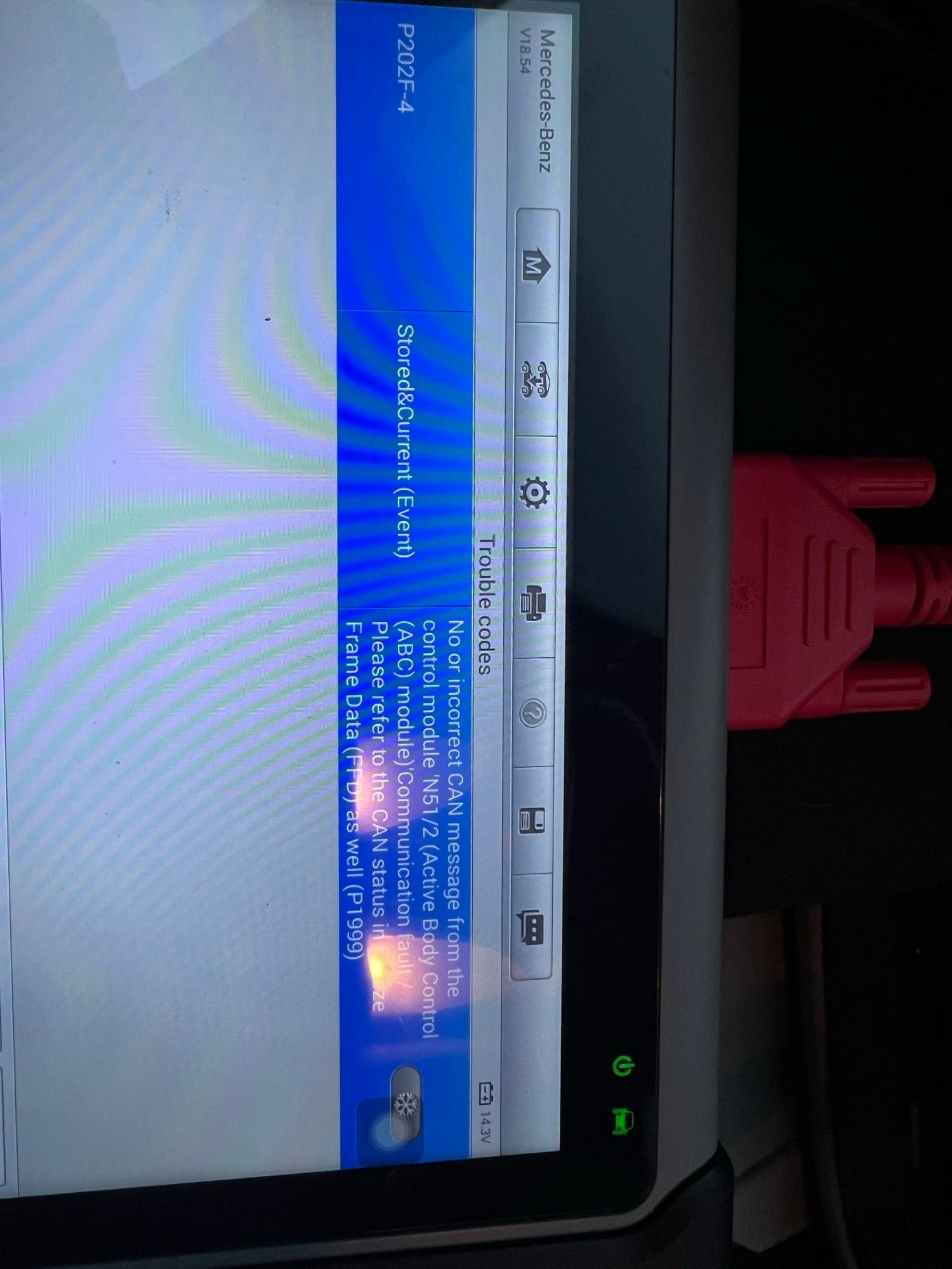

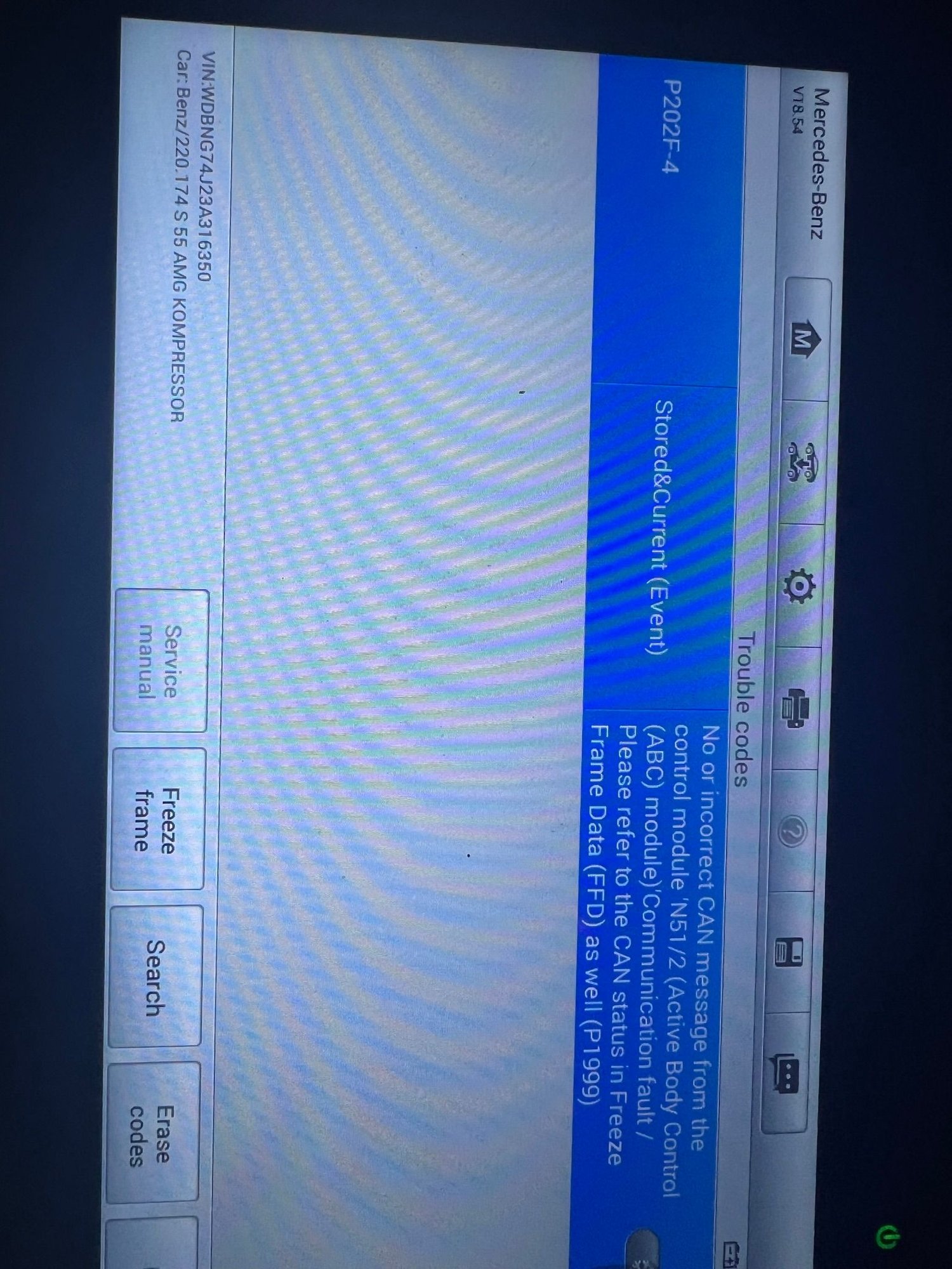

Got a chance to pull some codes. Any insight is always welcome. One thing I noticed is the car doesn’t change height with the dash button.
thanks
