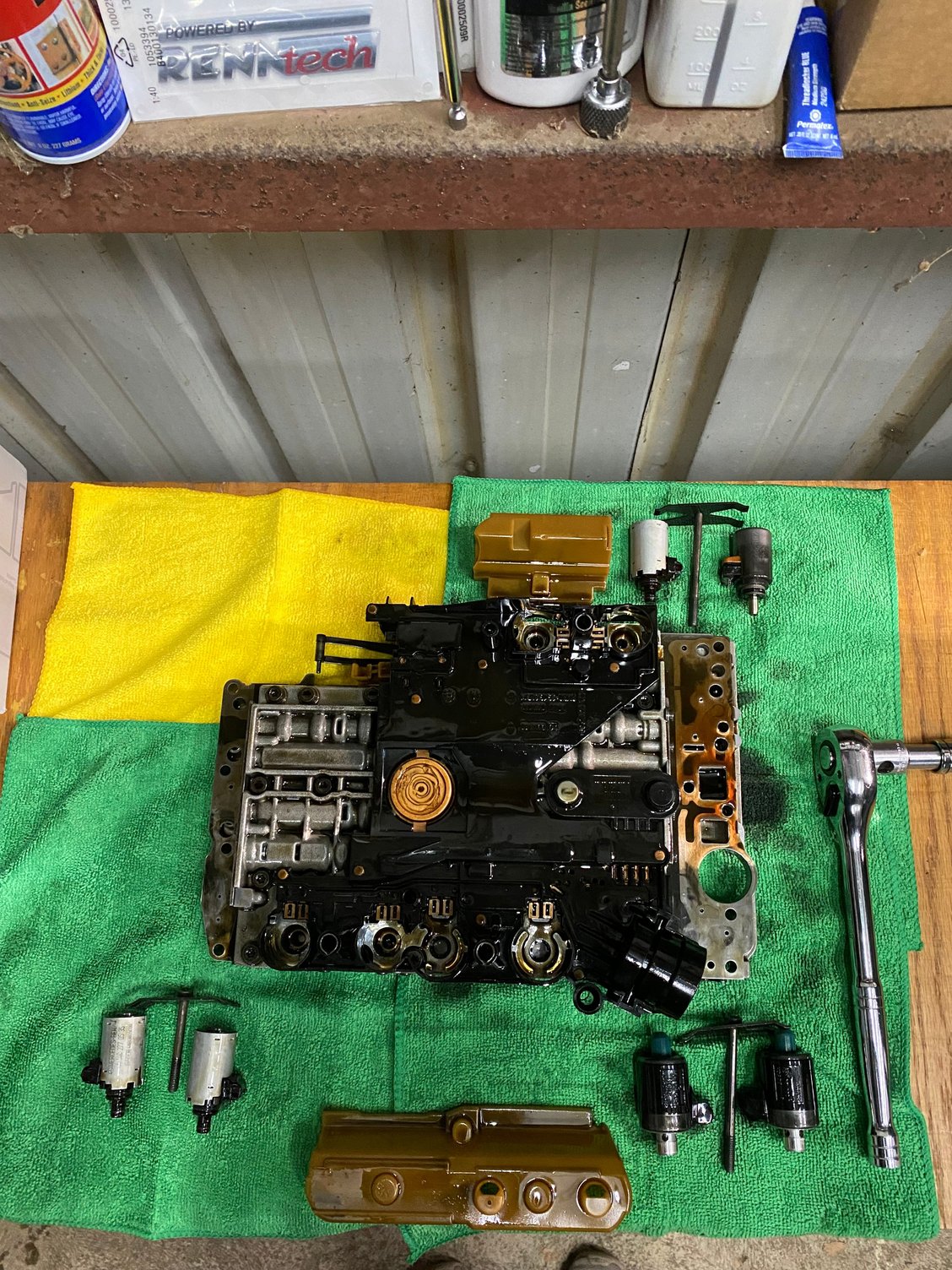

Mid-Winter update on the S55 thats just been hibernating.
The last few weeks on warm days i started tinkering and got a few things accomplished, while also trying to tackle more issues that have arisen.
Bottom oil cooler line was removed and taken to my hydraulic shop and repaired. Done. If i can find a factory line to replace it with later down the road i'll do so, however i won't have any issues with it for the foreseeable future as-is. Dealer was out of stock of the line i needed.

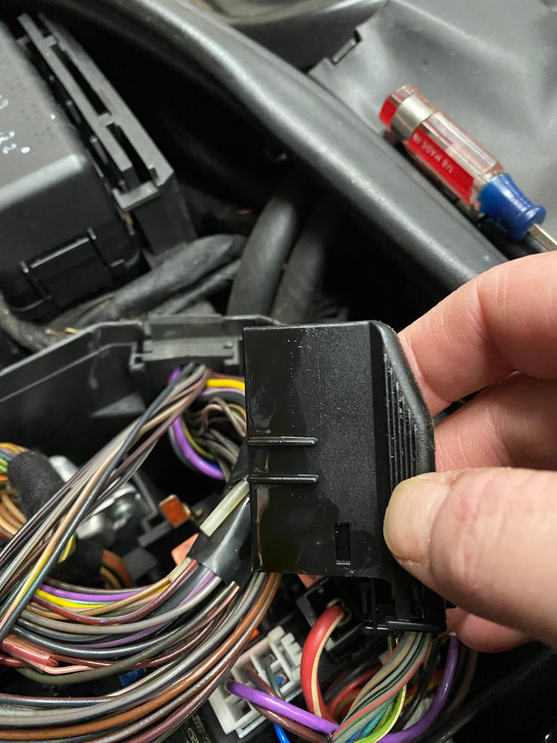

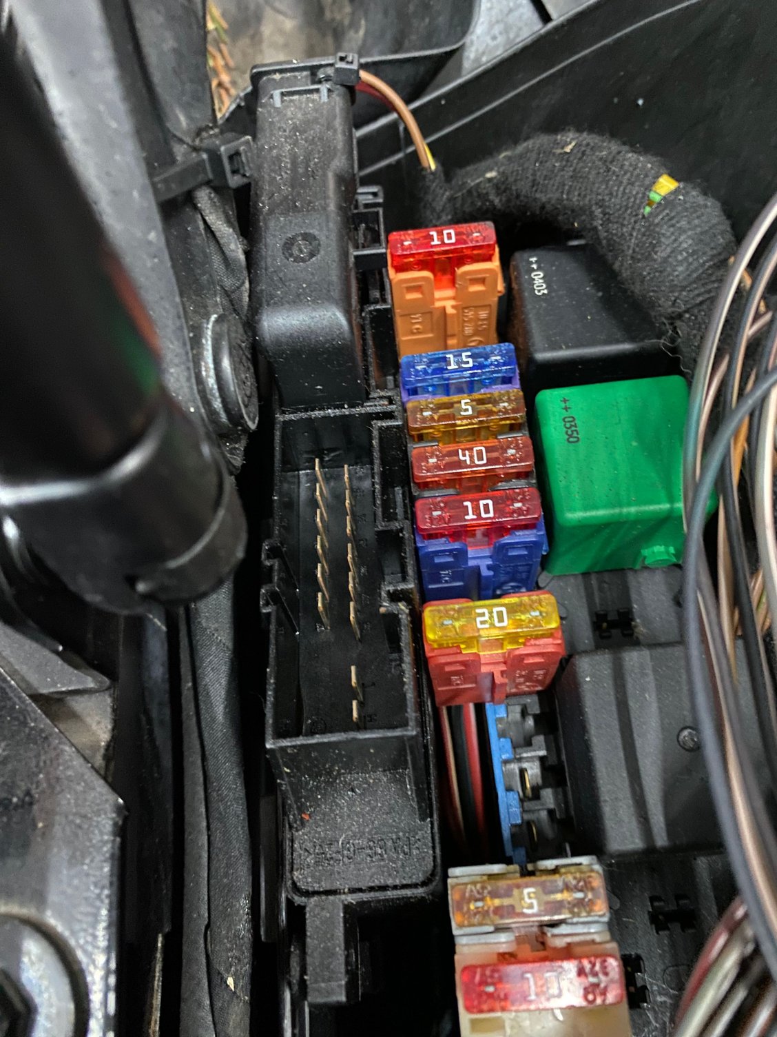

I'm still getting a flickering driver side headlight (which is driving me nuts). Removed headlight, replaced ballast, replaced HID bulb, repaired the failing wiring harness that has just disintegrated in my hand with liquid electrical tape best i could, re-installed and still flickering. I think the wiring harness deeper inside the headlight is arching due to the covering becoming brittle and wires are touching somewhere. Not sure what route to go, aftermarket headlights look brand new but i'm not sure about quality. OEM headlights on eBay are a good option, but am i going to run into the same issue with the harness disintegrating all over again?

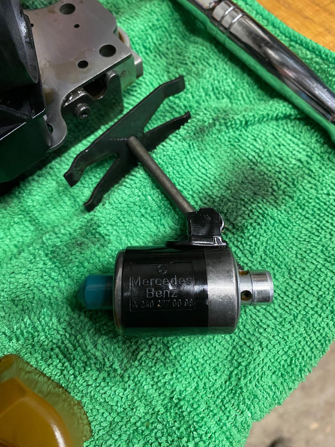

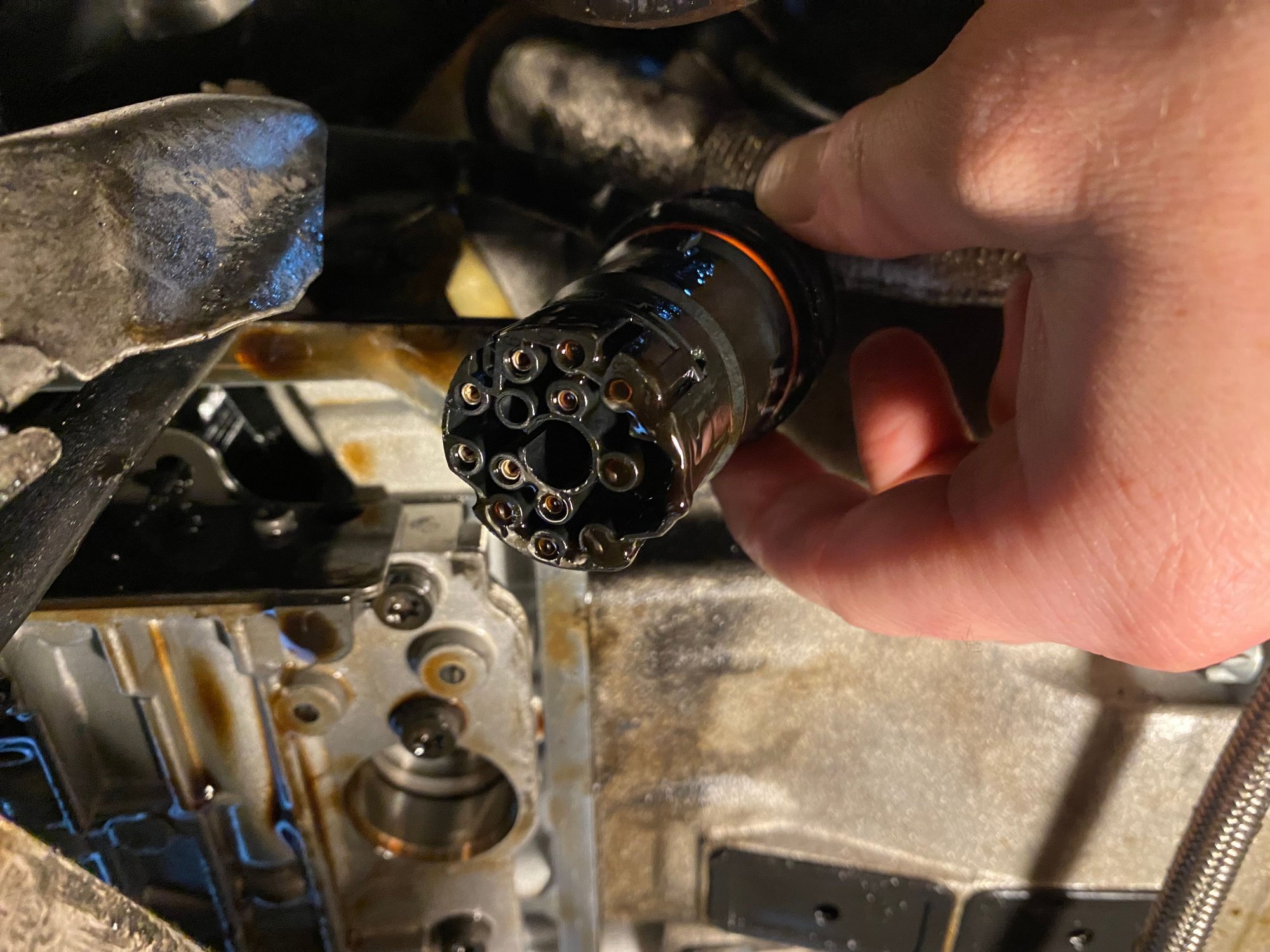

After the oil line blew and sprayed oil everywhere, the car has been locked into 2nd gear. There is no info on the dash that tells me what gear I'm in, and i can not shift into 1st, 3rd, 4th, 5th manually. Just 2nd. I'm also getting a P0600 code which is a "Serial Comm link" issue which tells me my TCU is not communicating with the rest of the car. I ordered a conductor plate rebuild kit through FCP Euro and installed it yesterday. (Not an easy job laying on your back with only jack stands, i would highly recommend a lift, or just bite the bullet and let your indy do it. probably wouldn't charge that much as its not a very difficult job, but a PITA without a lift) Bolted everything back up, filled it up with fresh trans fluid and still getting the same code and locked in 2nd gear. The 16 pin connector was covered in oil, and i'm thinking the wires have wicked the oil up into the TCU. I'll be heading back over in a few hours to pull the TCU out and see if i can clean up the connections with some electrical contact cleaner and see what happens.
I also bought (2) ABC Valve block rebuild kits which will get tackled here soon. Car is sagging more and more and i want that fixed. My last question regarding the ABC for the group is this...
Ive replaced everything in the front suspension other then the shocks. While doing upper control arms, i noticed that the leveling links may have been replaced at some point with adjustable links. Factory links from what I've seen are non adjustable. The car before the suspension work sat up high, which seemed like factory ride height. After doing all of the suspension work the car is sitting way lower on the highest setting then before. I put everything back exactly the same, including the links. Nothing was messed with as far as i'm aware. so my question is, how do i go about calibrating the suspension to get it back as close as possible to a factory ride height setting? If i do need to adjust the "Adjustable links", do i adjust them longer or shorter in the front, to raise the car? the rear seems fine for the most part, its only the front where I've noticed a significant drop.
I'll report back later on my findings with the TCU once i dig a little deeper.
Decent amount of oil on the plug
Does anyone know if these are in fact the updated "Blue Top" Shift solenoids from factory?
- Joe

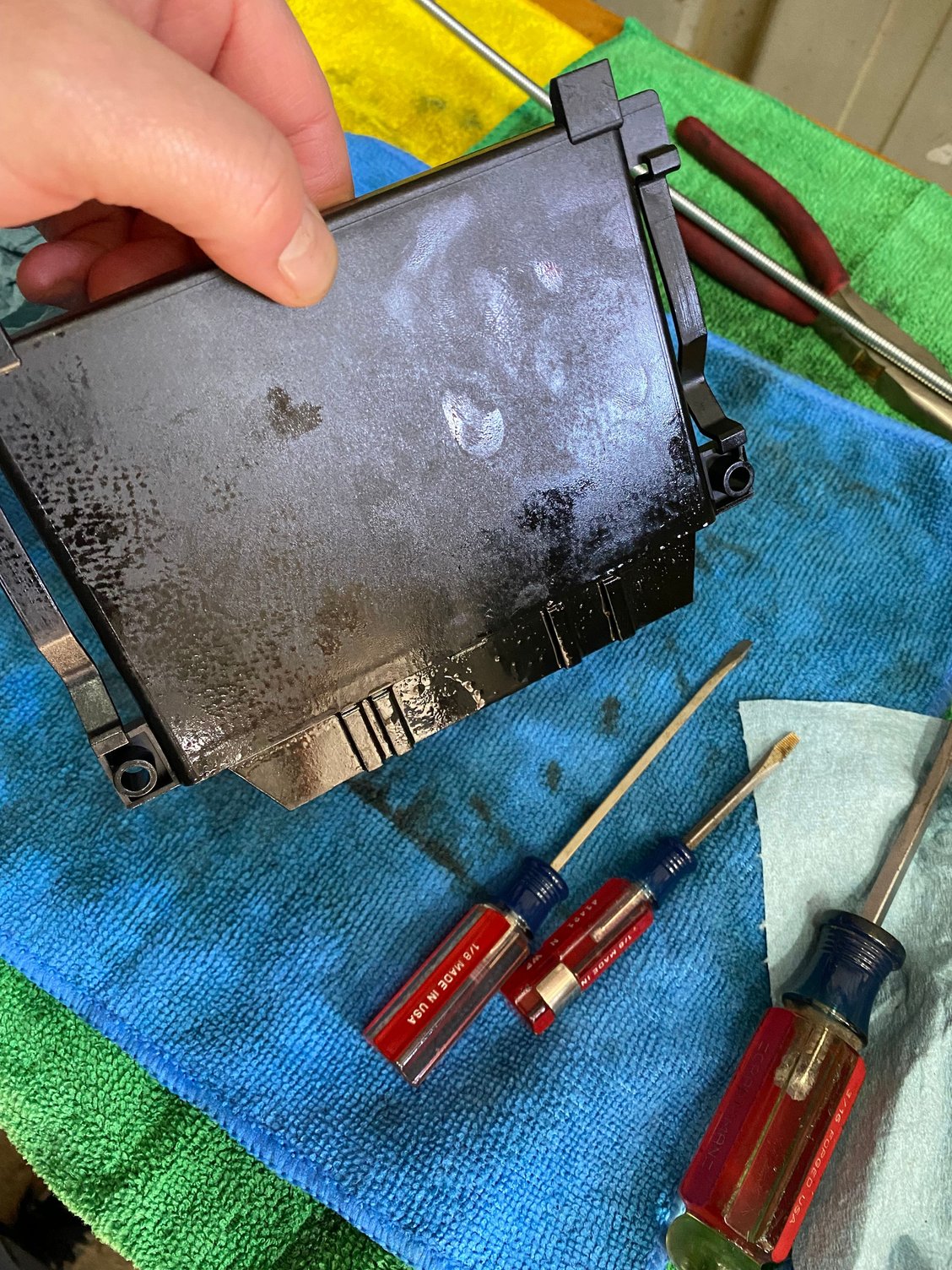

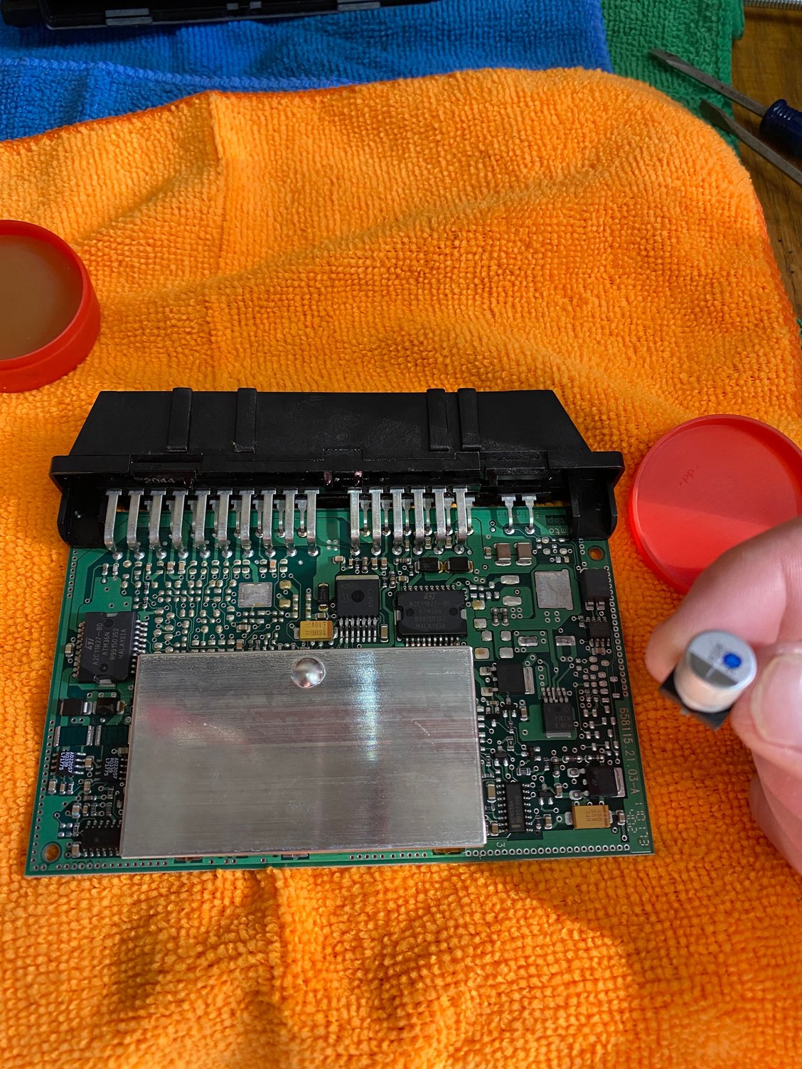

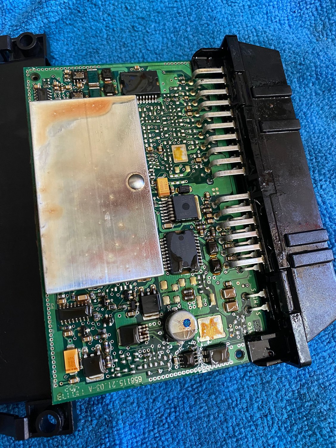

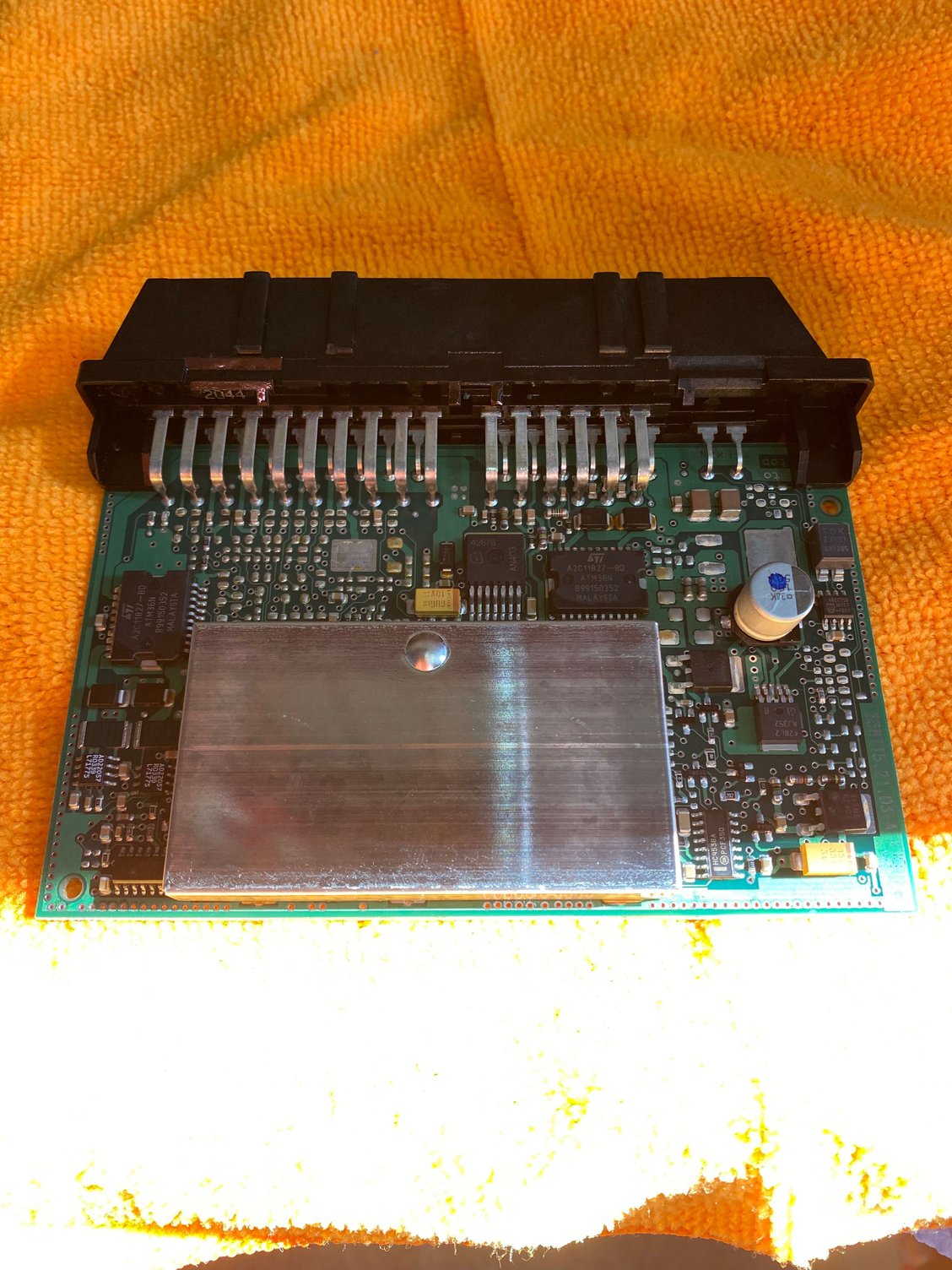

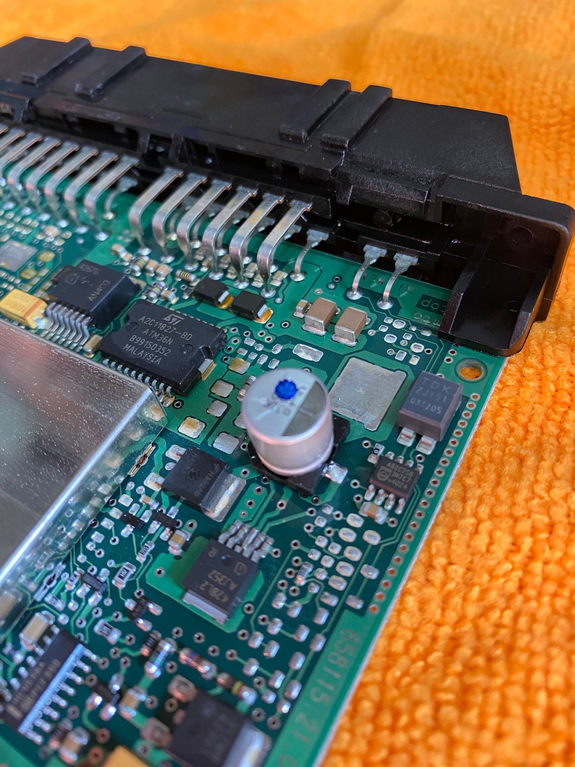

Joe, the trans fluid wicking is a common problem. It comes from a failed O-Ring at the plug. We tend to tell people to do that first, immediately upon acquiring the car. Not sure how that slipped here. But what that means is you probably need a new TCU and harness. The TCU's are cheap on the used market (try eBay Seller Autohubshop) but IDK about the harnesses. I got mine before the fluid wicked.
That said, draining and cleaning your current TCU with electrical cleaner and a bag of rice or microfiber rags to soak up the runoff is something that I've read about in this forum years ago. A good search might pull it all up. If it were me, I'd get another TCU while I work on mine. Knowing what you're doing on the car, maybe just get a tuned TCU now from mkultra (https://mkultraelectronics.com/produ...edes-benz-s55/). In fact, I probably would not spend any time on the old TCU. Life is too short.
As for the suspension, I'm one for 100% stock, so I can't help there.
I'd similarly just replace the headlamp (both of them actually, while I can), but I haven't thought about the harness. For some reason I feel like it comes with the headlight. Check with your local dealer on that.

Unfortunately that wicking harness issue has history within MB. It's reportedly the reason a lot of V12 owners back in the '90s would just leave the cars are the dealers and get another car rather than replace the computers. Please let us know what you find out.
Almost any TCU you buy off eBay will have fluid in it. Ask me how I know. It would be interesting to see how much drains out of your TCU. You should put it in a ziploc and set vertically so it can drain "for science".

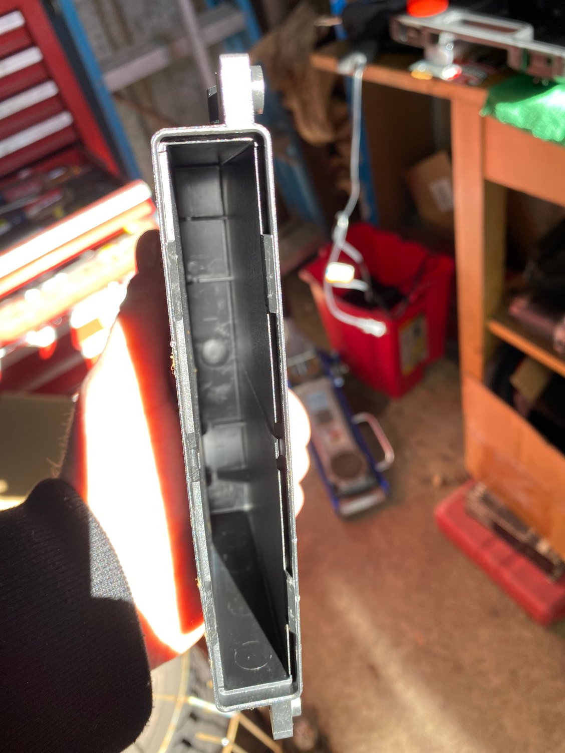

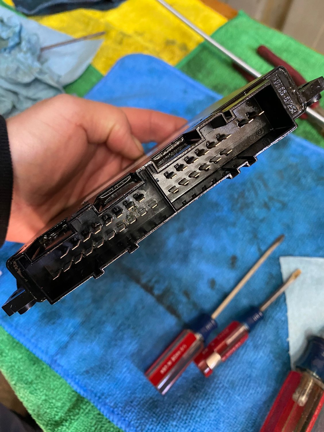

Well our fears have been confirmed. Decent amount of Trans fluid inside the TCU. I wasn't able to drain it into anything clear, but I would say a good amount of oil was inside. I disassembled, cleaned, and even re-soldered a piece that was broken off. No dice. Plugged it back in and still no info on the dash and locked in 2nd gear. It looks like I'm going to have to replace the harness if infact the interior is wicking up oil. I quickly checked online but doesn't look like any are for sale currently.
I'll buy a cheap TCU and plug it in and hope it works. If not it'll will probably be narrowed down to the harness, in which case i'll have to figure out how i'm going to tackle that.
Pics for reference...

Originally Posted by PHILLYCLSJOE
Just bought the "RennTech" TCU off of eBay.
Should be here this week, I'll plug it in and see what happens. Who knows, maybe ill get lucky.
- Joe
One can hope.
But the amount of fluid on the TCU side of that harness isn't giving me optimism.
That said, fluid in the harness might not mean anything except as it impacts the computer board itself. If that's the case, another TCU is just another soon to be fouled TCU.
Second gear is limp mode, so I wonder if there's some other transmission overload switch that needs triggering or replacing.
Fingers crossed.
maw
- Joe
If the TCU is coded to the VIN you just might.
Correct. What I found with RaceIQ Tcu that was included as an extra with a car that I bought is that the paddle shifters no longer worked in every mode. The shifts were very quick BUT very jarring. I could only imagine using sport mode on a track. I believe the shifter paddle is dependent on the year of the car. Mine was an 03 with full function paddles in every mode prior to the install.

I don't know what the break point is for this... probably has to do with blue top solenoids in the valve body... but I have a RaceIQ TCU and the paddles work in every mode EXACTLY as they did stock... but quicker shifts.
Mine is an '06 but IDK whether '04 had the blue top solenoids.
Let's see what what the RT TCU does for Joe.
I actually have a spare of some TCU, just not sure which at this point, RaceIQ or MKUltra. Both will be surplus soon as I think I'm going back to full stock everywhere.
maw
