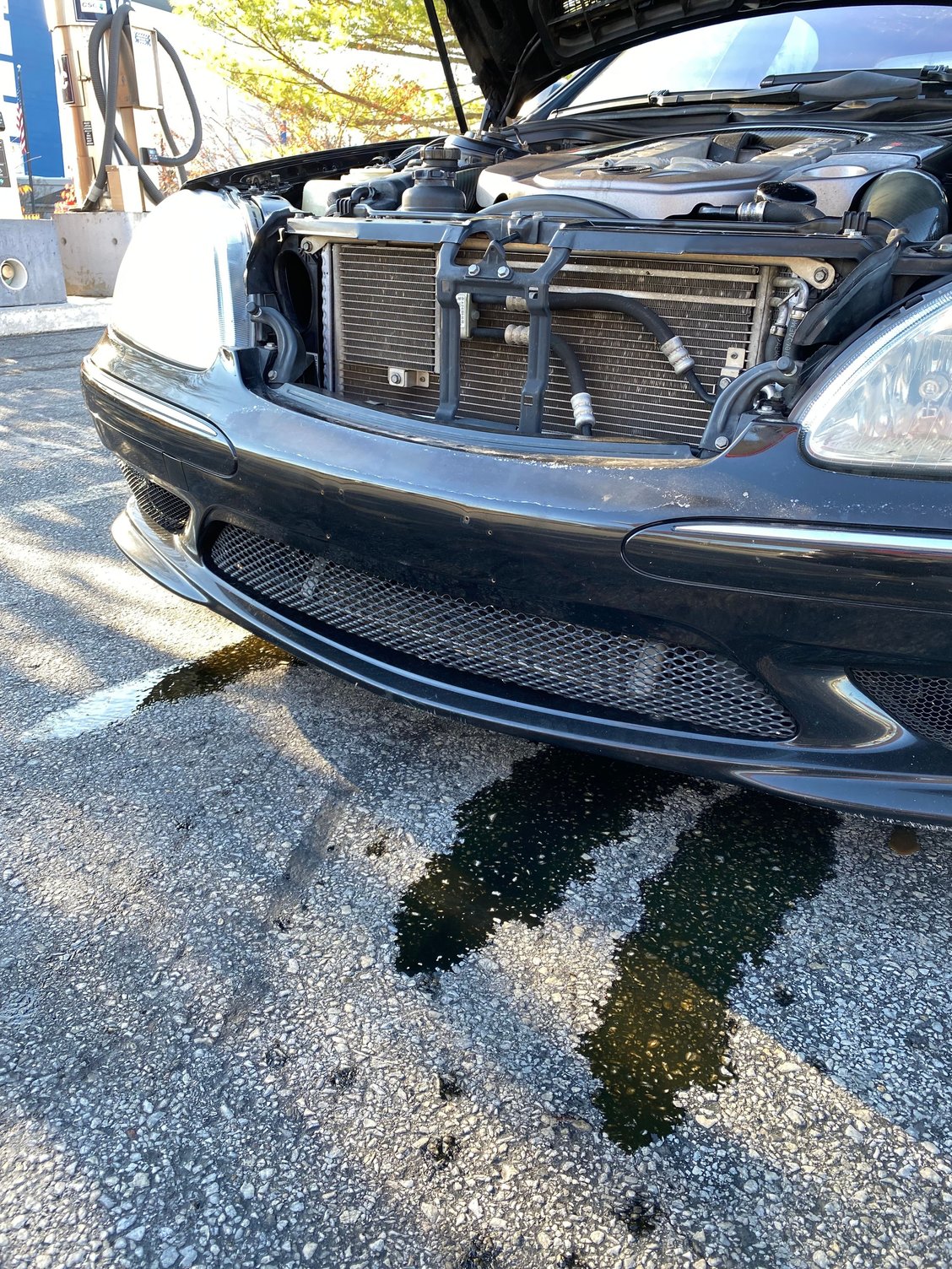

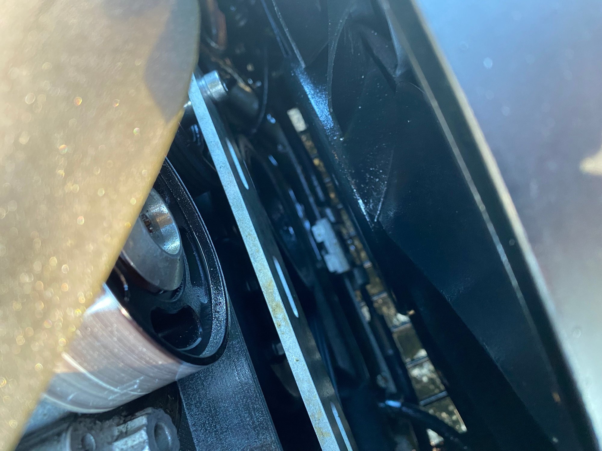

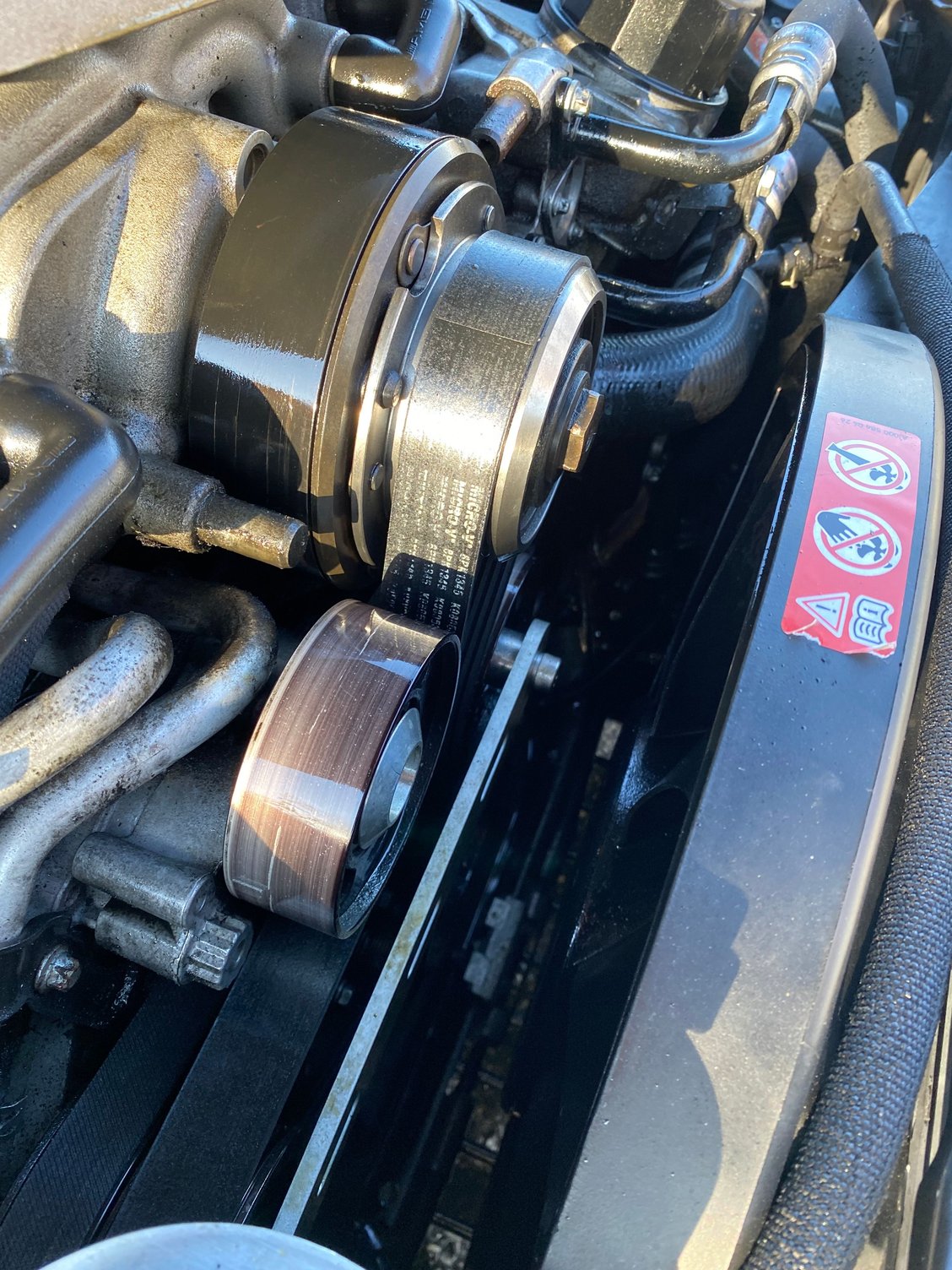

Starting to understand the fatigue most people feel with these cars. On my way to a dentist appt first thing this morning, on the highway and getting a really bad smell, look behind me and a cloud of smoke. Dash throws a white ABC light go to workshop. Luckily I was right by my exit, pull off, turn into a gas station and cut it off immediately. Steering started to get stiff.
pop the hood and there’s motor oil everywhere. Top of the engine, pouring out the bottom, all over the place. Waiting for a tow truck now to have it towed back to the shop. I pulled the dip stick and it’s about a quart low. Haven’t driven the car much at all. Small trips to the store and around town, but thats about it. This was the first “long drive” after the work was done, maybe 12-15 miles. Frustrating considering it just had an inspection completed last week.
i’ll know more later today when I can get it up in the air. No clue how I could have had both an ABC line, and massive amounts of oil pouring out of the engine at the same time.

Bummer! I'm almost certain that's all Pentosin, and the motor oil thing is a red herring. I've never used the dipstick to check oil on this car. Instead I just use the dash computer. Mine was leaking at the rear main seal until recently.
Incidentally. I was driving the other day and smelled Pentosin (because you learn to know what it smells like over the years) and when I got home there was some leakage. It was also all over the driver side strut tower and the pentosin reservoir in the engine bay. So I took it to my guys shop, power washed the engine bay and left it there. I need to check on it this week. Hopefully it's just a hose or some ****.
But the steering never got stiff and I only saw the light once in the next hour / 25 miles between when I smelled the fluid, drove it home, saw it was leaking and then drove it to my guy. So mine was a small leak. Yours is massive I hate to say.
We shall see. But I'm so far ahead on the car I can't see it bothering me too much. It's time for winter storage anyway. So I'm glad it didn't empty on the garage floor over the winter.

I feel for you brother! If you've already done you accumulators, my money is on one of the o-rings at the tandem pump, banjo fittings or a cracked pulsation damper. The motor oil spewing is an odd one though. The usual suspects for oil leaks would be any of the oil cooler/filter housing seals, timing port seal, breather covers, oil sending unit in the upper pan, and naturally the valve covers. I'm very particular about MB valve cover gaskets just for that reason. The way your pulleys are drenched I'm leaning towards oil cooler/filter housing seals or timing port seal. These cars will test your patience!
Mine needs a new PSE pump and I just don't want to spend money on it anymore. I don't think I've driven it 10 miles in the past 2 months.
maw
As I’m sitting here waiting and thinking, I’m starting to lean towards you being correct. It looked dark, like motor oil but it’s more than likely Pentosin, and was being sprayed/flung through the engine bay by the belts. (So much so it was coming through the star emblem on the engine cover and pouring down) Hopefully it’s a simple fix. Like I said I did an oil change not too long ago, checked the oil last week and it was full, but really hadn’t driven the car much. It’s possible it just needs a half/full quart of oil and there’s no issue with motor oil leaking.

Although I've done Valve cover gaskets which were definitely seeping, this seems to be a bit more. I'm going to clean everything up really well and keep an eye on it. Hopefully can narrow it down and figure out what needs attention next. All i can think of is front/rear main seal. Anything else in particular thats a common failure point that i should look out for?
I went back through your thread to see if there was mention of oil leaks leading up to your recent breakdown event. Although I somewhat agree with MAW about you possibly being mistaken that it could just be Pentosin everywhere, check your oil level switch on top of the upper oil pan. It's one of those things people tend to not think about being a leak path (although I highly doubt it would get to the top of the engine).
I have changed that on the M113 and M113K that I've owned because of significant oil leaks. The only thing that sucks is if it is leaking, you have to drop the lower pan to change it because it's bolted in from underneath. The worst part of the job is surface prep for the pan re-seal. There's also a "nub" (for lack of a better word to describe it) that's cast into the pan as a pry point.
Yeah, I think your other quart of oil was still in the engine when you checked it. That's why I just use the dash computer. That's all Pentosin on the floor Joe.
I just talked to my guys, who sprayed the car down and couldn't find the leak, which is more proof about how small it must have been. I probably didn't do myself any favors by driving the car over there, because that was at highway speed and they said the fluid was "everywhere." But we'll see how it goes.

Quick update:
Mechanic (also a very good friend of mine) called me right after i left the shop and said he started poking around, and that the bottom oil cooler line was split, and rubbing against the power steering pulley (Tandem pump I'm thinking). I wasn't going to start firing off questions. I said "Ok i'll be up tomorrow morning and we'll put a game plan together". Before i left the shop, I made it a point to tell him to hold off on moving the car until i run him up a bunch of Pentosin, lets fill the reservoir so we don't run the pump dry while pulling it into the shop. So now my wheels are turning and i started thinking. The bottom of the pan was wet from a week ago in which the mechanic said he cleaned it really well and to keep an eye on it. I'm thinking it was weeping this whole time, and it finally let loose. The oil i used was the Lugi-molly-gen High milage oil which is the same Green color as the Pentosin. So i think thats where the confusion has come into play. My only thinking as to why i got a White ABC light was because the pump was spraying so much oil all over the place that i was getting belt slip, the pump wasn't building pressure, and thats what triggered the light. Thats the only thing i can think of. When the tow truck finally showed up, i told him i wanted to pull the car onto the flat bed because it has to be cut off immediately. When i turned the car on and began to pull it up, i felt the suspension jump up in the air and pressurize. I said to myself thats odd, but it makes sense. I also lost power steering slightly for a minute when i was pulling into the gas station first thing this morning, and the only thing i can think of there is that there was so much oil that the belt was just slipping.
So thats where were at for now. I'll know more in the morning. I started looking around for a W220 oil cooler line and i cant find anything on any site. W211 Lines but nothing for a W220 AMG. I'll have to call around and see if i can source one.
As always thanks for the quick responses and brainstorming gents, at the least the community helps relieve some stress. You always think worse case scenario when these things pop up.
I'll report back.
- Joe

Oil cooler line rubbing against a pulley implies bad engine mounts.
Food for thought.

Yes, they definitely need to be replaced and are creeping up higher on the to-do-now list for sure
