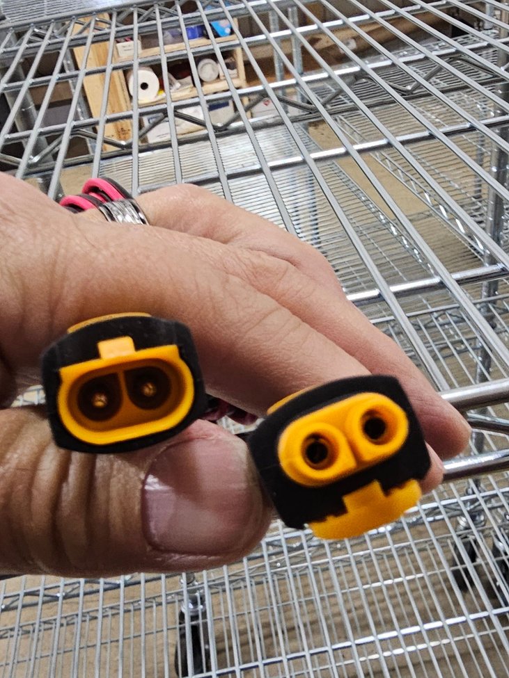

Marbenne, could you post up a pic of the inside of the plug connector, on the side that connects to the trickle charger? Trying to see if it'll mate up with the CTEK Lithium US charger I have: https://cimg8.ibsrv.net/gimg/www.mbw...2624b99f24.jpg

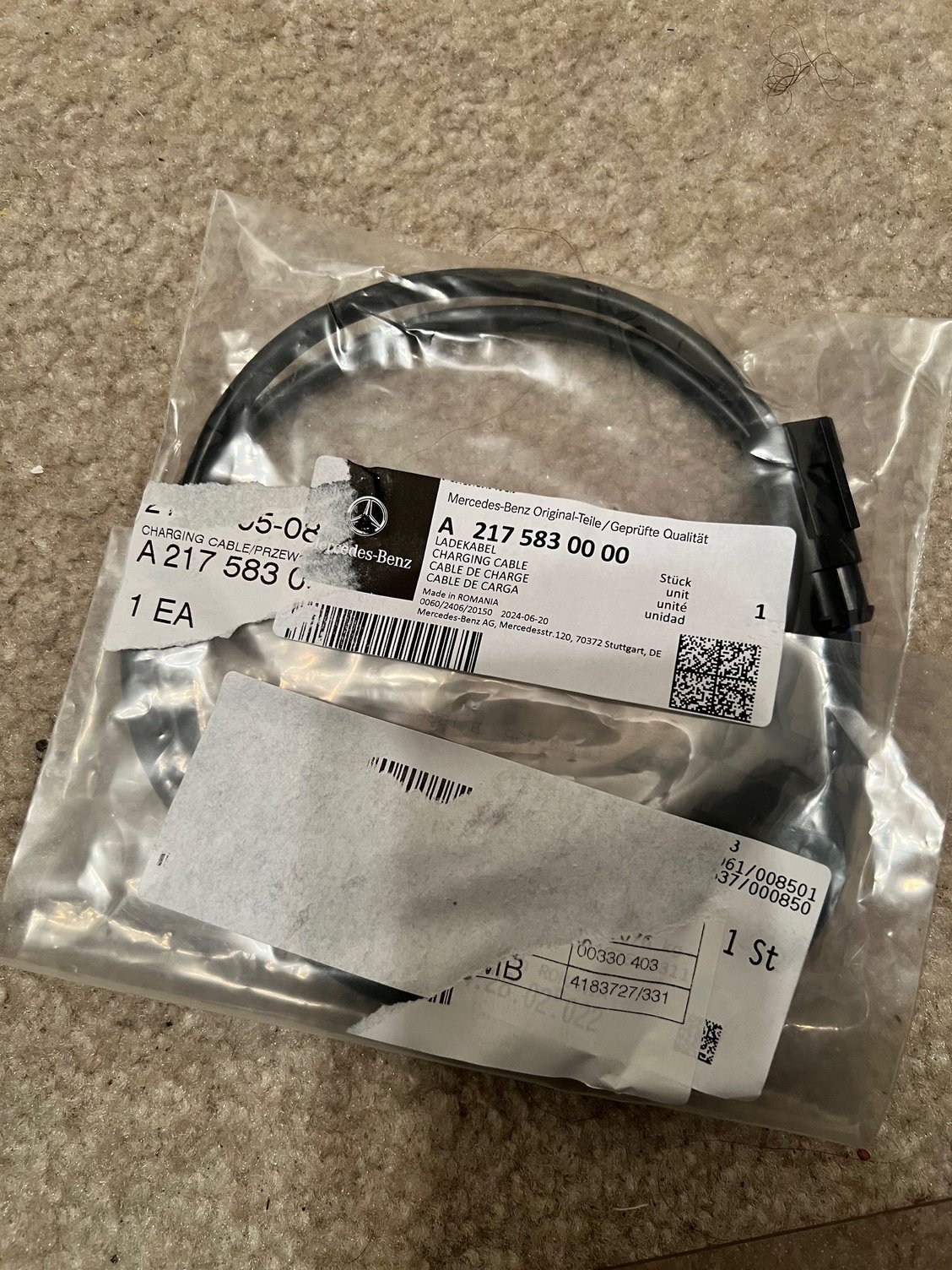

You need this cable to connect them:
Amazon Amazon

Old Nov 7, 2024 | 08:09 AM
BenzNinja's Avatar
Former Vendor
iTrader: (5)
Posts: 2,973
Likes: 955
Old Nov 7, 2024 | 08:46 AM

So I took a chance and ordered the cord to see if it would mate up to the CTEK charger I had purchased (Lithium US, Part #: 56-926), and it doesn't. It will likely only mate up with the MB-branded CTEK charger. So if anyone is interested in a brand new cord to use with an MB CTEK charger, I have a 100W% brand new unused cord for sale It sells for $60+ new + tax and shipping. Yours for $55 shipped within the US.
