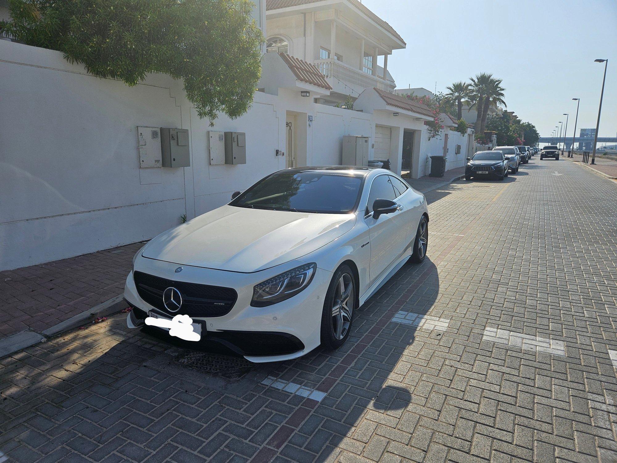

Pic attached for attention and recommendations re appearance(I'm open to a colour change or facelift along side a little optimisation on the above pains)
