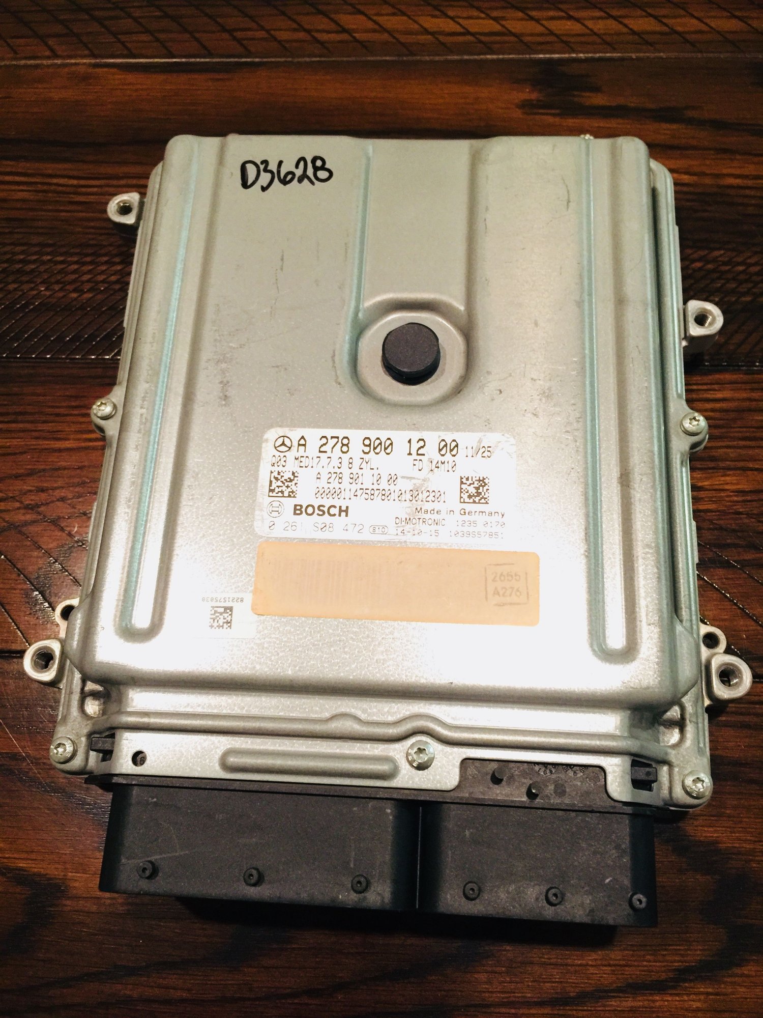

May I make a suggestion. If your going with a ECU upgrade to make your S63 faster ( more HP/TQ ), let that be separated from exhaust upgrades like exhaust tone/performance gain which is minimal ( max 20-25 hp ).
If your local ECU tuner said they make the ECU tune to also allow your exhaust to pop at over 4K, the ECU will need to be turn at a higher RPM curve at most time which would shorten the life span of your engine and drive train therefore I suggest you do the tune for the speed and exhaust upgrade like either downpipes or electronic valve control for the exhaust.
Either route you decide to go, you will need second ( additional ) ECU for your ECU tune so you can switch between your stock ( original ) ECU and the tuned ECU between dealer visits. You can read about it on the W212 E63 forum and most timers can clone your original ECU to your second ECU so you can have both ECU to run with. The switch between the ECU will take no more than 5 minutes ( I can provide instruction link if you like ). I have a extra ECU for sale that is from a W222 2016 S63 that you can verify with your ECU tuner of choice, but do not tune your original ECU as your warranty will get voided once the dealer hooks up your car with their system.
Here is the exact ECU I have for sale for $950:
I will need to talk more to the tuner regarding this and see what he has to say. Because I really don’t want to jeopardize the remainder of my warranty. As for the ecu, I think what you’re asking for is a tad bit too high? Only reason is because I’ve seen those go for much less? But anyways, I’ll keep updating this post.

The reason I suggested the second ECU is so that your warranty doesn’t get voided for the tune.
I am seriously thinking hard about trading my S63 for the MY19 W213 E63s wagon or a GTR so will not be using the second ECU I bought for the exact purpose. If you do go with the same route with the second ECU, make sure it’s for a newer model W222 S class. I seeing eBay who are selling more than $1,000 for a 2010-2014 S class ECU. Many sure with your tuner the second ECU compatible with your W222 S63. PS. I purchased the offered second ECU for $900 without shipping and I’m basically offering it at the price I purchased it for.
